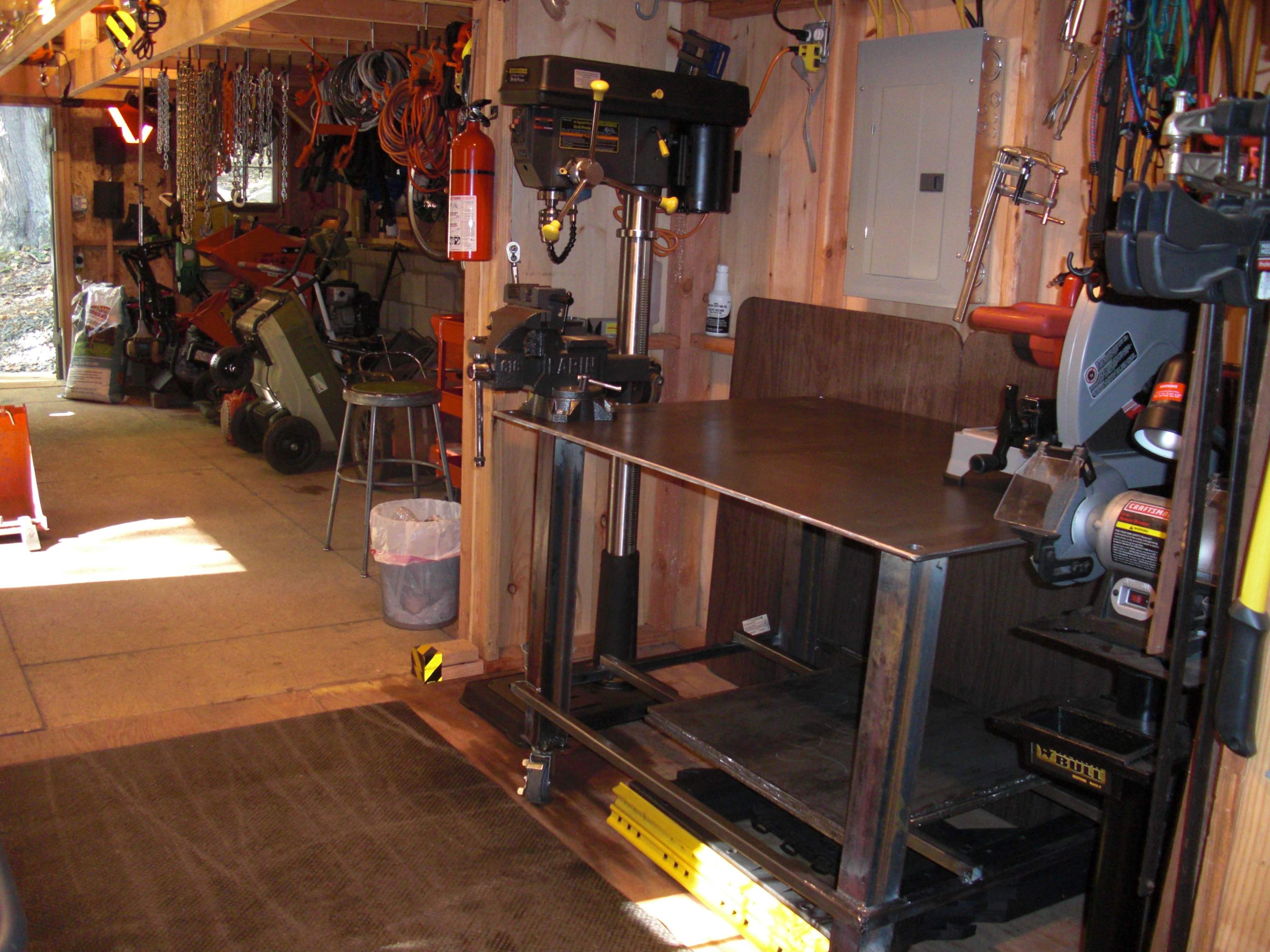

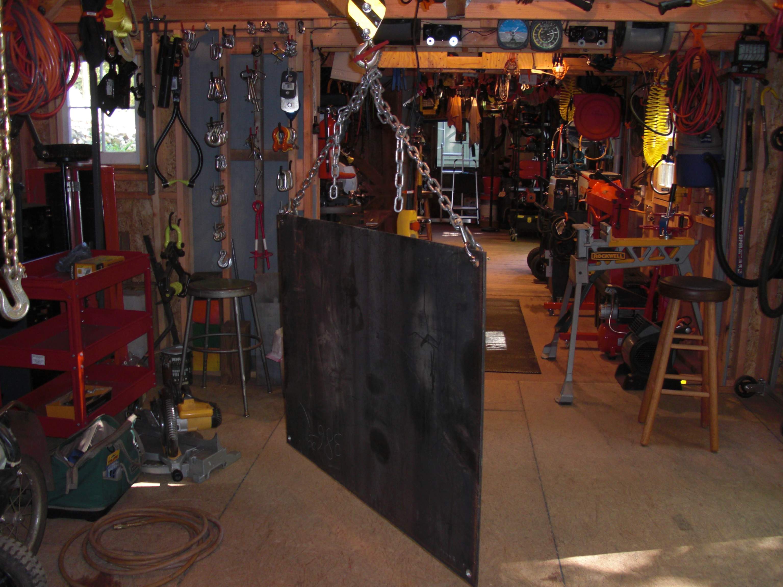

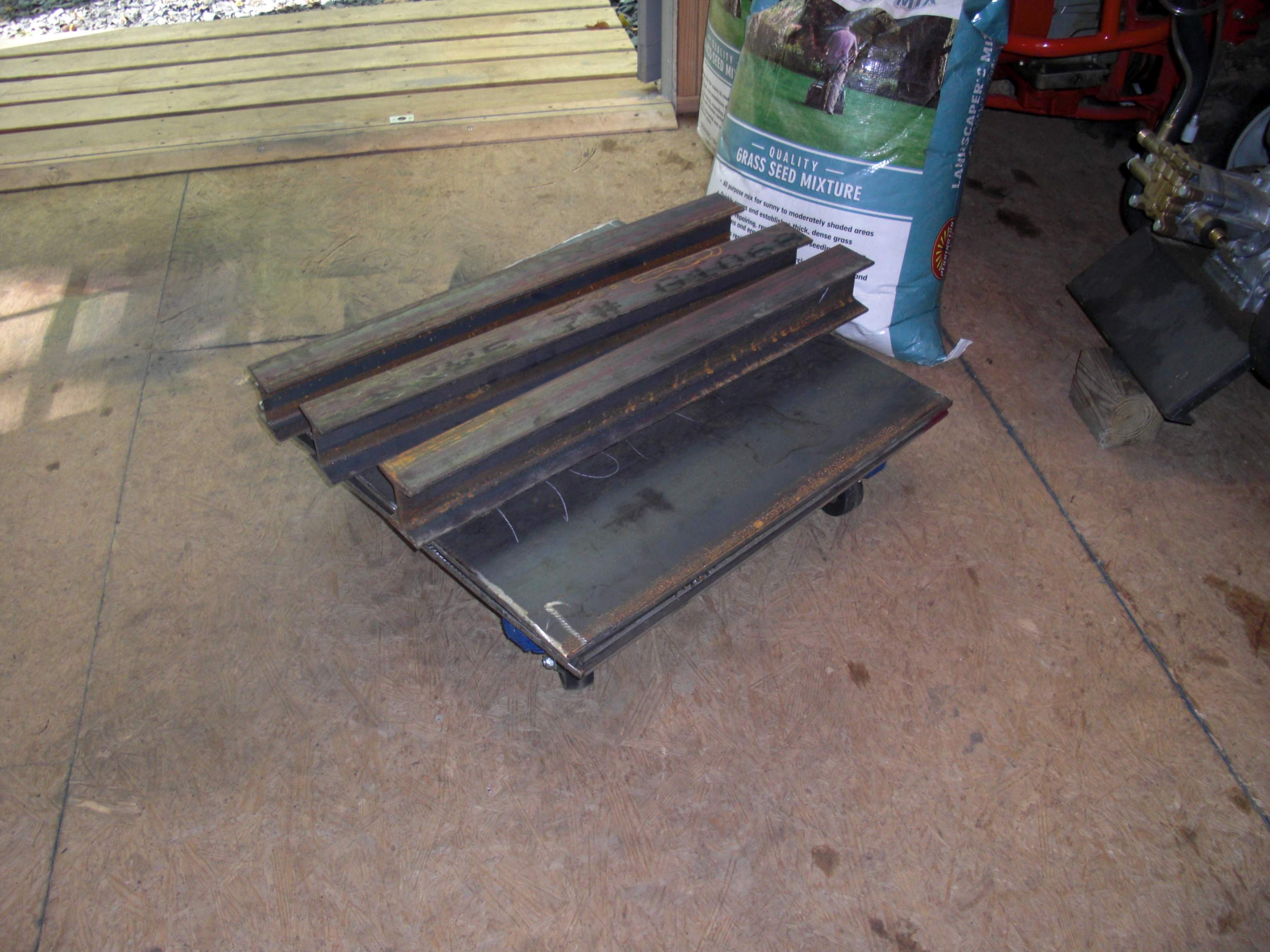

Not wanting to chance having the legs fold over on me, I used 3 inch i-beam for legs when I built my table......28 inch lengths....the "i" shape made for a lot of contact length for welding them to the underside of the table.......but first I welded small 1/4" square plate on bottom of each leg, pre-drilled with holes in the plates for casters, and then bolted on 4" wheel casters. Legs are really strong.....square tube cross-bracing near bottom to add rigidity.
Top is 3/8", 36x48.....I had 1" holes drilled in each corner for hoisting, handling, etc. My welding isn't pretty for sure, but it all holds nice & tight.
Built it for welding, but have only used it as a work table so far. Wheels make it easy to roll where I need it, and the casters lock to hold table in place, although if I really needed it to stay firmly put, I'd have to anchor it better.
If nothing else, the thing will help keep the floor from blowing away on a windy day......it's heavy, for its size.
