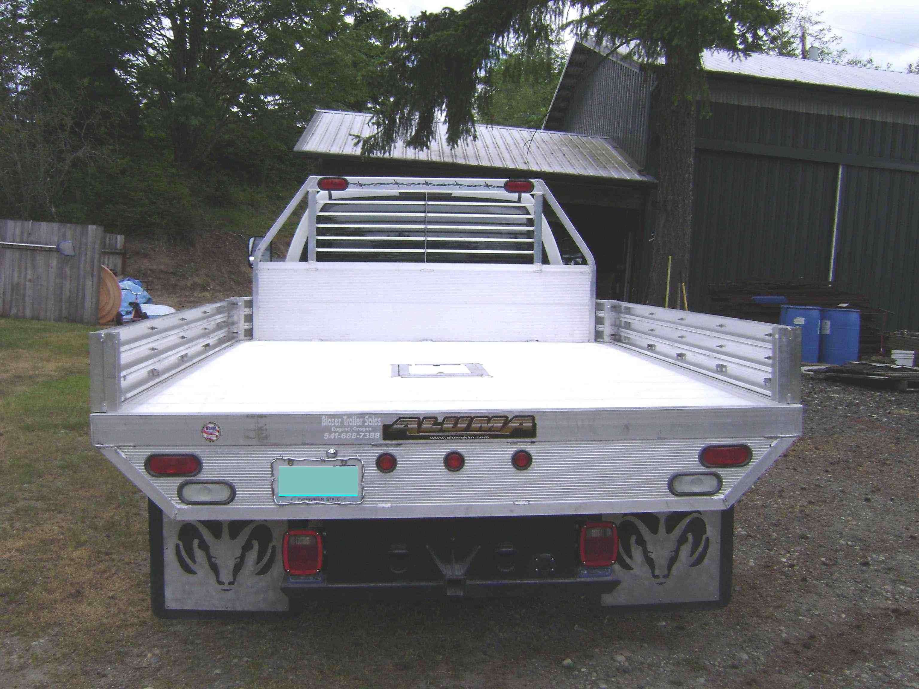

Only reason I'm curious about high frequency on a vehicle, I have an aluminum flatbed on my 2007 truck. So far I have not damaged it, but it is a matter of time!:eek: Also been thinking of ways to build a lumber rack for it, but haven't come up with a design yet. I can always take the bed off, but that would be a lot of work, truly would be the safest way to go.
