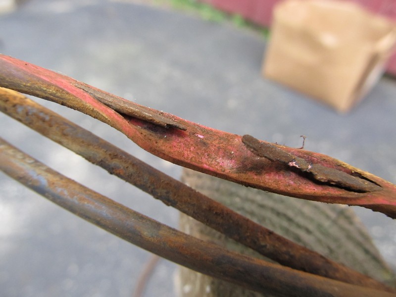

My well pump quit working last spring. I was able to figure out what was going on with a clamp on ammeter and an ohmmeter, but had a well company pull everything up and replace the wire. The wire had worn from the torquing of the pump when it started and rubbing the wire against the well casing. And I do have torque arrestors. Pump is down about 240'. He charged about $330 for the pull and repair. I think he said a 3/4hp pump would have been about $500 on top of the repair.
