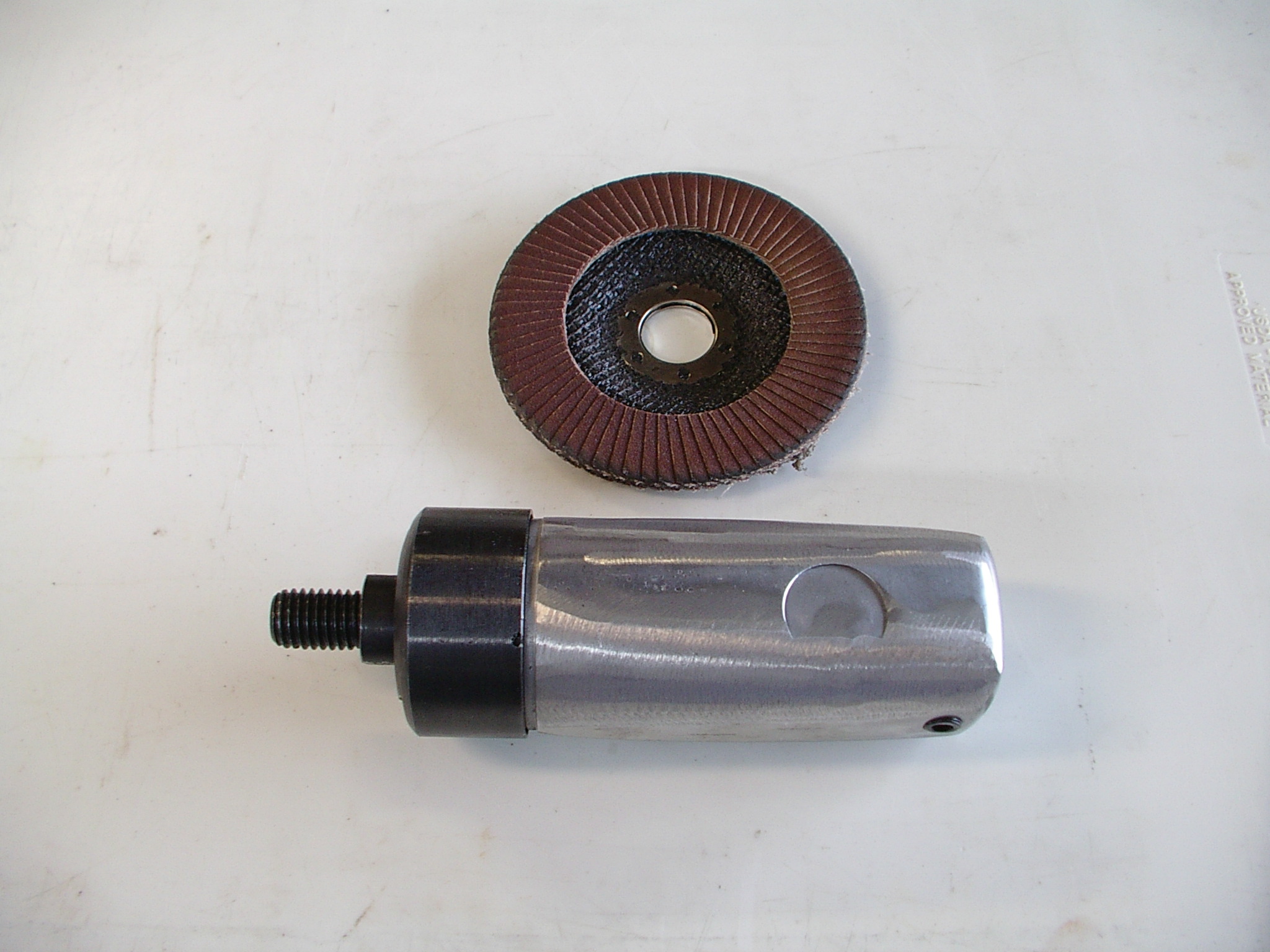

Here is a company on E-Bay that sells plans for a PTO driven well digger. The other place mentioned earlier in east Texas is "How to drill a well.com" The fellows name is Nathaniel. He uses a circular air sander sold at HF that has been modified to fit inside of a 2" PVC pipe. His idea is very clever in theory. There are 3 holes drilled in the pvc near the head that create a vacuum from the air exhaust and carry the tailings up through a 1" pvc 100 - 150' run. Water is kept in the hole to help carry. This is a picture of the motor I built to his specs. A winged drill bit is screwed on to the threaded end. I have everything ready to go but have not tried it yet. I have an IR trailer air compressor to run it. You need a lot of air to pump the tailings up through that length of pipe. He sells everything on his site or you can just buy the plans and DVD showing how to build and drill.
