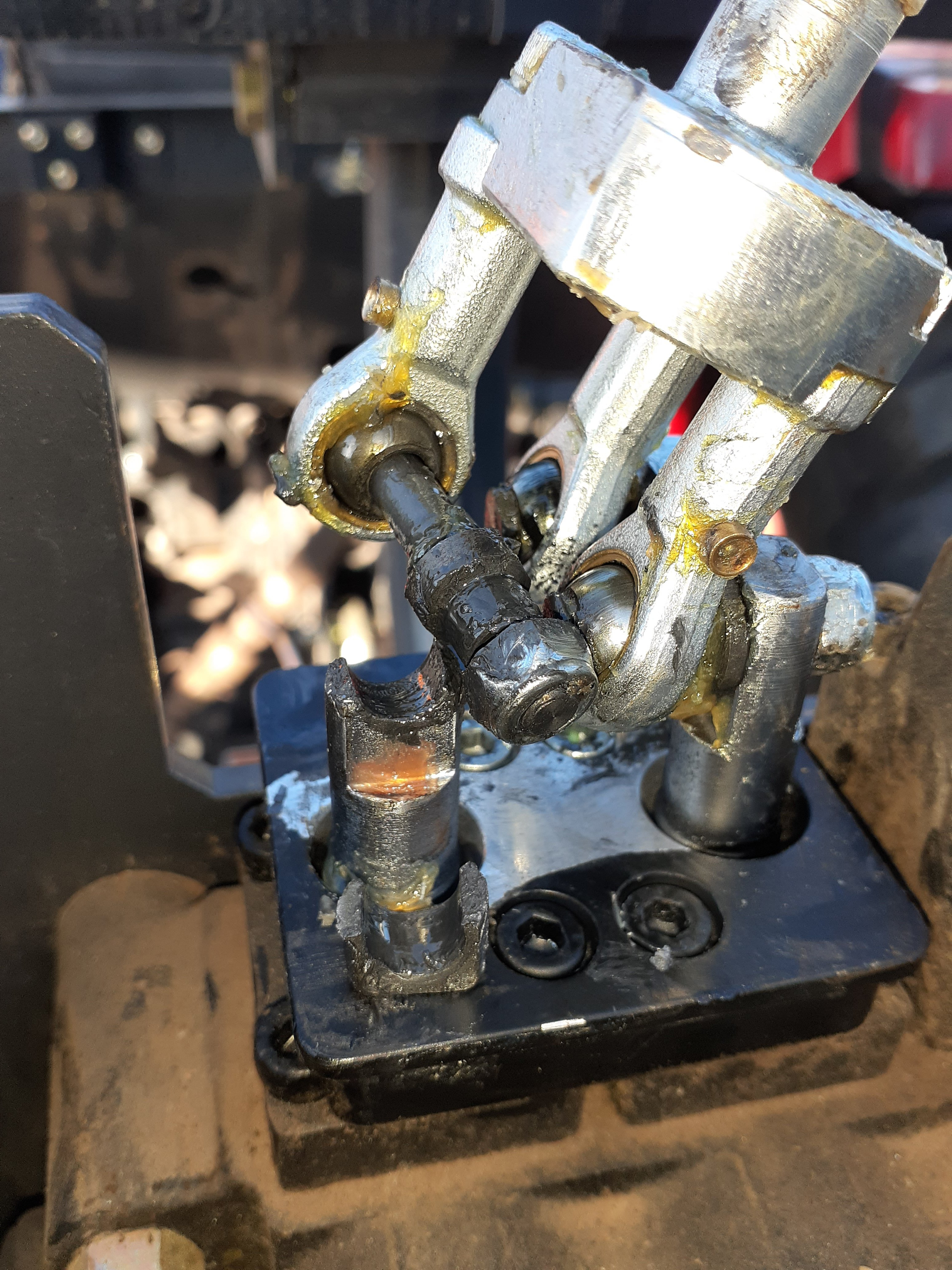

Was out again today digging tree holes when suddenly the back hoe curl function went limp. I have re-sealed section valves before so I just thought the pin can loose and worked it's way out. So, I removed the cover over the valve assembly, unscrewed the handle and pulled off the rubber boot. Much to my dismay, the top section of the spool had snapped off!! Just crazy.
I have already contacted my dealer but it's late on a Saturday so I prolly won't hear anything until next week. Just a bummer because I was hoping to get a lot more work done this weekend. I have attached a pic. B

That is crazy. At first I thought the spool was what broke. Hopefully your dealer can help you get back going.

Unfortunately, I have a feeling that they won't sell you just the single spool.
You may try to search the manufacturer of the valve and try going that way, otherwise, I see a new valve in your future.

I bet you won't be able to get just the spool, if not, why not get the ears welded back on?........Mike

Hopefully. If not, I believe the manufacturer is Walvoil, and the valves are available separately. Someone here added a valve to the middle of the stack to run a thumb.
