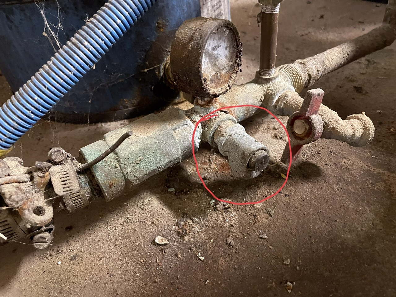

Our well system uses a submersible pump. I need to replace the pressure switch, because it is not turning on until system pressure is near zero. While the system is depressurized, I‘ll also replace the gauge, putting a valve between it and the system to facilitate future replacements. But I don’t recognize the device I‘ve circled in red. It is weeping occasionally, and I wonder if it’s actually necessary, and if I can just put a pipe plug in its place.
/ Well plumbing Device? #2
A bit hard to see but looks like a pressure relief valve to me. Good to have in the system.

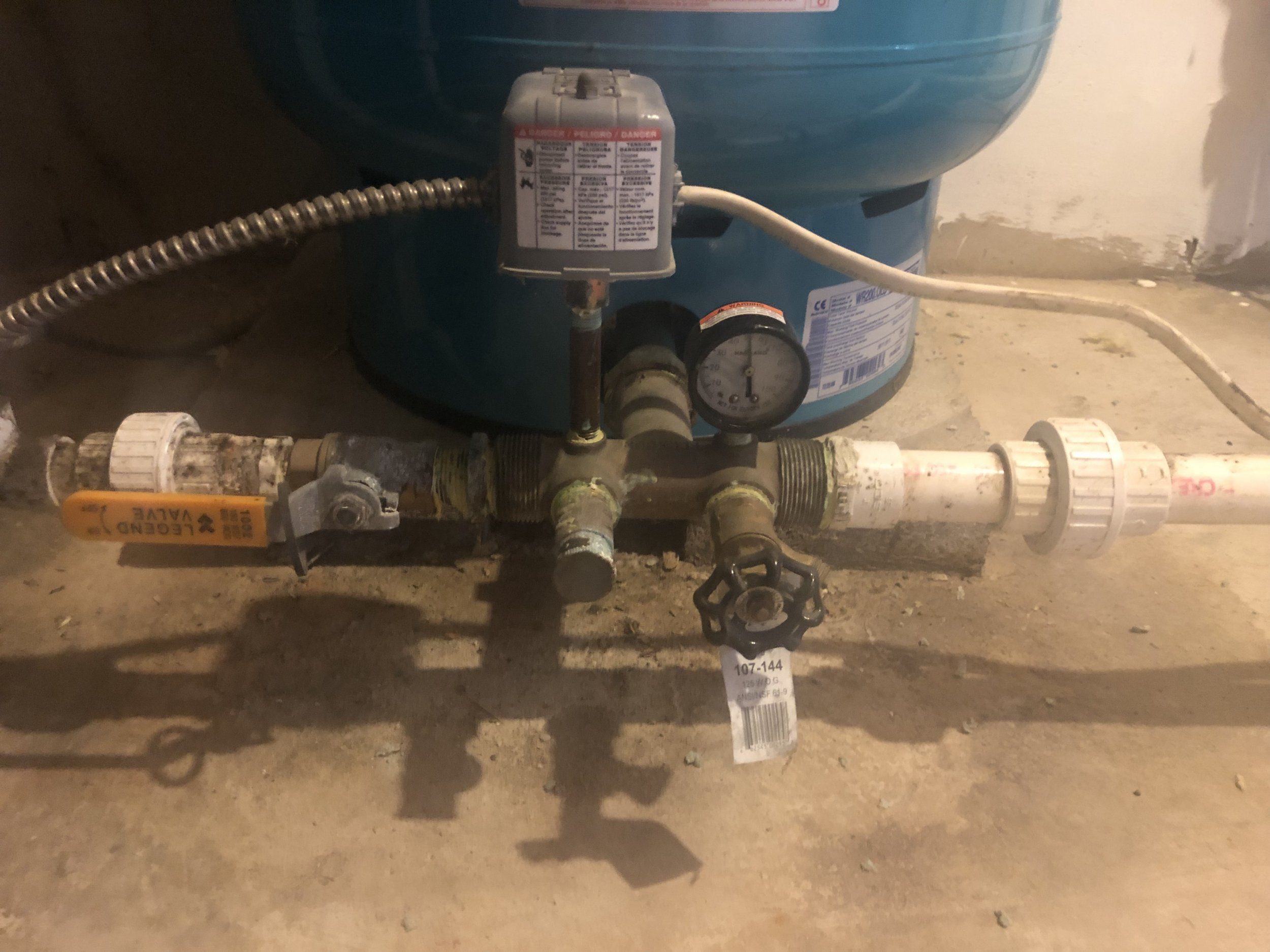

For what it’s worth, this is a picture of my system
. The input from the well is to the right; the water softener system is to the left.

Most well pumps are multi stage units they can develop considerable pressure.
/ Well plumbing Device? #6
Given the corrosion on the outside of the pipes, and that there seems to be a mixture of copper and galvanized, if it were me, I might want to replace the pressure relief and a few other pieces while I was in there.

Yeah as others mentioned, time to pull the manifold apart. The manifold and check valve can be cleaned up and reused, the relief valve if it's weeping should be replaced along with the nipples and adapters.

Not too far from you, in eastern PA. It's common on our hard water, which also usually has some iron in it, to experience the exact symptoms you describe on old well pump switches. The issue is not actually the switch in most cases, but a clog in the 4" x 1/8" or 1/4" nipple upon which the switch is mounted. I'll bet you a beer you're going to find yours clogged with minerals or iron.
Essentially, this restricts flow between the switch and manifold, and builds "lag time" into the switch. So, if water is running, you get the symptom you described, of the system running down to zero pressure, before enough pressure is let off the actual switch thru the restricted nipple, to register the low pressure and turn on the pump. You can ream out the old nipple, but for less than $5, it's a heck of a lot easier to just replace it. Likewise with the switch, there's likely blockage in the orifice leading into the switch diaphram, which could be dug out, but you have to be careful, and likely it should be replaced anyway.
So, when you pick up a new well pump switch, also pick up a new brass nipple upon which to mount the thing. Make sure to note your pressures (30 - 50 vs. 40 - 60 psi), and other features (ie. burst pipe trip), so you get the right switch.

Glad you got the pressure relief valve fixed. You already have a brass 1/4" nipple going to the pressure switch, which usually does not clog like galvanized nipples. However, it is possible. It might also be the overload in the motor tripping. These are auto-resetting overloads and they usually cool down in a minute or so and it seems like the water just magically comes back on. If this is the case you have cycled the pump on and off too many times, which is what destroys pumps, tank bladders, check valves, pressure switches, and just about everything else in a water system. If the tank needs replacing it is time to upgrade to a constant pressure system using a Cycle Stop Valve which will solve all those problems, and can use a much smaller, less expensive tank.
