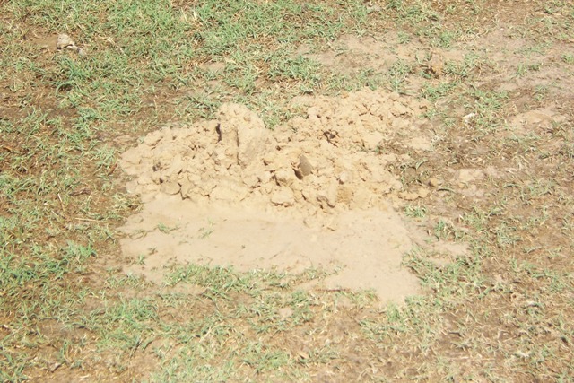

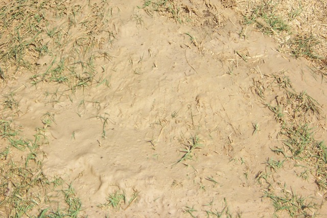

I can't believe its been this long ... the old girl has been doing well, Today I pulled the pump to blow the sand out ... I hit sand at 73 feet and when I was done I was at 84'
it has been doing a good job .. just decided to clean it out ... found out it was dug in 1983 at 95' pumping 8 gpm per minute ... I only have about 11' to go and it should be clear and as good as the day it was bored.

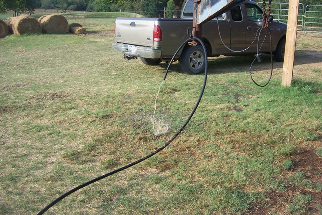

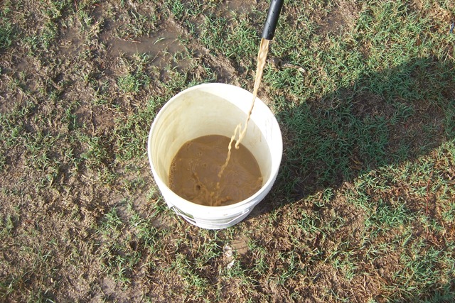

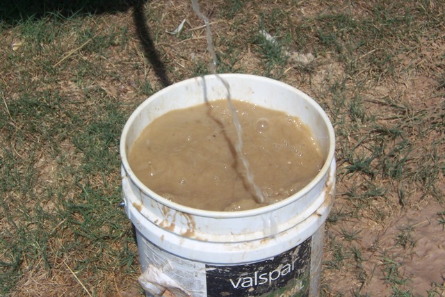

I bought 100' of black water line ... at the end about 12" I put in a tee, reduced it down to fit an air hose, pull the well pump and use the hose with the air pressure and the sand comes out the black hose.

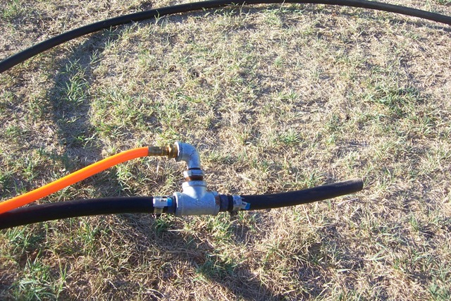

Ok, I'll be darn. Can we get a picture of the end of the pipe with the tee?
