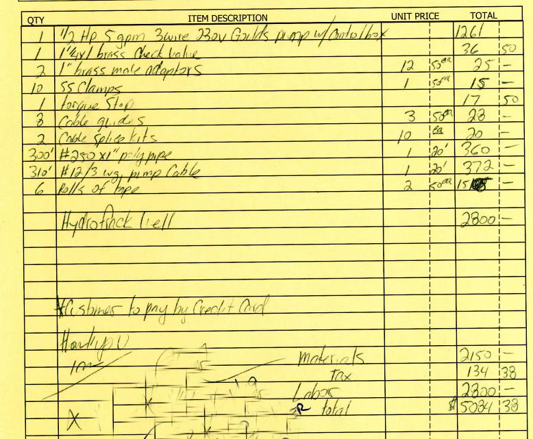

Had a new pump, piping, and wire put in last fall to replace a similar 1/2 hp Goulds pump I installed back in 1986. Also had the well hydrofracked. The markup on materials is significant. I priced out the Gould's pump online and it could be found at about $600-700 with the control box

I see the guy is making big markups, even on the wire!..
If you have to hire out a job, I try not to complain too much about the markups. If you could do the job yourself, you would, but a commercial business has overhead expenses like vehicles, insurance, licensing, business taxes, building leases, etc. They have to build those costs into the markups. The labor rate is generally to just pay the laborer (owner).
This small outfit even credited the customer $50 for helping out - that's pretty cool.

I really think its funny when people complain about a contractor marks up their cost. Of course they do. Its the only way they can stay in business. I learned the hard way that just charging exactly what you paid for an item nearly ended my business. The hidden costs attributed to running a business is staggering. When i finally got serious and itemized every cost to my business using quickbooks, i had a rude awakening. I generally only add 15% markup on materials, but even this earns comments from customers occasionally.
