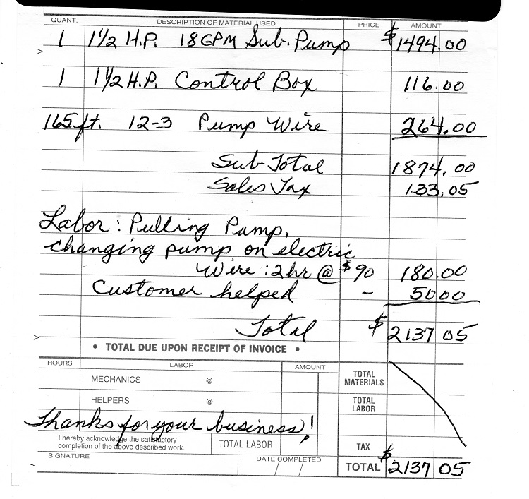

Had to have my well pump pulled a few days ago. For reference, here's the damage:
The well was put in 26 years ago; I essentially got a new system so I don't have to mess with it again in my lifetime!
