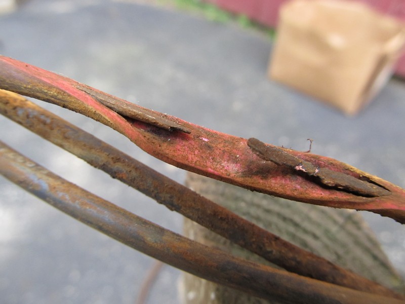

If you should do the job yourself, inspect the wire carefully as well for abrasion. If they aren't provided with the pump, you'll need a couple of waterproof crimp splices.
Find out what brands of pumps the pump guy sells. I looked at what the Lowes' and Home Depot's sell and read the reviews and left me with the feeling I didn't want to go with either of those. My present pump is a Gould's.
Pic below is the wire that was from my own pump when it failed last fall. I have torque arrestors on the pipe, but it evidently still rotated in the well and wore the wire through. My own pump is at 280'. I've pulled it in the past in my younger days, but now prefer to pay someone that has the right equipment to take care of it.

Mark is spot on, You most likely have a rub in one of your wires and that is the source of you issues. One wire nearly rubbed in two will cause the same problem as you have described. hard to start and run a pump with 20 gauge wire for long without it overheating. You can prove your pump is good before pulling by measuring resistance with your meter. Disconnect power and read between each wire and see if you have a short at the pump or broken wire. However if you read resistance you have a good pump and the problem lies in the wire itself.
