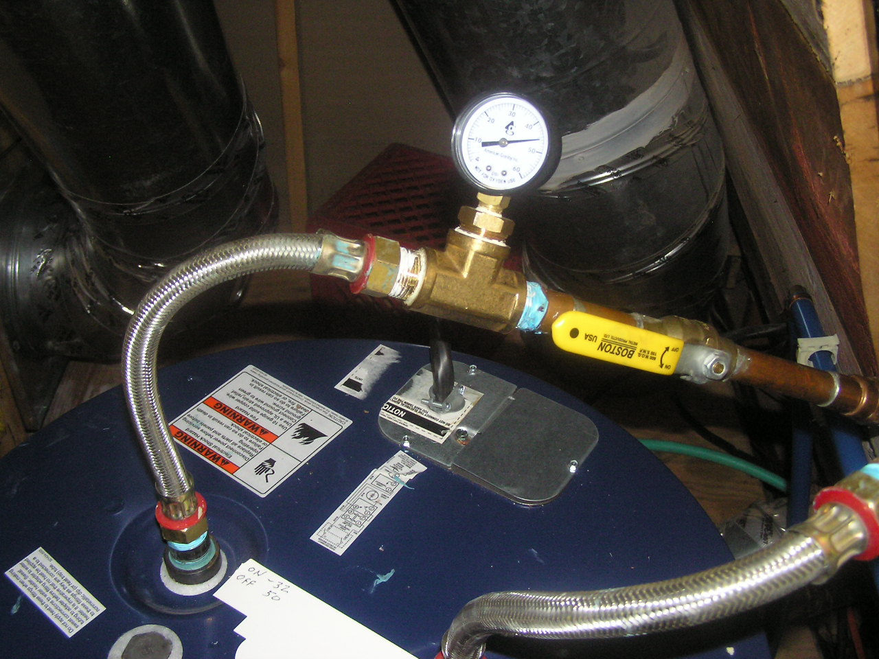

I recommend adding a pressure gauge where it is easy to check.
Mine is on the input to the hot water heater:
