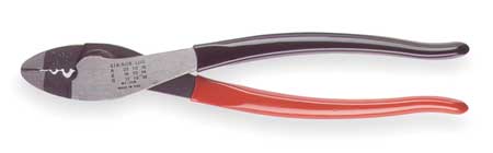

So butt connectors cannot be used on a well pump wire line? The butt connectors are rated to 600v (per package data)
They are allowed by code, but that doesn't mean it's a good idea. It's especially a bad idea if you use pliers or vice grips or some other buggered method for crimping them.
Don't get me wrong - butt splices are great if they are done correctly, but they are usually not done correctly. You need a decent tool, which means, NOT one of these:
And you need to pay attention to the seam orientation and the splice's position in the crimper. Not difficult, but you do need some basic knowledge.
Wire nuts are brain-dead simple, and with the grease, will be a reliable connection for years to come.
And never splice in an inaccessible location. Splices can go bad, so they should never be underground or in a conduit.

I always use a quality crimping tool and the indentation is on the solid non-partitioned spot. I then use heat shrink tubing and then quality electrical tape over that. I NEVER had a butt connection fail or come loose.
Are not ALL well pumps spliced?
When the pump comes out of the box the wiring is only a few feet so it has to be spliced with submersible well wiring. This then sits underwater in the well for years and years.
   / Well Pump Wiring - Where to Buy? #17
I agree with TKO. If butt splice connectors are not done correctly, wire nuts are better. But when done correctly the butt splice is best. Yes all submersible pumps will have butt splice connectors attaching them to the drop wire. They will last for years and years. But you need a crimping tool like this one.
I have those exact same crimpers. Had them for years.:)
