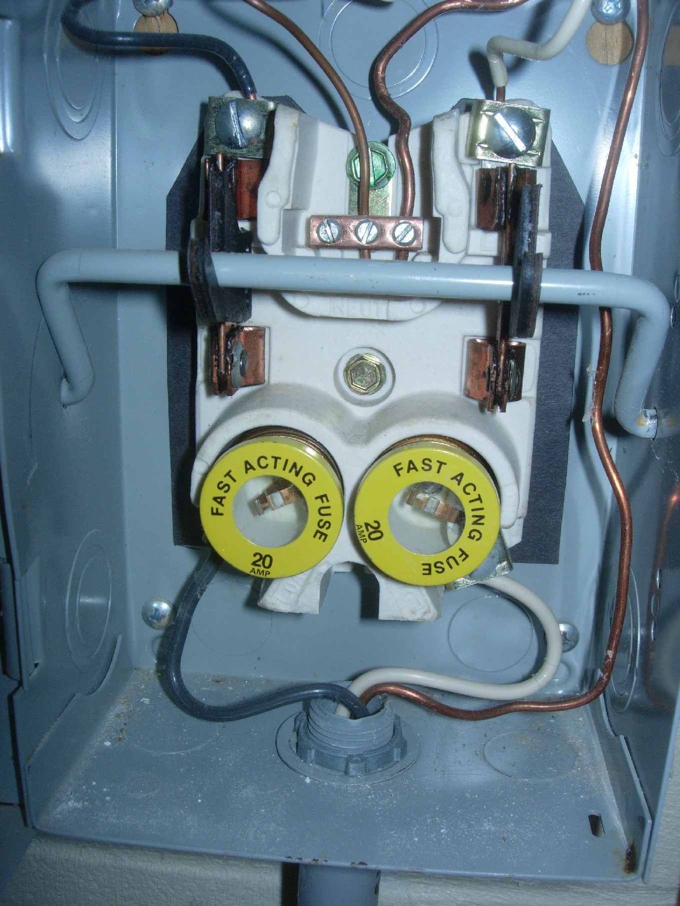

Here's a picture of the item I'm referring to.
Also, seeing as there are evidently more than one type of screw in fuse, are these the correct ones? (I'd rather find out prior to needing them :D)
Also, in case I mislead anyone....these are not in any kind of a well house, but rather, in a finished bathroom closet in my basement (full bath & washer/dryer)

Interesting:
Your pics show a 220 switch box (2 fuses) but the wireing is 110 type, black & white. (220 should be Red & Black)
Generally when 220 is wired with 110 wire stock the electrician will tape the white wire at both ends with red tape to indicate the changeover to 220. Simplifies guessing.
Using a switch/fuse box as a local cut off is a very common practice for pump installations around here. Cheap and cost effective way of providing a 'safety cut off'.
A breaker type cut off would cost 2-3 times more, and higher amp simple 220 toggle switches cost about same if not more than than a breaker knife switch.
Also I can vouch that wireing a 20 or 30 amp circuit into a 'normal' toggle switch is a real pain and often results in broken switches due to the very stiffness of heavier guage wires being stuffed into the box.

NEC requires a disconnect switch for any permanent motors. NEC also specifies that circuit breakers are not to be used as switches. So you would need a breaker box with a separate switch to replace what you have now. That will easily cost 20 times the price of some extra fuses.
And I don't believe you can wire a pump into a "normal" toggle switch. You'd have to have two switches, one for each hot wire, and that would also be against NEC which states the disconnect has to disengage both hot wires simultaneously.
I don't understand why you guys want to make more work for yourselves. Buy an extra set of fuses and keep on them on top of the box.

I don't really know. I don't remember the specific parts of the NEC. I think every disconnect box must be protected and I showed you a link that said critical circuits and cycling motors are better protected by fuses. So there is your answer. Why thats true...
What would concern me is why you had a fuse blow in the first place. Particularly on one line and not both. That is what I'd be getting to the bottom of.

Richard, I may have been the one who misled people into thinking you had an outside wellhouse. That was what I indicated in my first post. Sorry...
I'm curious now if your pump is 220 or 110. Is the breaker a double or single breaker? If you have a 110 pump, that dual fuse box would be a fuse in both the hot and neutral line. That really would be wacky.:confused:

It's on a 220v breaker, 30A if I recall (but don't hold me to that as I've not looked at it in probably a year or more)
Regarding the color of the wires, I don't know what wires go where. As I recall, there is a conduit coming into the bottom of this. Probably a 12-2 w/g, individual wires.
On the right wall is the controller box or what ever it's called that controls the pump itself.
