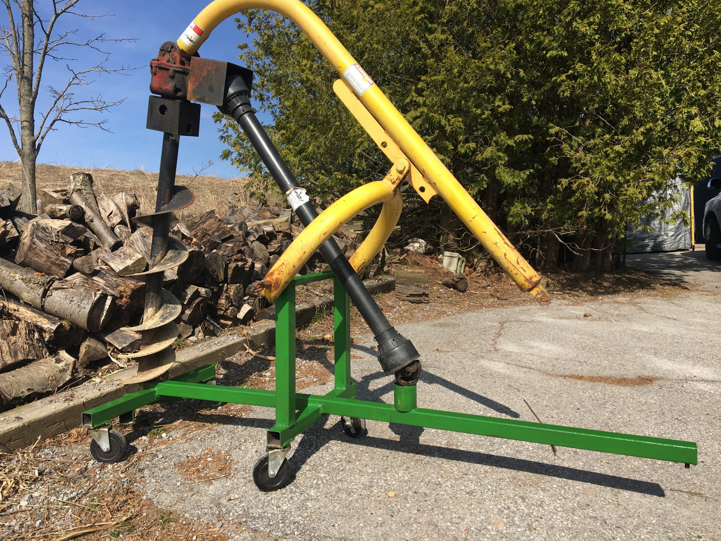

Pic of the carrier I built for the PHD
pic of carrier I made for PHD. Designed to slide under tractor when hooking it up and when not in use can move it around in the yard as needed
