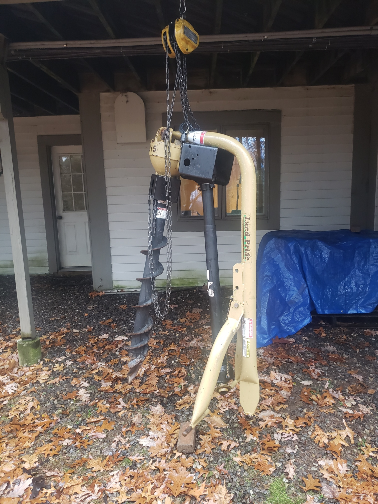

With my current phd I found a way to just hang it under our deck with a chain fall - has worked out great!
I remove 1/2 the pto shaft and store inside and really grease the 1/2 left hanging
