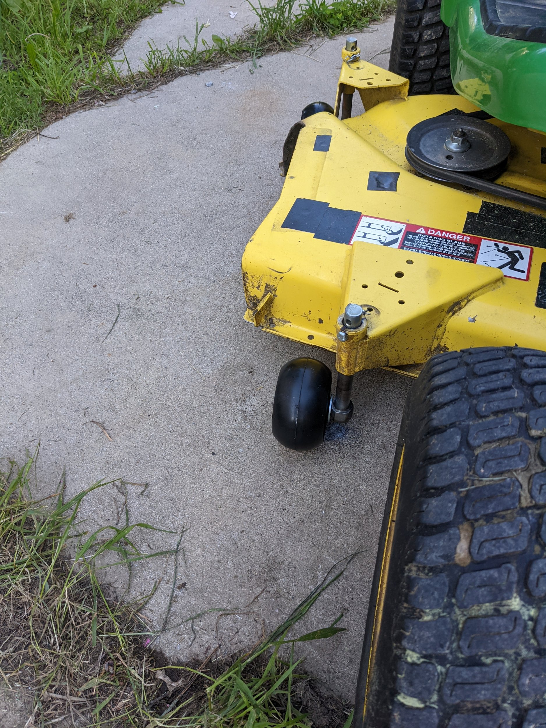

Well made some more progress on the x500 today removed the hood and prepprd the hood for some fiber glass repair. It is not going to be close to perfect. The hood was drilled at the crack ends by PO and he used what appears to be white spackling for the repair Not sure on that but that white will sure show up in the cracks and I could not get it all out so just decided it will be better than Gorrilla taping it Maybe I will reassemble the hood to the mower in the morning. I ordered some replacement deck wheels off of ebay on Tuesday and they showed this afternoon.

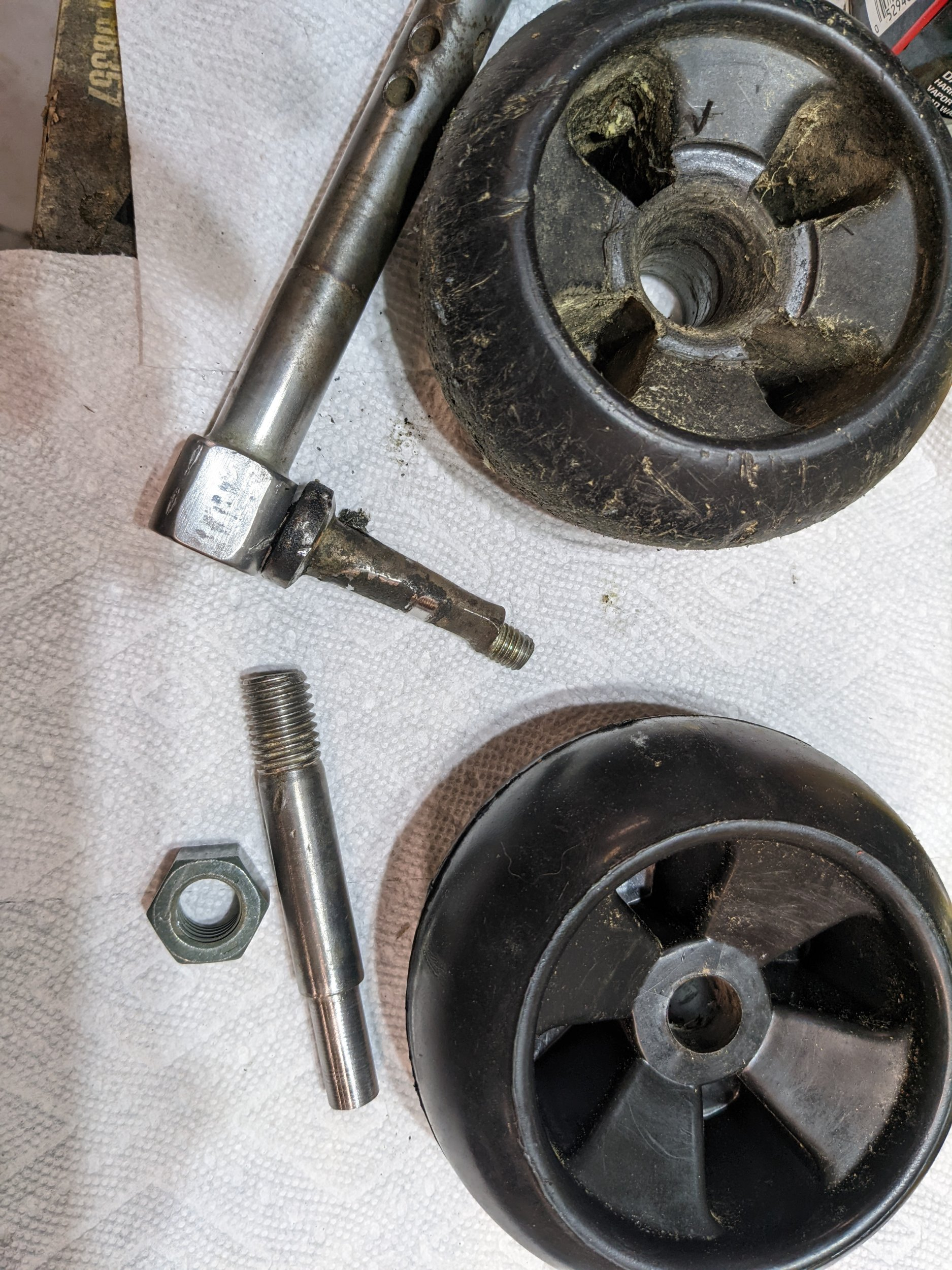

One wheel and the support shaft height adjuster was REALLY worn.

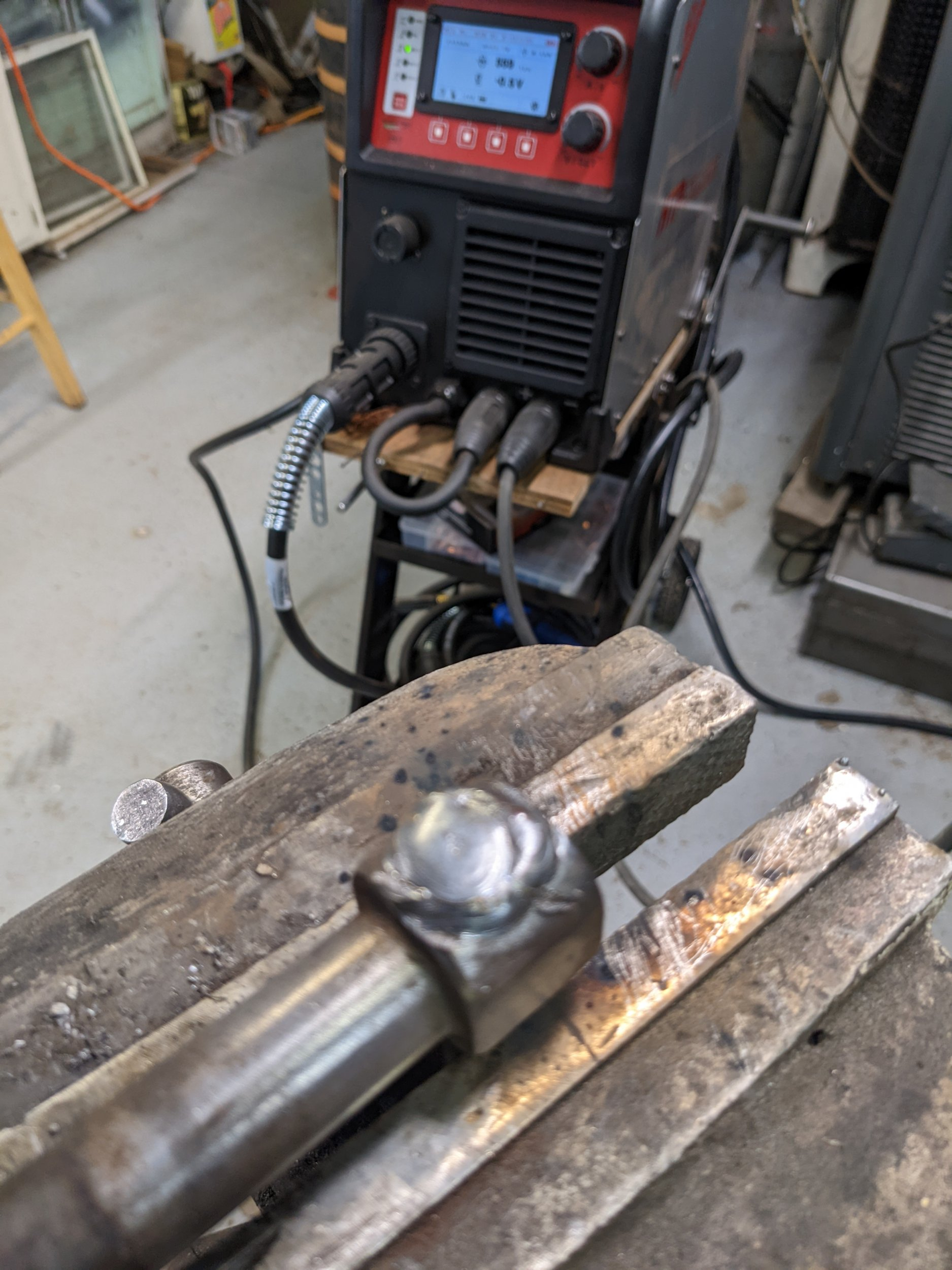

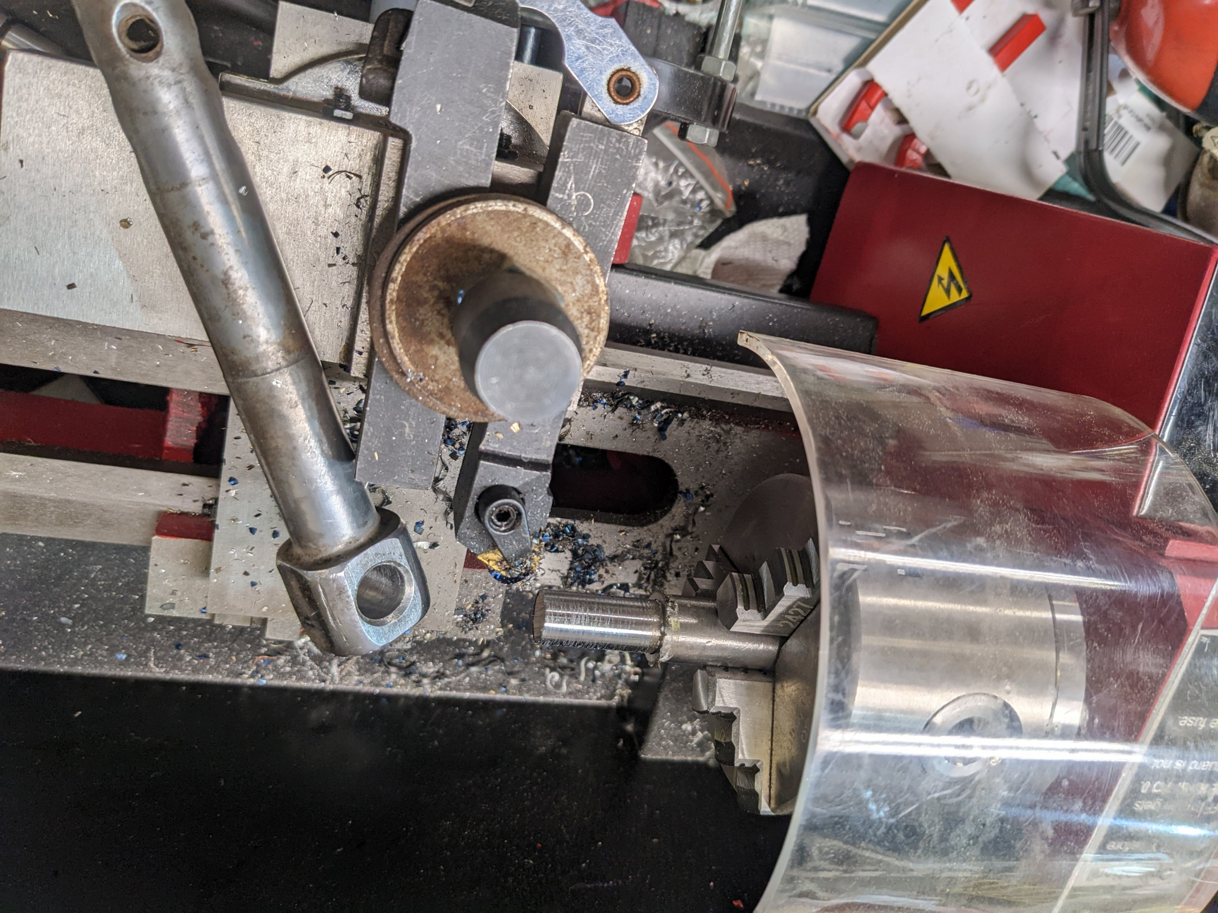

I decided to home brew a repair and drilled out the old wheel shaft Found a bolt that matched the wheel hole size.
Cut the excess threads off and then turned down the remaining bolt to be a light press fit in the drilled out hole.
Finally Got out my "Favorite" new tool the HTP Pro Pulse 220 MIG and Plug welded the shaft end in Synergic Mode. Almost no splatter and a Good Hot and fast weld. Remounted the wheel assembly and did some more test mowing sans hood.
Saved a few bucks to, since the wheel shaft is $20 to $40 on ebay
Really mowing Nice Now.

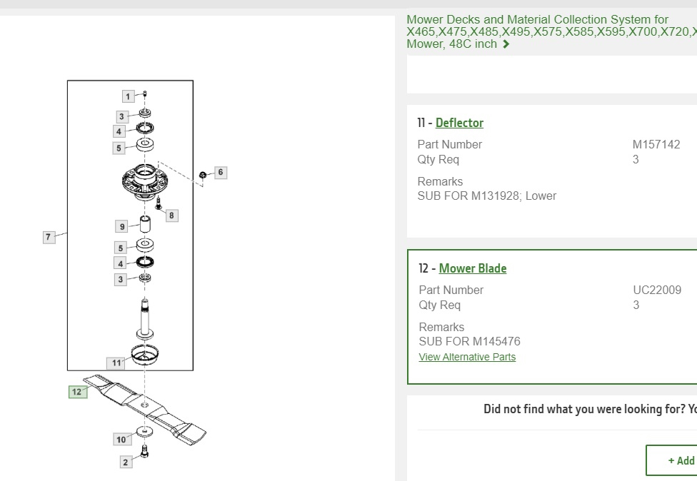

Update
No records,
but I did get the Original owners manual today, and am holding the Husky dealer to one set of 3 new compatible deck blades. They did not order any or know if they had any in stock because JD is a bit tight on the info according to the parts person.
Told them I would find the info in the manual, to not waste their time trying to dig through the manual, and get back to them with the JD and interchange numbers. I have since confirmed this X500 is a 2008 model and also that it has the smaller 48 inch deck.
Surprised this hydro has no external screw on Hydrostat filter, the manual only shows a listing for the X534 and X540 for it but it does have an internal pleated filter for the transaxle.

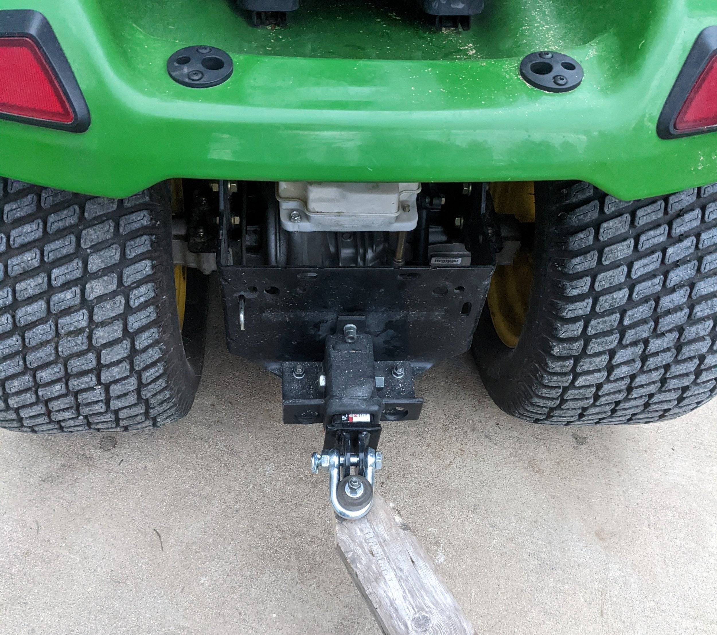

Yeah, I thought it was funny our old MTD that we bought the x 500 to replace has a full size screw on hydro filter and also has a reservoir that looks to be about 3 times the volume of the K72 plus it is also divorced from the hydro unit which may be better at dissipating heat.

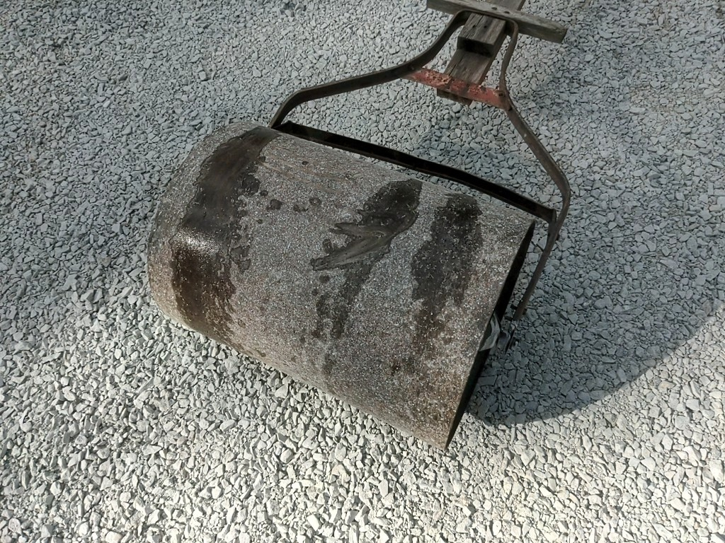

Today I needed to weight roll our driveway after spreading some 3/4 minus with the Rhino tractor and box blade.
Figured it would be nice to use the x500 to pull the roller.
So I modified a generic short receiver from HF and mounted it up with three 3/8" bolts and also turned a nut down to the ID of the existing hitch hole and then MIGed it on along with a center upper L bracket.
If the receiver comes loose, my guess is the Hydro will be toast long before the hitch comes loose.
The roller is a "Manual" unit from my FIL's old landscape company for seating "Green side up" sod that we were given years ago.
I added rubber suspension bushings and then just bolted through them and a couple washers and It works well for taking a bit of shock out of starting or stopping.
After a bit of use found the roller was leaking so I drilled out the leaking areas and then plug welded them shut after purging the inner airspace with Argon CO2 mix, and almost full of water Not taking a big chance when welding on a vessel that has much internal volume.
The under Hood fiberglass repair i did is bugging me and the cracks really detract from the mowers overall condition, so if i have some extra time tomorrow may try and do a little body work and see if using Fizz can Van Sickle JD Green to the the hoods plastic casting line can improve the looks a bit.
