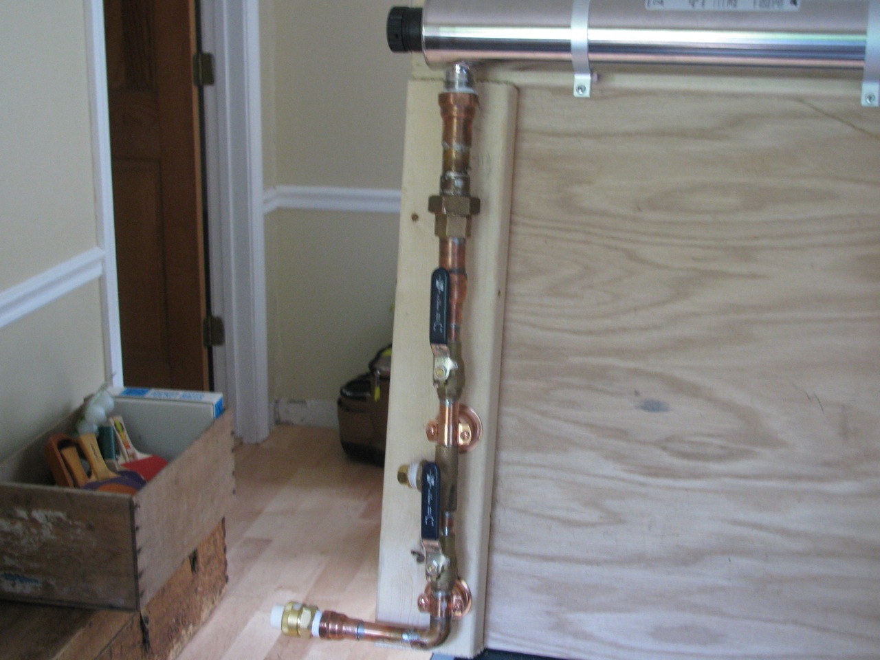

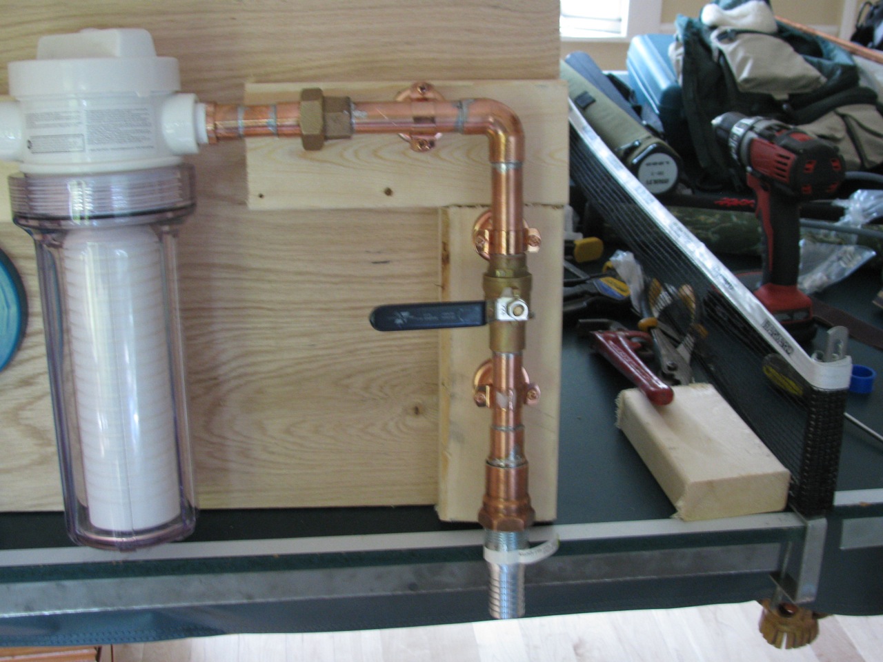

Like you we had problems in the past with our dug well so I went ahead and installed two filters in line with our cold water system, prior to the On Demand Hot Water unit. First filter is a sediment filter that is 5 micron variety.
From there it goes to a carbon filter that is mainly for taste as it removes them and the water taste great, from there it goes into a UV lamp to kill as much bacteria as possible.
I think you can find the filter housing at Home Depot or Lowe's and they also carry the replacement filters. I would suggest that you buy the ones that have a shut-off built in as it makes changing the filters fairly easy. Figuring out when to change the filters is your next step and all I do is when I notice the pressure going down at the tap I know it is time to change the filters. I normally change both at the same time, but you might find you only have to change the sediment and then change the carbon one maybe every second or third change cycle. I only say this as I do not know the condition of your water. You could go one step further and add a flow meter on the piping coming out of the final filter and as the pressure drops you will know it is time to change the filters.
I have been buying filters and UV lamps on line as they are cheaper that way and if I order enough in advance then I am ready when things go south on us.
I stuck with the surface well for all these years because the water quality is good and not as much iron in it as all of the people around us that elected to drill wells. Most are down more than 400 feet and at todays drilling cost that isn't cheap either. We end up watching the water usage during the summer months though.
I buy allot of the stuff form Ohio Pure Water Water purification, replacement filter cartridge, iron removal system, Fleck control valve
Way back when I purchased our Sterilight Ultraviolet Disinfection system from them and just stuck with them as they have always treated us fairly.
You can also find most of the sediment filter housings and filter elements on line at places like Ebay.
Just my two cents
Wayne
Here are a few pictures of the system that we installed at our summer home (camp) I made it easy to blow out for winterization by adding several cut-offs, a few purge fittings and what have you.
I got carried away with all of the fittings, but felt if I had to change out a filter housing I would not have to cut the pipes, plus I had most of the fittings already so it was a zero cost for me.
