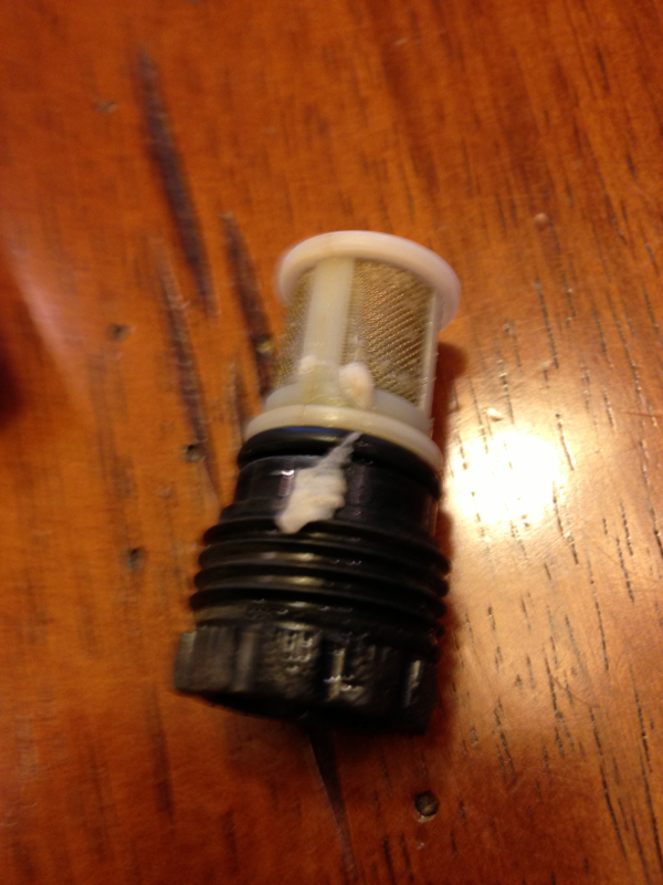

I have the same problem, haven't solved it yet. It is a bacteria that grows in moving water. I don't know if there is a filter that will keep the bacteria trapped in the filter.
Google, "biofilm slime"

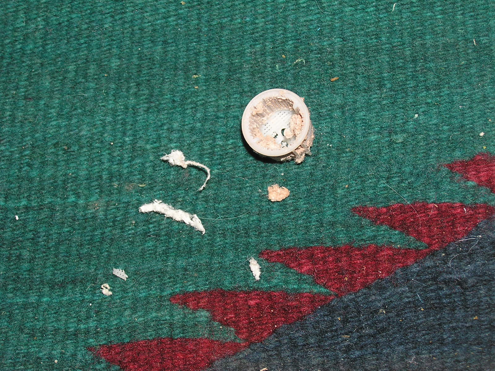

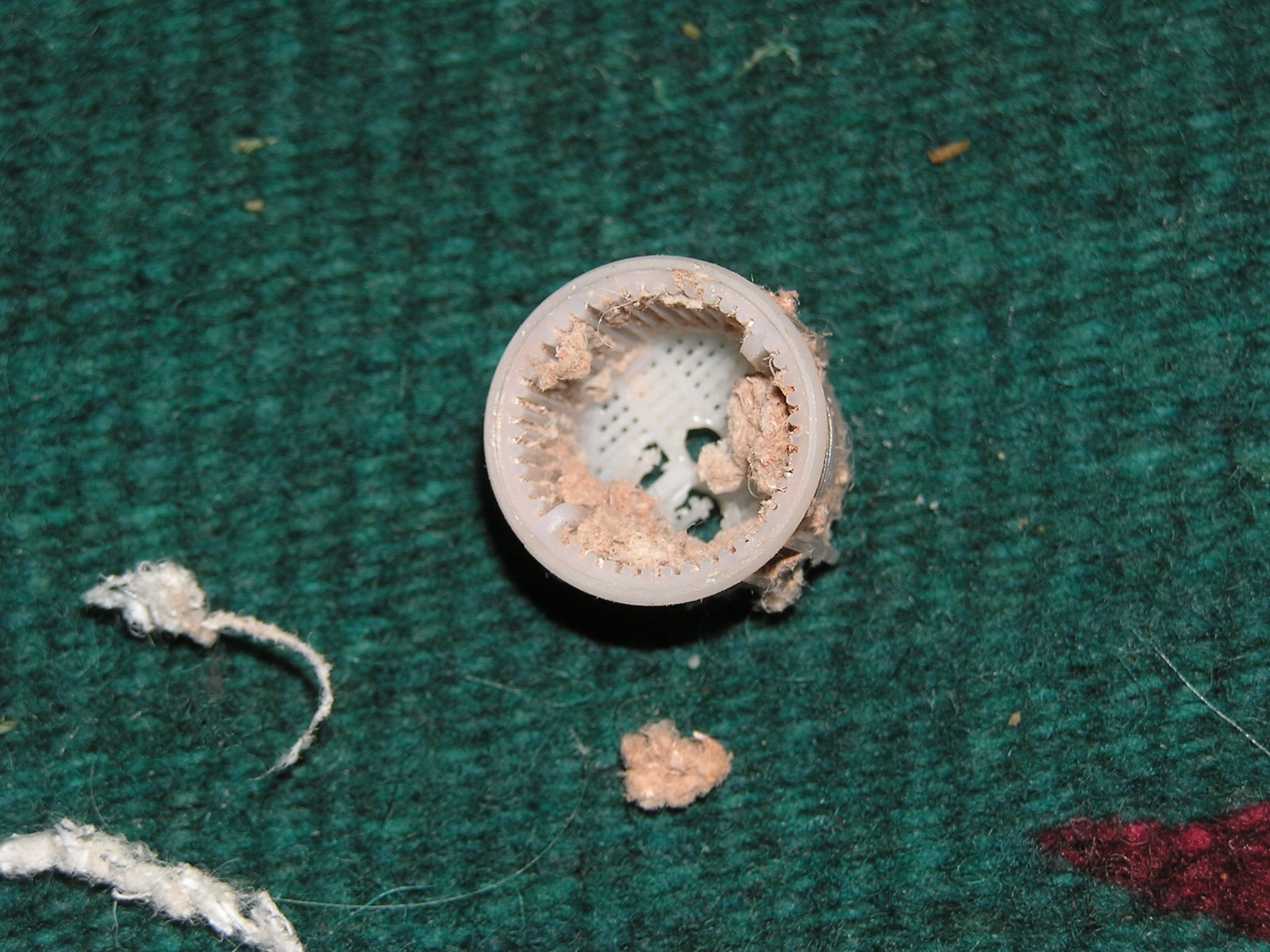

This is what it looks like after it dries out. The round plastic filter was removed from the cold water inlet on the washing machine after I added a second hose screen.

Here is an iPhone pic of my water heater screen. That white stuff is what I am talking about.

Our problem isn't sediment, sand, etc, that will fall to the bottom of the tank. I don't have a large pressure tank, mine is in the well casing. 99 percent on my water bypasses the pressure tank through a cycle stop constant pressure valve. The pump only runs fast enough to supply the demand.
Read about it here: http://www.tractorbynet.com/forums/rural-living/271589-water-well-pump-monitor-3.html
I don't have any problem on the hot water screen at the sink in the bathroom, so I think the heat kills the bacteria. The cold water side plugs up solid in a couple of weeks. The screens are in the flexible hoses at the faucet.
