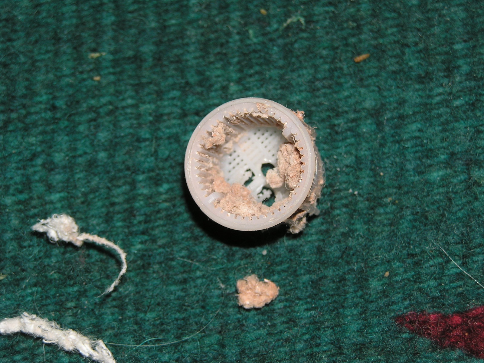

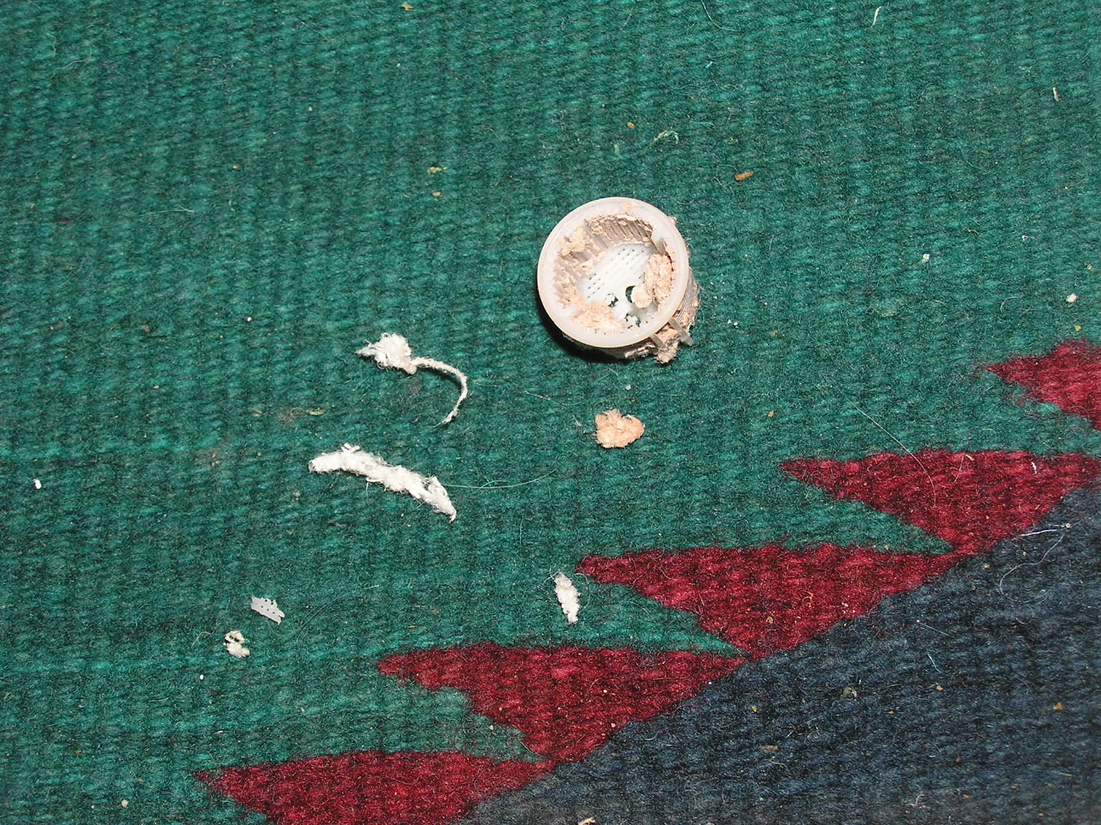

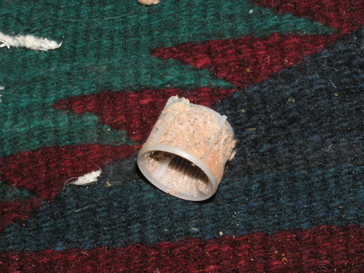

The last few years it seems all the faucets are getting plugged up and the inlet screen on the tankless water heater gets clogged up in just 3 or 4 weeks and I am constantly having to clean them. The washing machine gets to where no water will flow into it. I have to pull the hoses off and clean the input screens quite often. What I clean out of the filters is white, almost like cotton or cotton thread. The water is pretty soft and otherwise is fine.
I really don't want the expense of a whole house filter, but would like some kind of pre screen for the whole house, so all I have to do is clean that out and not everything else in the house. I see where you can get #140 mesh inline filters with 1.5" inlets for only about $60 and they claim anywere from 25 to 60 gpm. I am willing to invest more than that for a whole house solution, but really don't need the filter to take out microbles or anything really small.
Any ideas?
I have the same problem, haven't solved it yet. It is a bacteria that grows in moving water. I don't know if there is a filter that will keep the bacteria trapped in the filter.
Google, "biofilm slime"
Biofilm - Wikipedia, the free encyclopedia
Wipe out the 10 worst germ hot spots - Health - Infectious diseases | NBC News
This is what it looks like after it dries out. The round plastic filter was removed from the cold water inlet on the washing machine after I added a second hose screen.

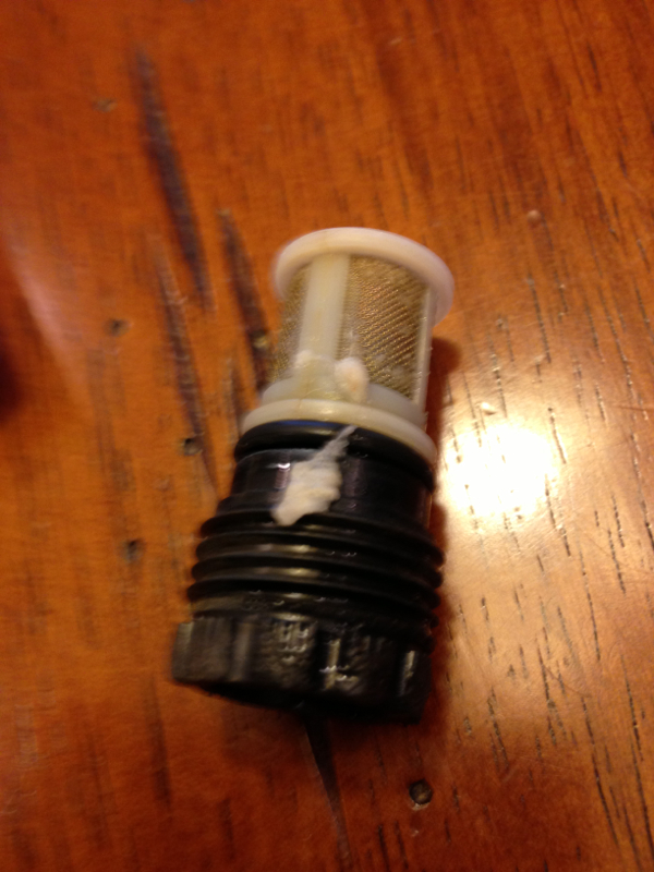

Here is an iPhone pic of my water heater screen. That white stuff is what I am talking about.
   / Well water - clogged screens on faucets and hot water heater #18
Yep, that is what mine looks like when it is wet.
