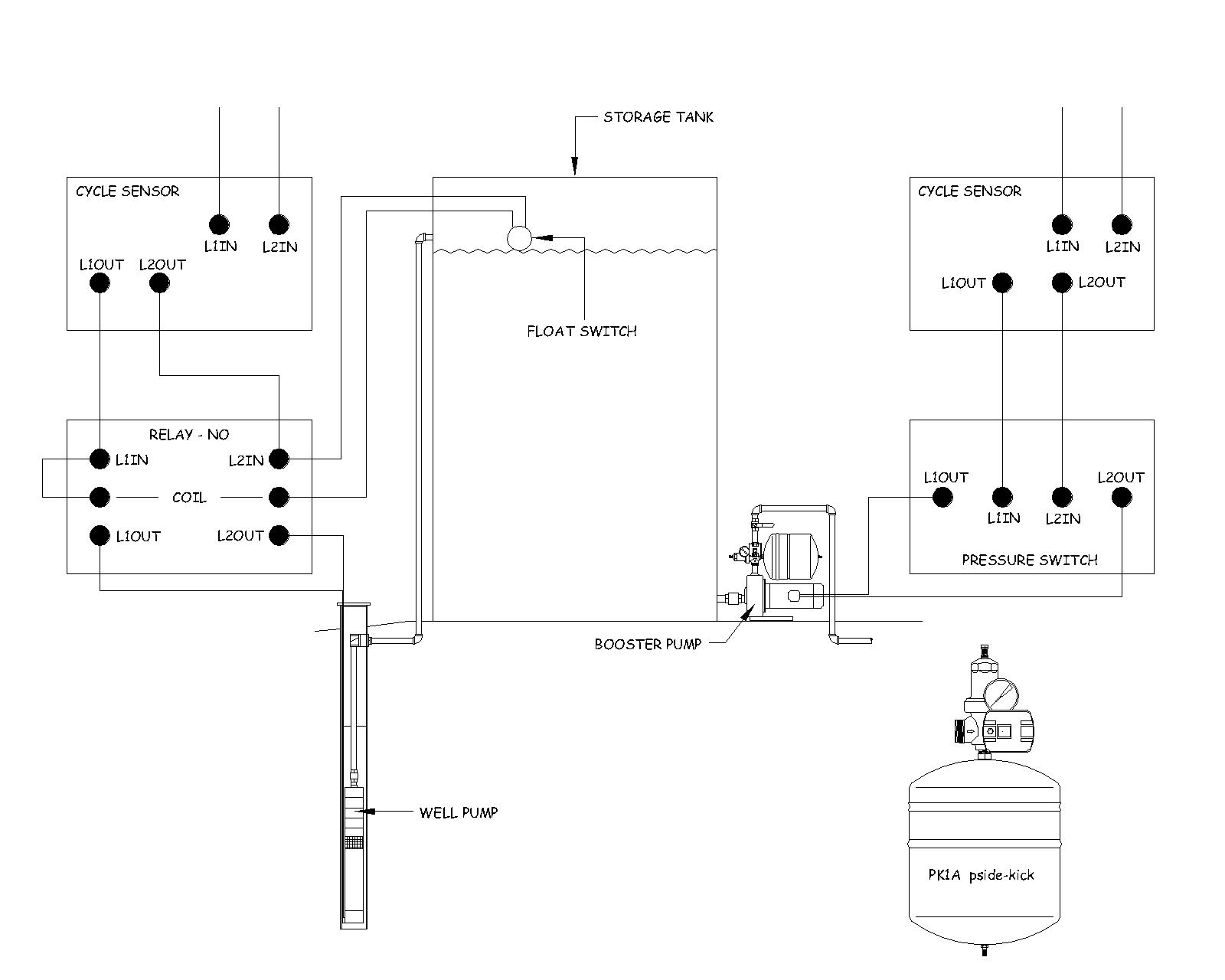

Because in my neck of the woods, it's not unusual to have pumps that will make over 300 pounds of pressure. When the valve closes and the tank is filling at 1/2 gpm and you put 300 pounds of pressure on pipe that is rated for 160 psi......could be a problem.
With a pump that can build over 300 PSI it is usually in a low producing well with a high static water level. A pump building that much pressure is unusual and is the hardest application for a CSV. But usually the well pipe is rated for enough pressure to handle the back pressure. We just have to use two CSV's in series to stair step the pressure down from 300 to the 50 PSI constant that you need. Even 300 PSI back pressure is easier on the pump than cycling on and off.
However, most low producing wells are equipped with a cistern or storage tank, so the pressure from the pump is a moot point. Then the CSV is used on the booster pump to keep it from cycling on and off while the house uses water.
   / Well Water Has Suddenly Gone Brown #49
It also seems terribly energy inefficient.
The CSV is just as efficient as a VFD, which many people claim will SAVE energy even thought it doesn't. However, both the VFD and the CSV use more energy per gallon when using low flow rates. A house doesn't use much water, and there is usually no difference in the electric bill when using a CSV. But even if it cost two dollars a month more in electricity, it more than makes up for that in the longevity of the pump and equipment.
Efficiency really only matters when using water for long terms like irrigation. So, when irrigating, care must be taken to use enough water to keep the pump efficient, same as it is with any pump control system. When using max flow from the pump, it is just as efficient with a CSV as without.
