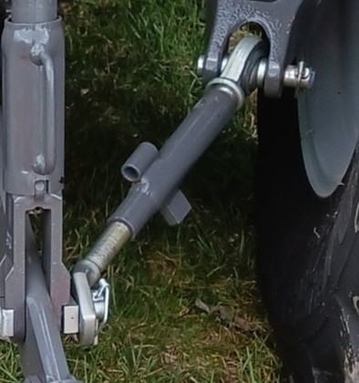

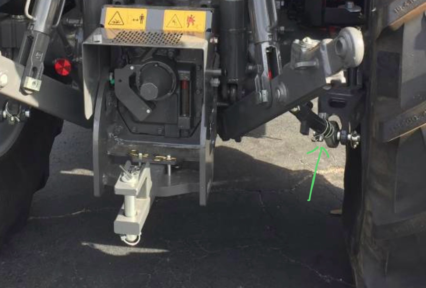

I believe the stabilizers are at their max. There is only one side of each that is threaded.
   / Went from a Category 1 to Category 2 tractor. Now attachments won't fit #12
I think you spotted it. It is not the pins or bushings. The threaded sway bars are only extended at one end. Extend the other threaded end to an equal distance & it should fit.
Well, I pulled up another picture of those stabilizers and they appear to be pinned at the tractor end and only the implement end extends...
Apparently you remove the pin, rotate the tube to extend the implement end, then put the pin back in.
I'd never seen that before, so I looked it up. Learned something new today. 🙃

Look at the photo you posted. It looks like only one end of the sway controls is threaded out. The threaded parts should be equal. You have more adjustment not being used.
   / Went from a Category 1 to Category 2 tractor. Now attachments won't fit #16
IF the tractor end is threaded : you’d have to take one end apart & unthread it equally then it would lengthen
Letting the hitch arms come in closer to accept his mower in pic.
IF tractor end isn’t threaded then it would have to swivel freely for the opposite end to unthread.
I’m assuming those 2 pins on top of the PTO guard goes in the tractor ends & not threaded ?

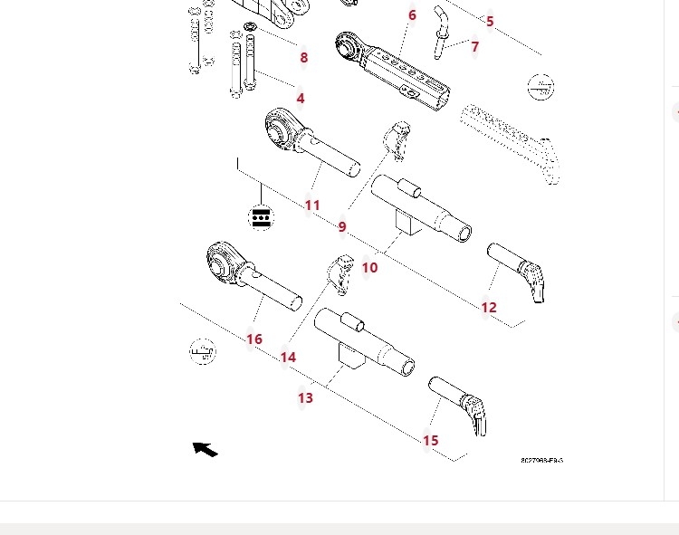

I'm not familiar with your tractor but usually the axle end of that type of stabilizer when the pin is remove can be extended to another pin hole in the inner shank. If you twist the collar to shorten the threaded end, then with the pin you have laying on the pto shield removed the "fixed" shank attached at the axle end should extend and have another set of holes for the pin to go into.

I have a mix of Cat 1 and 2 implements. Check out the Kubota telescoping stabilizer links. There may be a set that fits your machine.

Stabilizer bars are set up wrong, should have equal threaded adjustment on both ends like a "standard turnbuckle" (by tool handling tube/blocks on tubes) ....
