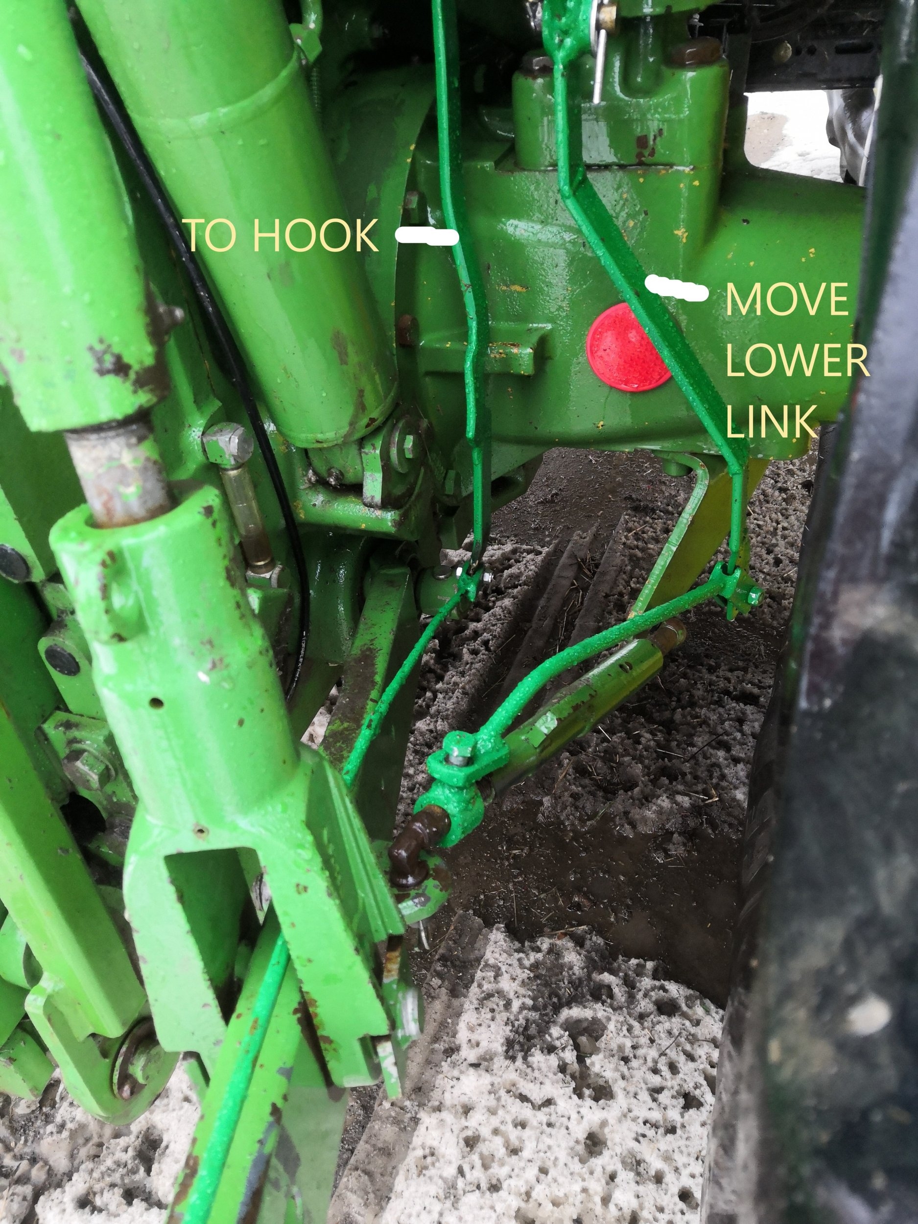

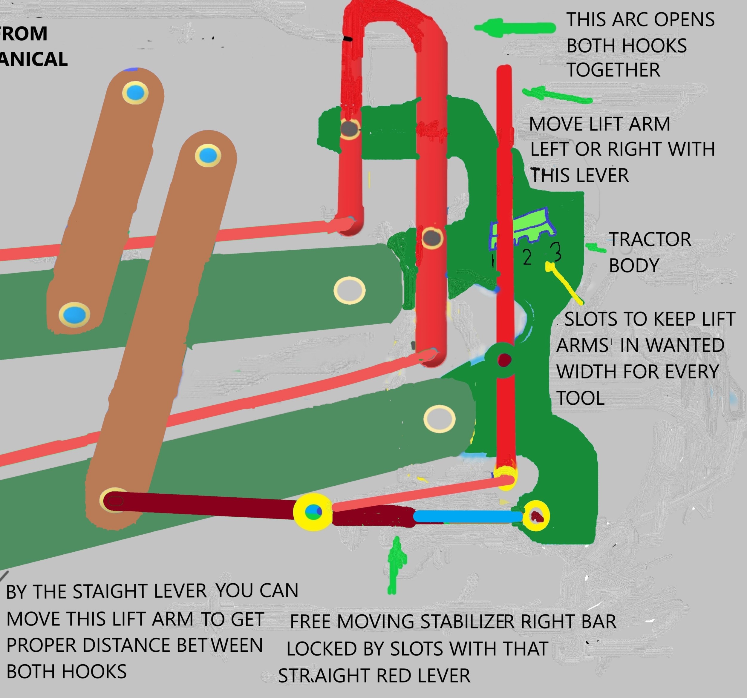

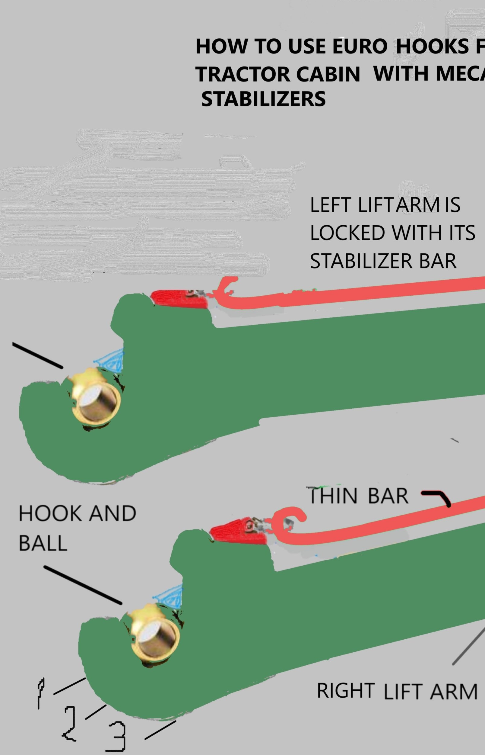

I hope you and others try to make Eurohooks usable from the tractor cabin.
Here is JD and we can move the lower arm with that link on right..
Right arm is moving with the right lever.
Left arm is hold steady.

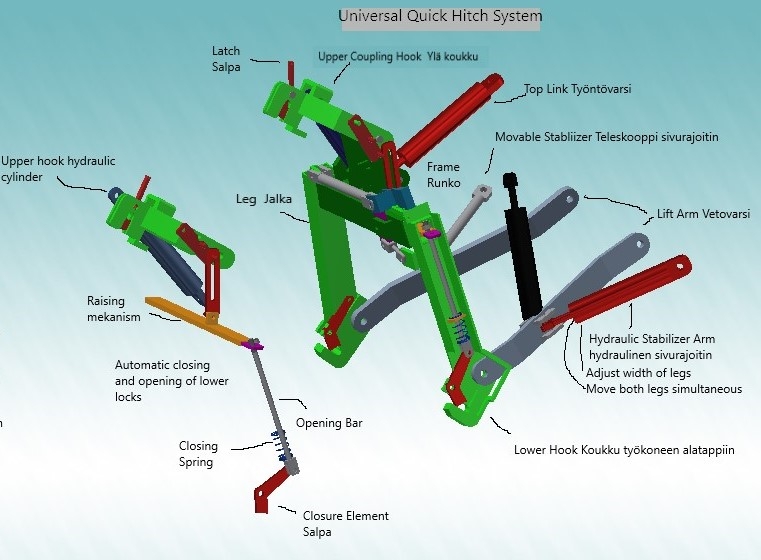

I was pending patent for these and my Universal quick hitches.
But it take 3 years in USA for inspecting patent papers and they wanted more papers and more money. So I stopped pending because I do not have much time time.
Now everybody and company can fabricate my ideas.
My idea was the back lever for hydraulic 3 point for Valmet 502 and Valmet 702.
After it game those push buttons at back fenders to every tractor.
MY Universal QH
