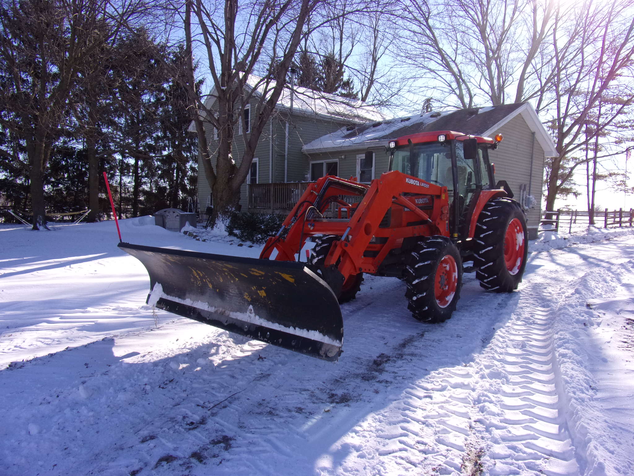

Have one of them as well, A Lucknow (Helm Welding, Canada) rear mount 7.5 foot 2 stage. Sits in the barn, really don't need it but with the plow on the front, and the blower on the back, I'm basically unstoppable. I can do a 7 foot drift if it's cold and dry but it makes the M9 smoke a bit...:laughing:
My SSQA snowplow mount and 3rd function I made myself in the shop. 100_0007.JPG100_0006.JPG

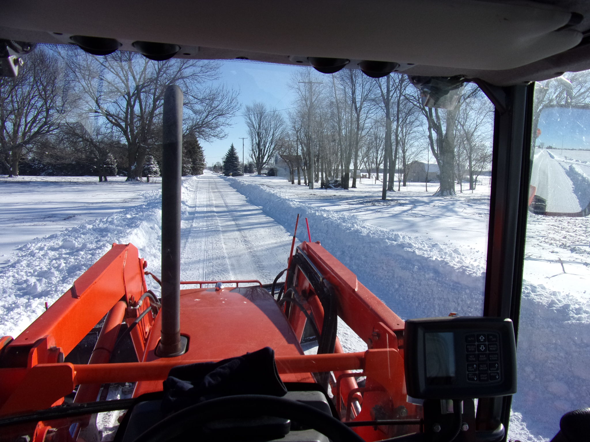

I much prefer frame mounted plows to loader mounted plows. One of many reasons is the frame mounted blade is closer to the rear axle. That lessens the effect a pile of snow in front of an angled blade has on the direction of travel.
Only time mine plow steers is really deep drifted snow (see picture). Couple inches is childs play. I don't even bother plowing until 5 is on the ground. Not much difference between a frame mount and my SSQA, maybe 8" and remember with the cab M9 I have it weighs close to 10K with the plow on. I get 10K cooking down the road at 10 or 12 mph, not much stops it.

One, I don't have that option, I own farmland here and I farm it and two, that is what overcenter trip springs are for on a snowplow. The spring trip allows the plow to ride over an object, well maybe not a utility pole but you need to observe things like that.
The only time a loader frame will get 'wadded up' is if the operator is wadded up himself. Plowing snow does have a certain degree of adult responsibility involved.
Been doing it for years with mine (had a smaller plow and sold it and bought the 10 footer) and never an issue.

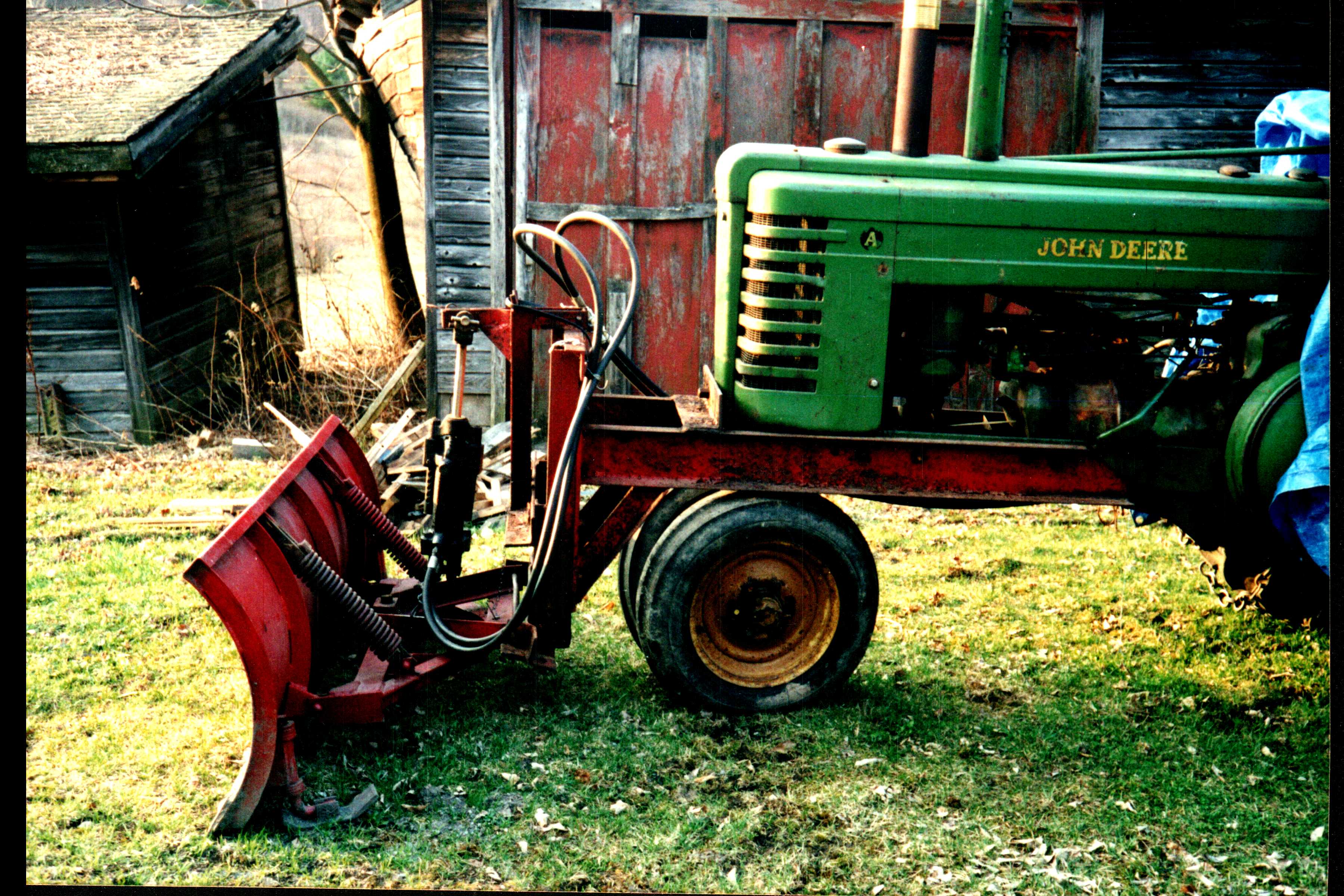

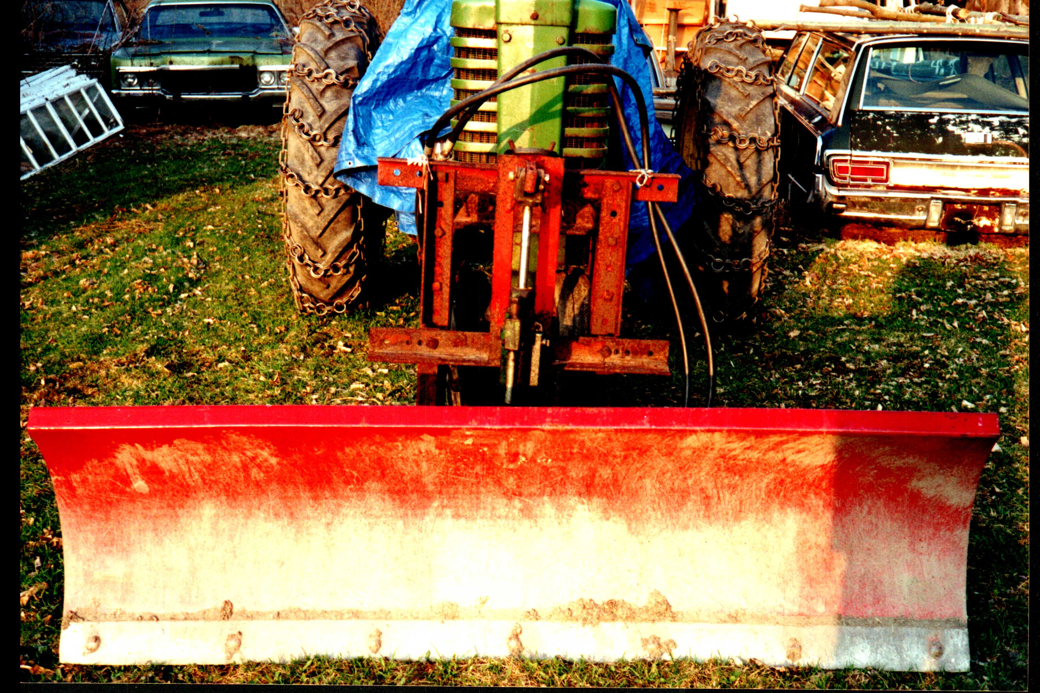

The Western snow plow is attached to grandfathers 1946 John Deere A. My brother still has both the tractor and snow plow.
Decent setup that will do the job a heck of a lot better then a shovel.
A close coupled plow will work better and be easier to use the a SSQA blade on a front end loader.
I don't see a power angle and those old double ring chains are the roughest riding chains around for a farm tractor.
That said if I didn't have what I do for snow that would work and much better then shoveling by hand.
The first tractor I plowed snow with was an Allis Chalmers WD with that style chain,
those chains do work good in fields with deep snow.
