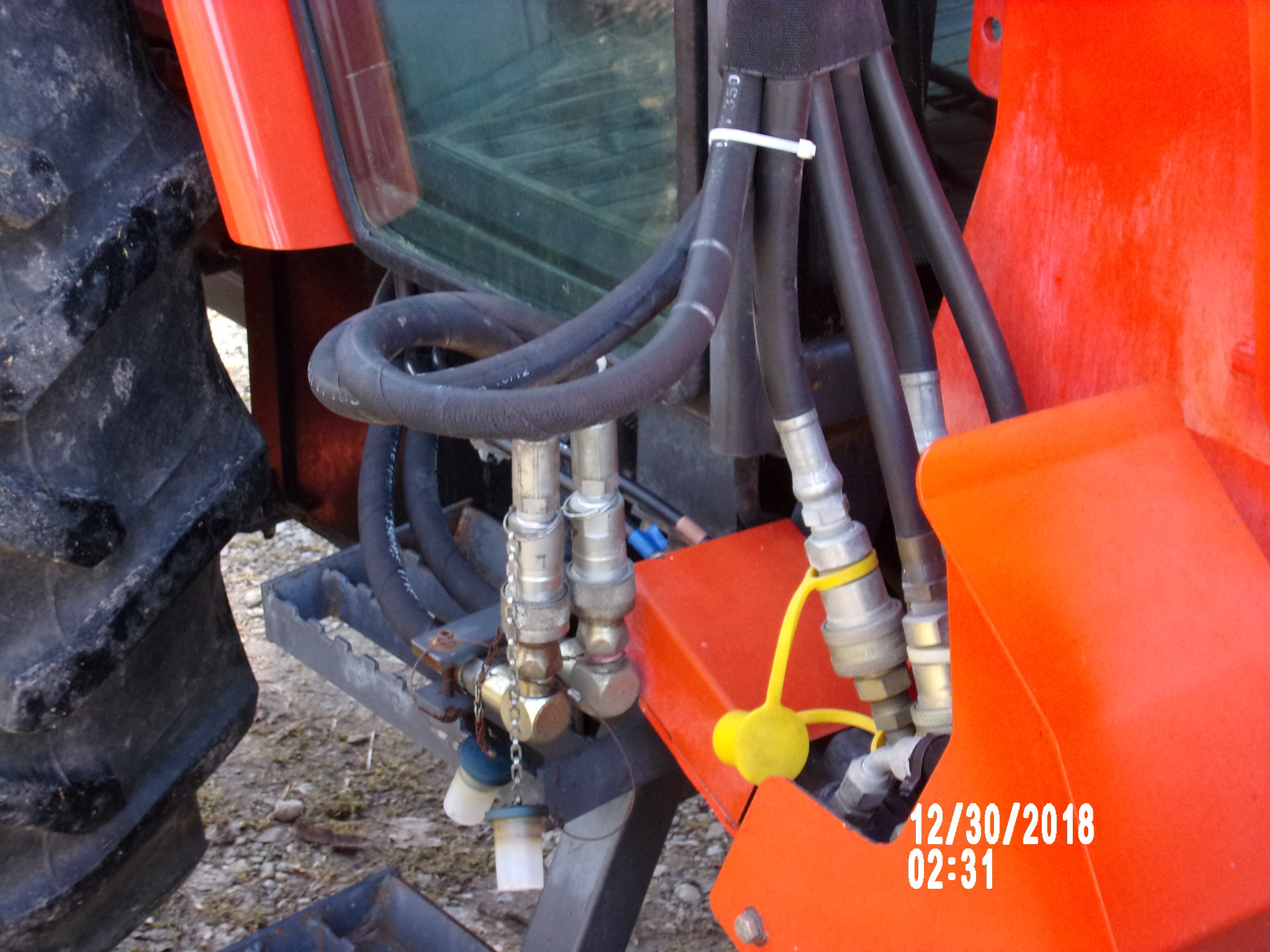

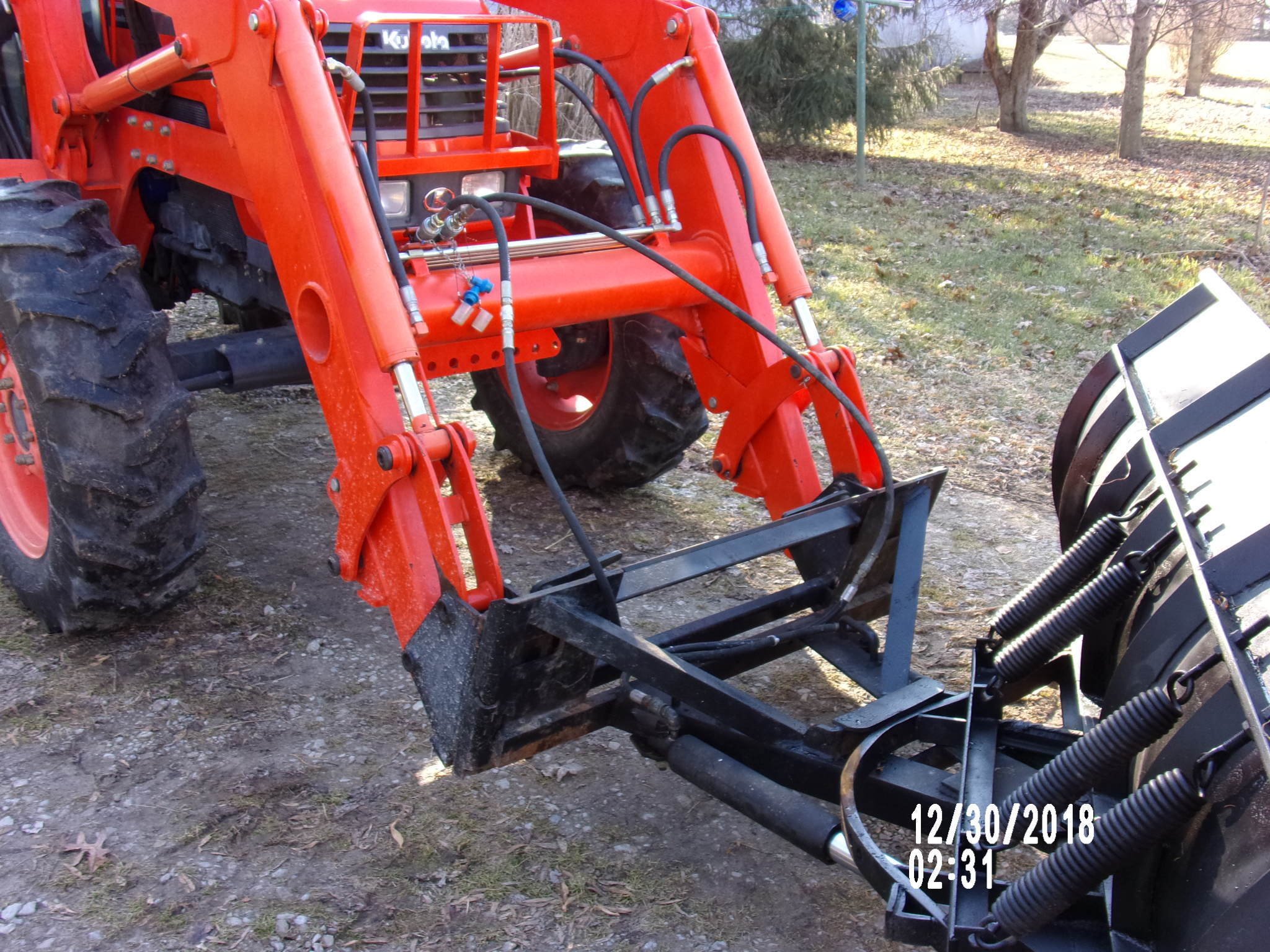

My SSQA snowplow mount and 3rd function I made myself in the shop. 100_0007.JPG100_0006.JPG

I much prefer frame mounted plows to loader mounted plows. One of many reasons is the frame mounted blade is closer to the rear axle. That lessens the effect a pile of snow in front of an angled blade has on the direction of travel.
Only time mine plow steers is really deep drifted snow (see picture). Couple inches is childs play. I don't even bother plowing until 5 is on the ground. Not much difference between a frame mount and my SSQA, maybe 8" and remember with the cab M9 I have it weighs close to 10K with the plow on. I get 10K cooking down the road at 10 or 12 mph, not much stops it.

One, I don't have that option, I own farmland here and I farm it and two, that is what overcenter trip springs are for on a snowplow. The spring trip allows the plow to ride over an object, well maybe not a utility pole but you need to observe things like that.
The only time a loader frame will get 'wadded up' is if the operator is wadded up himself. Plowing snow does have a certain degree of adult responsibility involved.
Been doing it for years with mine (had a smaller plow and sold it and bought the 10 footer) and never an issue.
