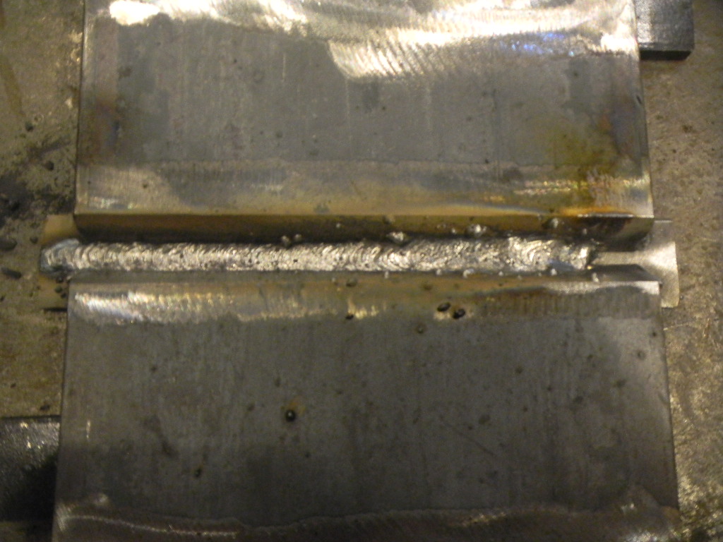

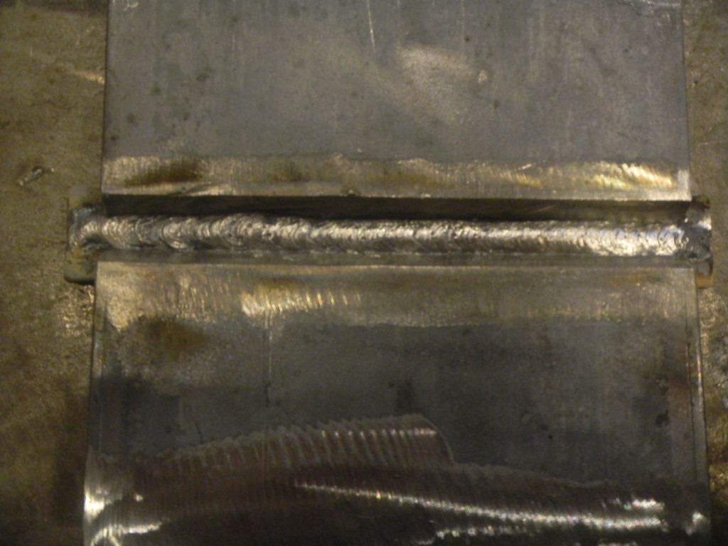

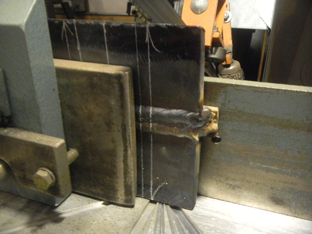

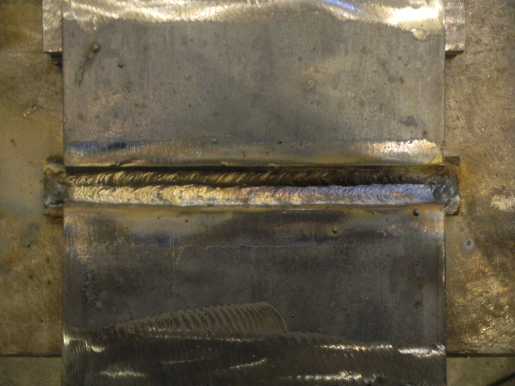

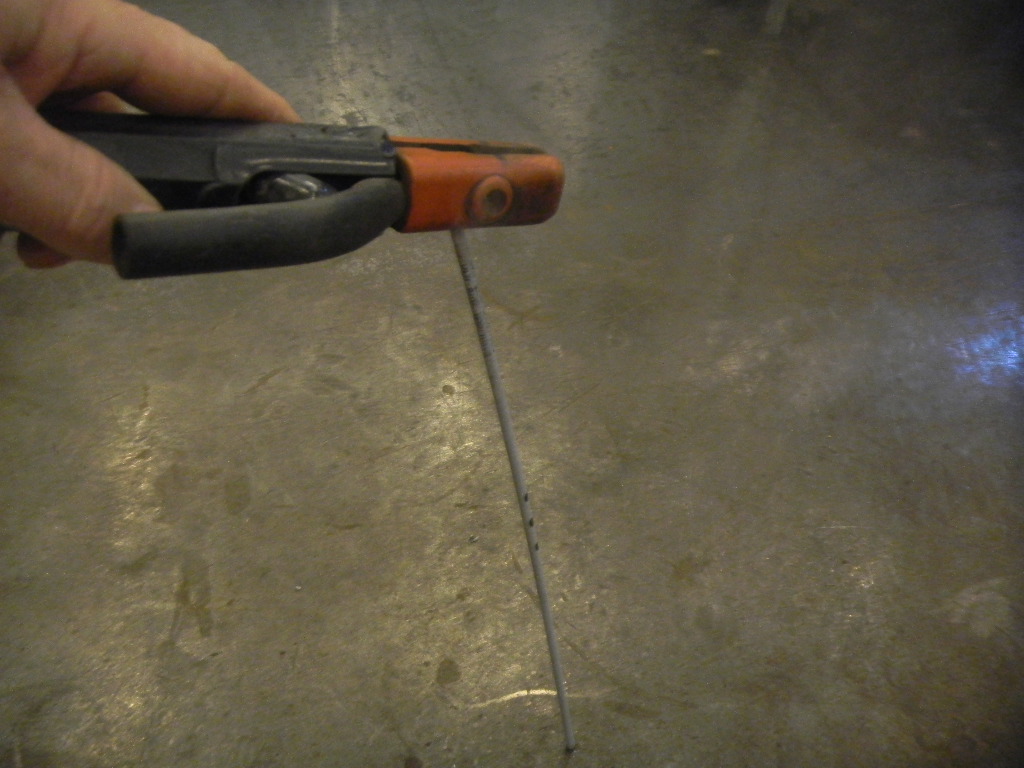

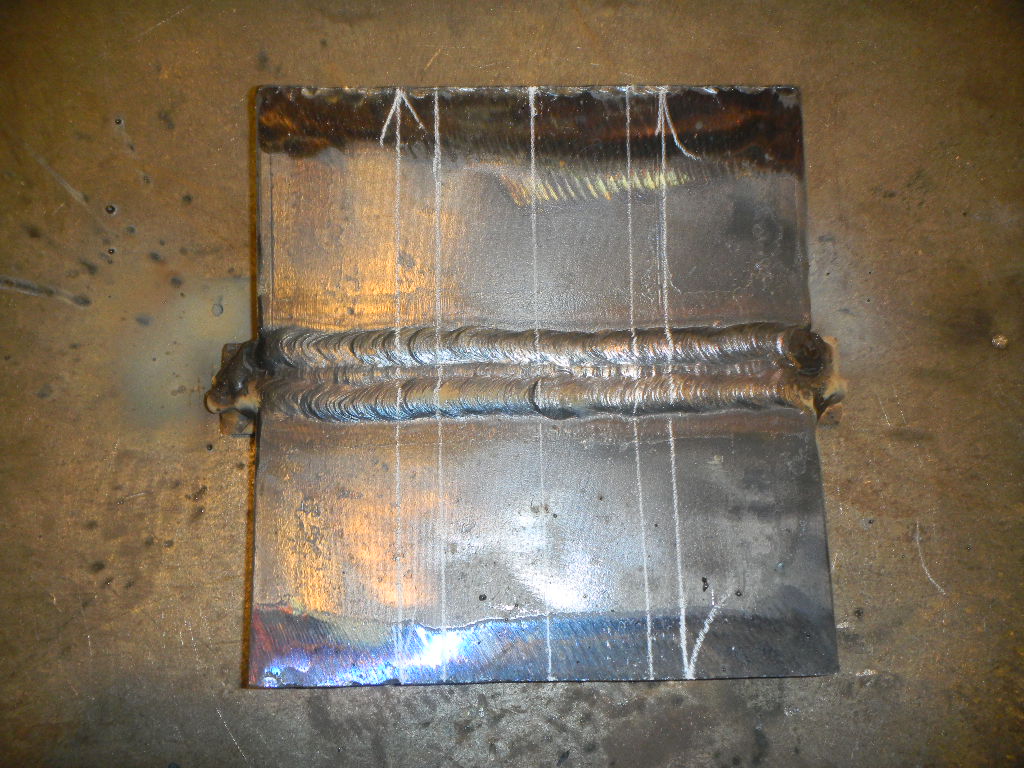

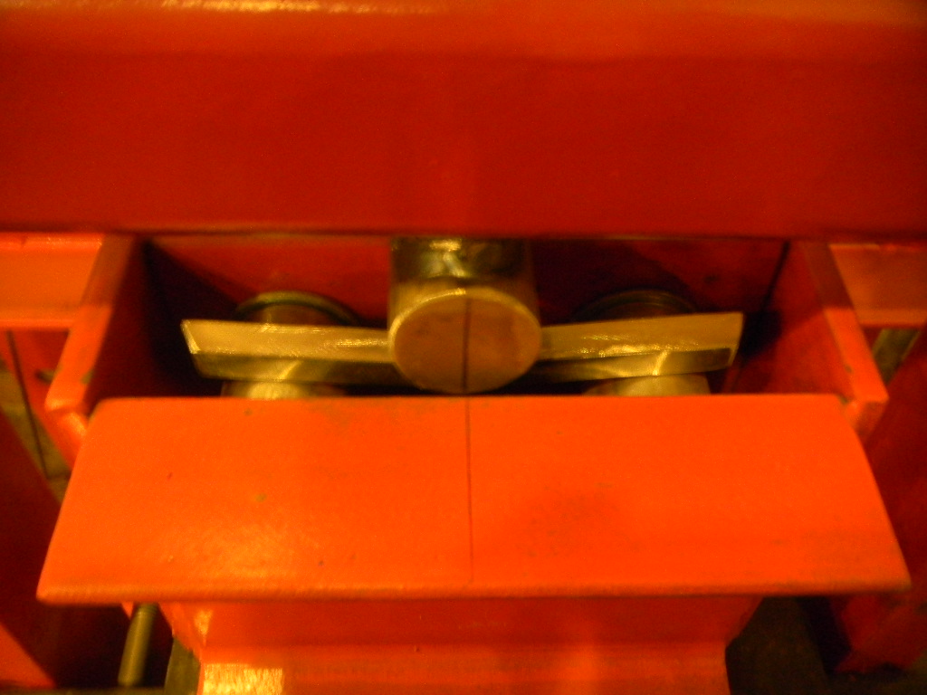

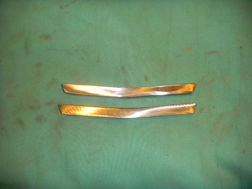

First off let me start with the disclaimer! I don't recommend this one little bit. But I just wanted to see what I could get away with!:D

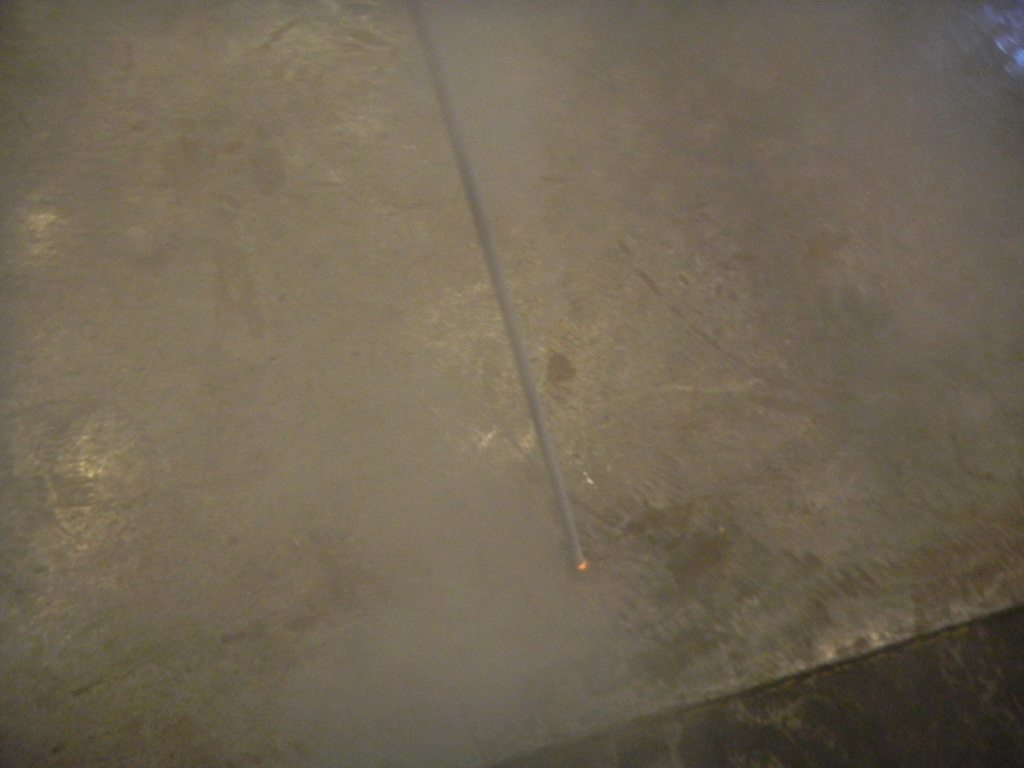

I took some 1/2-inch plate, cut 45-degree angles on them. Placed them 3/16-inch apart. Took a hand full of 1/8-inch Lincoln Excalibur 7018. This rod has been setting on the bench for years in an open can, never seen the inside of a rod oven. I placed the rod in a welding rod can, and filled the can with water. Poured the water out. Set the Lincoln V350-pro to 120-amps, 0.0 on the arc force. Before using each rod, I placed them in the stinger and grounded them out on the welding table. Once the water started to boil out of the rod I used my glove to dry off the rod. I ran one rod after the other on this test plate, only stopping to clean. Cut the coupons into 3/8-inch strips, and did a side bend test.
I don't think they came out to bad.;)

I think most of us use rods that are not as perfectly cared for as they say we should, not that bad but it does show what can be done with what is at hand. Thanks for the post Ed

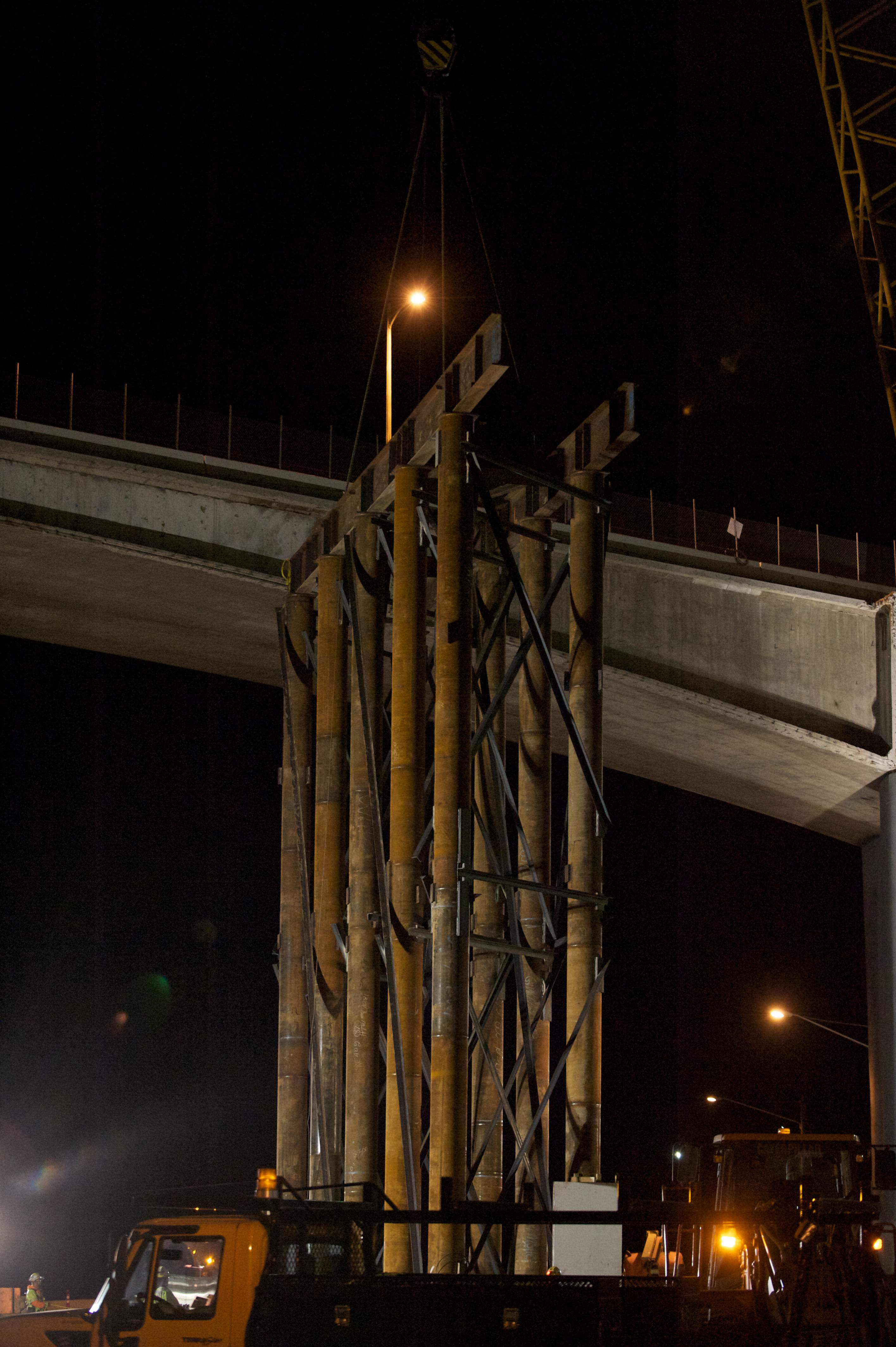

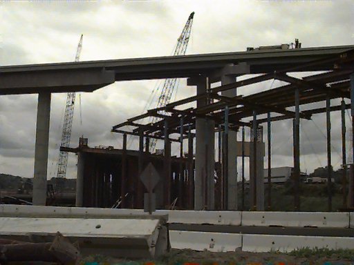

Not so much on these tractor forums, but on the welding forums you can get into serious trouble mentioning you use 7018 that did not come right out of an oven:rolleyes:. Well that's fine, if you're doing code work. But not all of us are doing code work 100% of the time! I can't tell how many times on the job site I had to pour water out of a can of 7018 because some carpenter type left the lid to gang box open. Even though I was building bridge falsework, never did any testing with wet 7018 until this morning.:laughing:

Pssssh.. that's not even that wet!! The flux isn't all white patches and chalky.. and missing in spots :eek: lol.
I usually go buy a box and keep it in my warmer when I'm doing something important, like a trailer or a hitch.. that means I usually have several pounds in partial boxes kicking around, so unfortunately I have to use wet rods a fair bit for less critical jobs.
My biggest complaints about wet 7018 are flaky flux and hard chipping. Plus there is a bit more spatter. Some of that is likely due to the higher amperage I find I need with the wet stuff.
Good test, just goes to show that a sound weld can be made with less than ideal materials.

Yeah that was my point. I use to build bridges for a living, even concrete bridges have massive amounts of steel falsework. Something has to hold the concrete forms up right:D? I can't tell you how many times a carpenter type would leave the lid of the gang box open when it was raining and get the 7018 wet.
Like I said, I don't recommend doing this, but just because you don't have an oven don't worry too much!;)

As long as the core wire isn't rusty, sticking the rod to heat it up and boil out the water works fine for drying. Prior to getting a rod oven, the only thing I could do was keep the plastic containers taped up which didn't do too well and over time would develop the white powder on the flux which is a sure sign that rods have not been stored properly whether LH with iron powder or cellulose covered. I always had to ground the rod and wait till it stopped steaming and they would weld pretty good. The 60xx usually welded OK but not great and tended to finger-nail bad when they were exposed to too much moisture or if not enough moisture. Lots of times in desert climates, we had to dunk the 6010s in water to give them some moisture so they ran right.

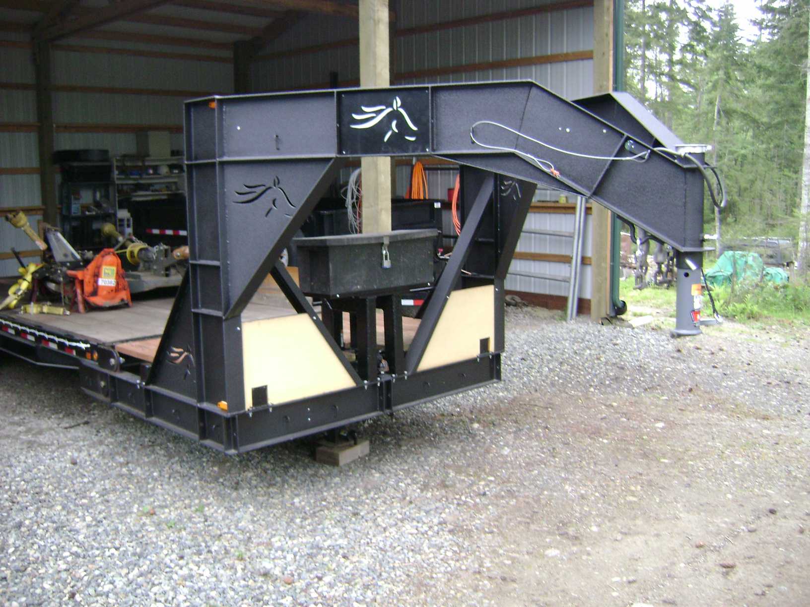

I built these two gooseneck adapters, first one for a buddy, the second one for my self. My buddy wanted his welded up with 7018, I had him buy a new can never been opened, when he got here I through the rod in the oven. My gooseneck adapter I mostly Mig welded everything.
Now it may make some of you members nervous that these go down the hiway, but I'm not worried!;)
My point is, if you are going to build a trailer, or something that someone could get killed if a weld failed, by all means buy new 7018.
But can you imagine the loads that are placed on that bridge falsework? I don't think I've ever been on a job that didn't have at least one engineer on it, they never seemed to have a problem with us welding in the rain, as long as the office roof didn't leak they could care less what we did out in the field!:laughing:
