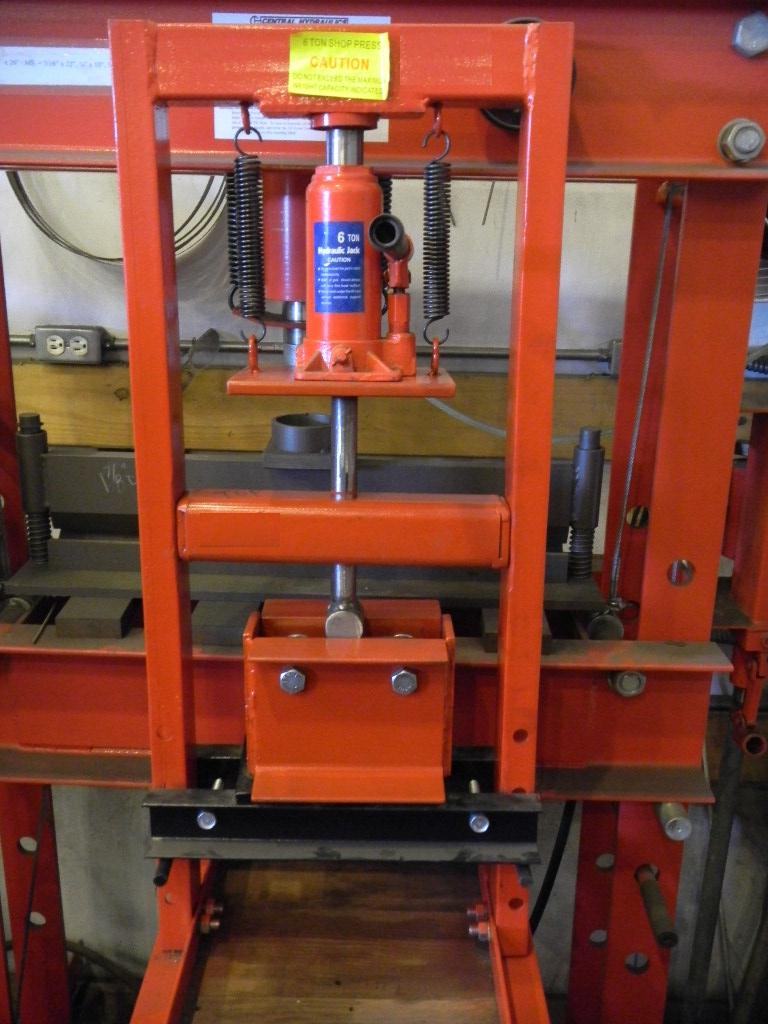

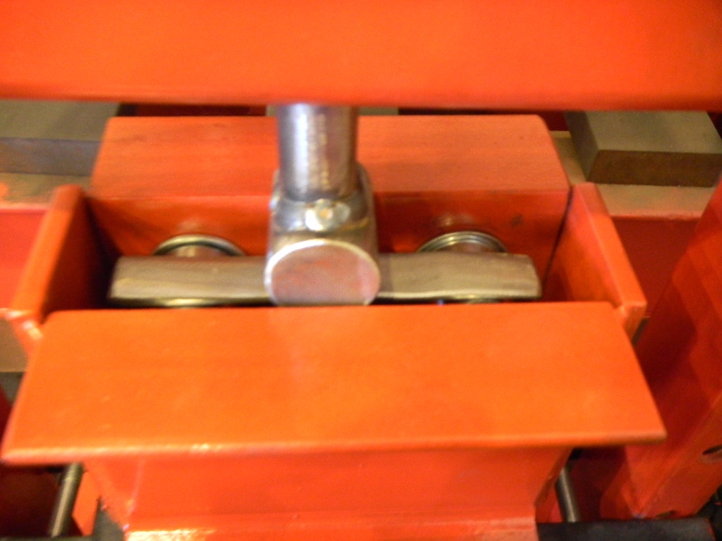

Depending on how far you want to take your learning of welding. In my opinion if you really want to build confidence in your welding you should build a tester! I'm sure you have the majority of the material laying around. You can even borrow the hydraulic jack out of you pickup.
I had a small shop press, I just built an attachment for it, and built a coupon roller.
Model BT1B Weld Bend Tester - YouTube

   / Wet 7018. #57
Nice! I don't have a press, but it's on my wish-list. I currently have an offer out on a fabrication project (building a geodesic dome kit for somebody--no welding, mind you) that if the guy ever comes through on the money, I'm going to use part of it to buy a hydraulic press. The work involves squishing the ends of a bunch of EMT conduit flat, with a curved profile. A hydraulic press is the only way to do it really efficiently.
