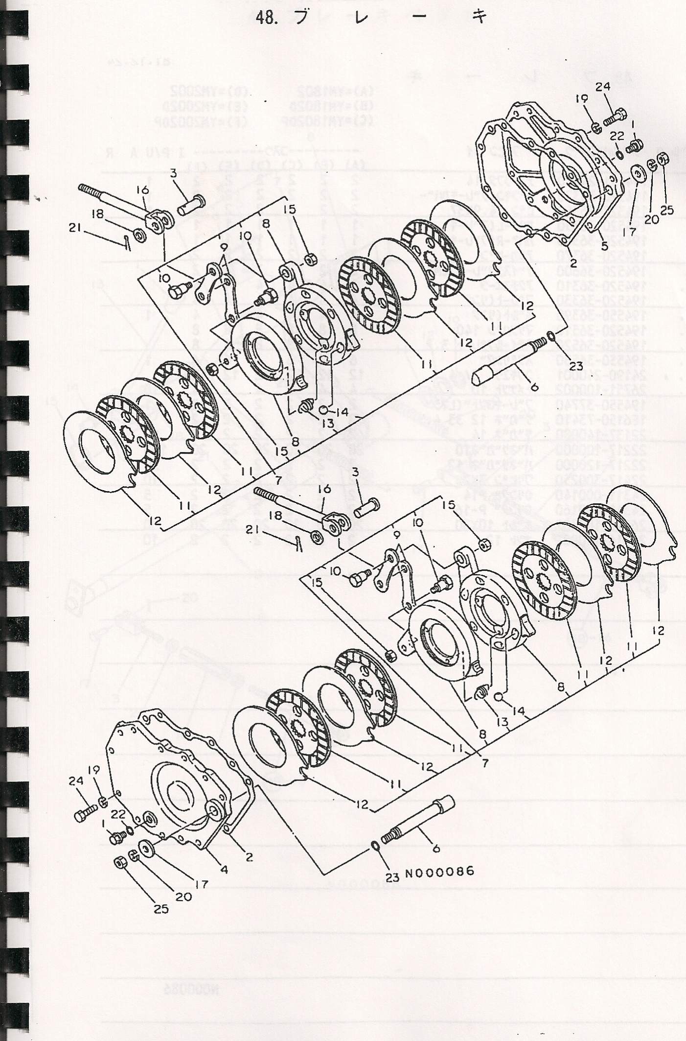

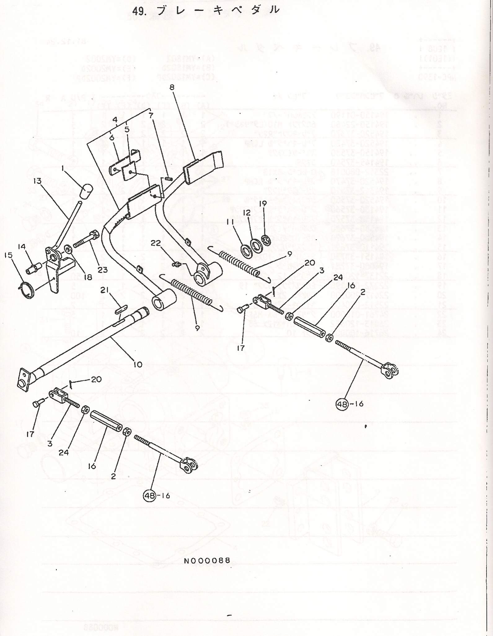

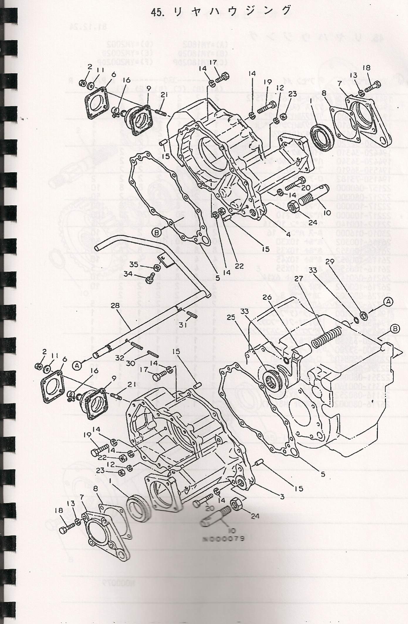

Had a question come up on another Yanmar forum about wet brakes. Knowing there are a lot of curious folks out there I thought I might just post a couple of pictures of an 1802 and 2002 wet brake system.

You have to look at all 3 drawings in post #1 to get the whole picture of where the boot goes. Looking at drawing 49 the boot slides over item 49-16. Looking at drawing 48 the boot slides over item 16. Looking at drawing 45 the boot is item 9 and held on by item 6. The entire brake disc area is lubricated with unpressurized hydraulic/transmission fluid. Best brakes I have ever had on a tractor. I have always been fearful of not being able to find parts. Googling part numbers only brings up the boot. I may have to drag a stick on the ground if anything interior gives way. :D
