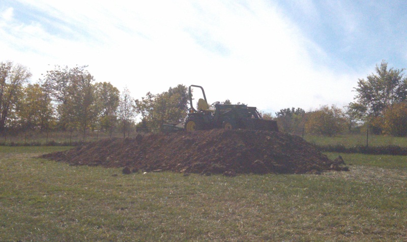

Haven't updated in a while... I wasn't able to do anything on the project for two weeks due to untimely rain and business trips out of town. Got to work on it for a while over the weekend, but not enough. Rain is in the forecast for this weekend so I took a couple days off this week to get some more done. I got the rough cut finished, did a bunch of hand digging right up next to the building, and then did some leveling and polishing with the box blade:
I don't want mess with a retaining wall, so that means laying the side of cut back at an acceptable slope that I can mow it. I started out by tilting the box blade and using it to cut the slope I was looking for. A dozen or so passes with the box blade gave me one 5' wide cut with the slope I was after, but it also gave me a decent crook in my back from running back and forth across the slope with the tractor leaning underneath me. So, I gave up on that approach and started cutting vertically down the slope with the FEL. About the time I got one swath cut down to grade, it was time to call it quits for the day.
No... that's not the sun setting behind a mountain range... that's my spoils pile.

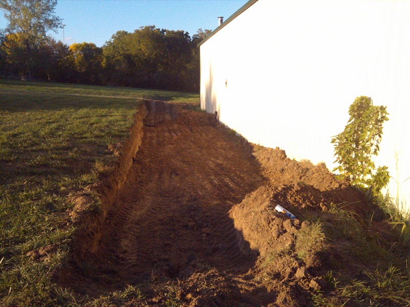

The attached picture was going to mean something... but instead it's just a pretty picture of my tractor on a beautiful day with my man-made mountain range in the background. :laughing: I spent 8 hours in seat today sloping the cut back to a mowable slope. I made 4 passes for about 20' and then I got into some good dirt... that's why I hopped off the tractor to check things out and snapped the pic. I switched up my game plan and began harvesting topsoil to place in a separate pile. Once the topsoil was harvested, I went back to sloping the cut. I got done with one end of the slope with the sun low in the sky, so I spent a little time dressing up what I'd worked for the day. I put the tractor up with just enough daylight left to take a picture of what I got done... pulled out my phone to snap a pic and the battery was dead. So, instead of a before and after... the only pic I have is before. I'll try to get a pic in the morning of the after.

You moved a lot of dirt. Looks like a great job.
Will you need to do anything to prevent erosion or will grass growing back take care of that?
Grass will take care of it. It's a nice gentle slope... about 5:1, or 1:5... however you want to look at it. I can comforatble operate the FEL sitting sideways on the slope, so mowing it will be a piece of cake. I'm going to dig a trench down the level pad along side the barn and bury two pipes bedded in 1/2 inch clean rock... one perforated for a subsoil drain and another tight line to pick up the downspouts off the barn. Both of those pipes will be routed out past the barn and towards the pond where they will daylight. I'm trying to capture all the run off I can and direct it to the pond to help keep it charged. Then the level pad will get graveled and will become a parking spot for my 24' trailer and other "stuff" behind that. I'll dress the slope with topsoil I harvested during the dirt moving and sow some Kentucky 31 fescue. I didn't want to mess with a retaining wall.
