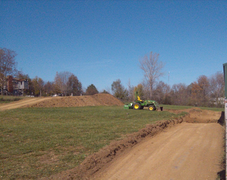

The attached picture was going to mean something... but instead it's just a pretty picture of my tractor on a beautiful day with my man-made mountain range in the background. :laughing: I spent 8 hours in seat today sloping the cut back to a mowable slope. I made 4 passes for about 20' and then I got into some good dirt... that's why I hopped off the tractor to check things out and snapped the pic. I switched up my game plan and began harvesting topsoil to place in a separate pile. Once the topsoil was harvested, I went back to sloping the cut. I got done with one end of the slope with the sun low in the sky, so I spent a little time dressing up what I'd worked for the day. I put the tractor up with just enough daylight left to take a picture of what I got done... pulled out my phone to snap a pic and the battery was dead. So, instead of a before and after... the only pic I have is before. I'll try to get a pic in the morning of the after.

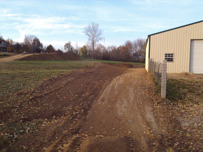

Ok... here's the before and after.
   / What a brute!!!
#57
You moved a lot of dirt. Looks like a great job.
Will you need to do anything to prevent erosion or will grass growing back take care of that?
Grass will take care of it. It's a nice gentle slope... about 5:1, or 1:5... however you want to look at it. I can comforatble operate the FEL sitting sideways on the slope, so mowing it will be a piece of cake. I'm going to dig a trench down the level pad along side the barn and bury two pipes bedded in 1/2 inch clean rock... one perforated for a subsoil drain and another tight line to pick up the downspouts off the barn. Both of those pipes will be routed out past the barn and towards the pond where they will daylight. I'm trying to capture all the run off I can and direct it to the pond to help keep it charged. Then the level pad will get graveled and will become a parking spot for my 24' trailer and other "stuff" behind that. I'll dress the slope with topsoil I harvested during the dirt moving and sow some Kentucky 31 fescue. I didn't want to mess with a retaining wall.
