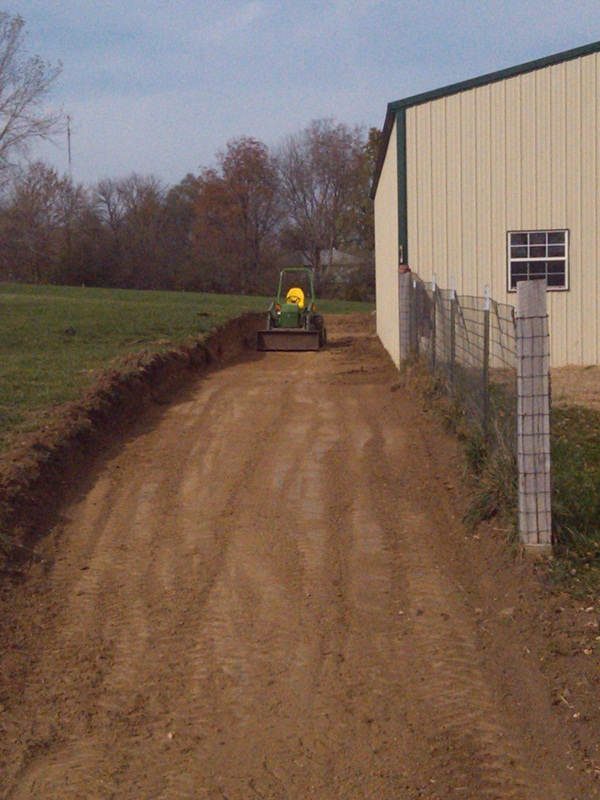

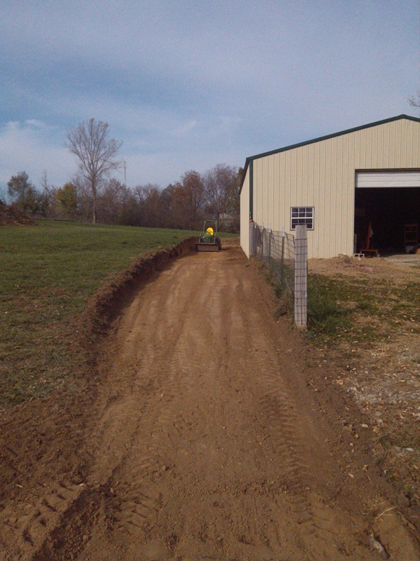

Haven't updated in a while... I wasn't able to do anything on the project for two weeks due to untimely rain and business trips out of town. Got to work on it for a while over the weekend, but not enough. Rain is in the forecast for this weekend so I took a couple days off this week to get some more done. I got the rough cut finished, did a bunch of hand digging right up next to the building, and then did some leveling and polishing with the box blade:

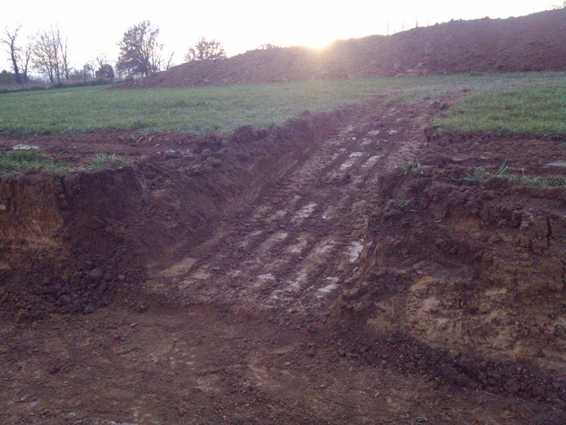

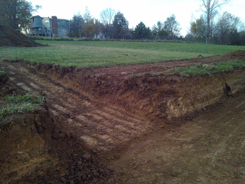

I don't want mess with a retaining wall, so that means laying the side of cut back at an acceptable slope that I can mow it. I started out by tilting the box blade and using it to cut the slope I was looking for. A dozen or so passes with the box blade gave me one 5' wide cut with the slope I was after, but it also gave me a decent crook in my back from running back and forth across the slope with the tractor leaning underneath me. So, I gave up on that approach and started cutting vertically down the slope with the FEL. About the time I got one swath cut down to grade, it was time to call it quits for the day.
No... that's not the sun setting behind a mountain range... that's my spoils pile.

It has become quite the undertaking... but then again I knew it would be. It really needed to be done though. That side of the barn was never graded properly... whoever built it just did a cut and fill to make a level pad and the cut on that side had no drainage at all. During heavy rains and the spring melt after a heavy snowfall winter, the run-off from the slope would run under the wall and across the floor of the barn. During saturated conditions, water would even bubble up through the floor (just an AB-3 floor) and make a general mess of things. I'm wanting to pour a concrete floor, but the drainage issues had to be addressed before I even think about pouring concrete. I also needed a place to park my 24' gooseneck trailer so I can get it out of the barn and free up more workspace.
