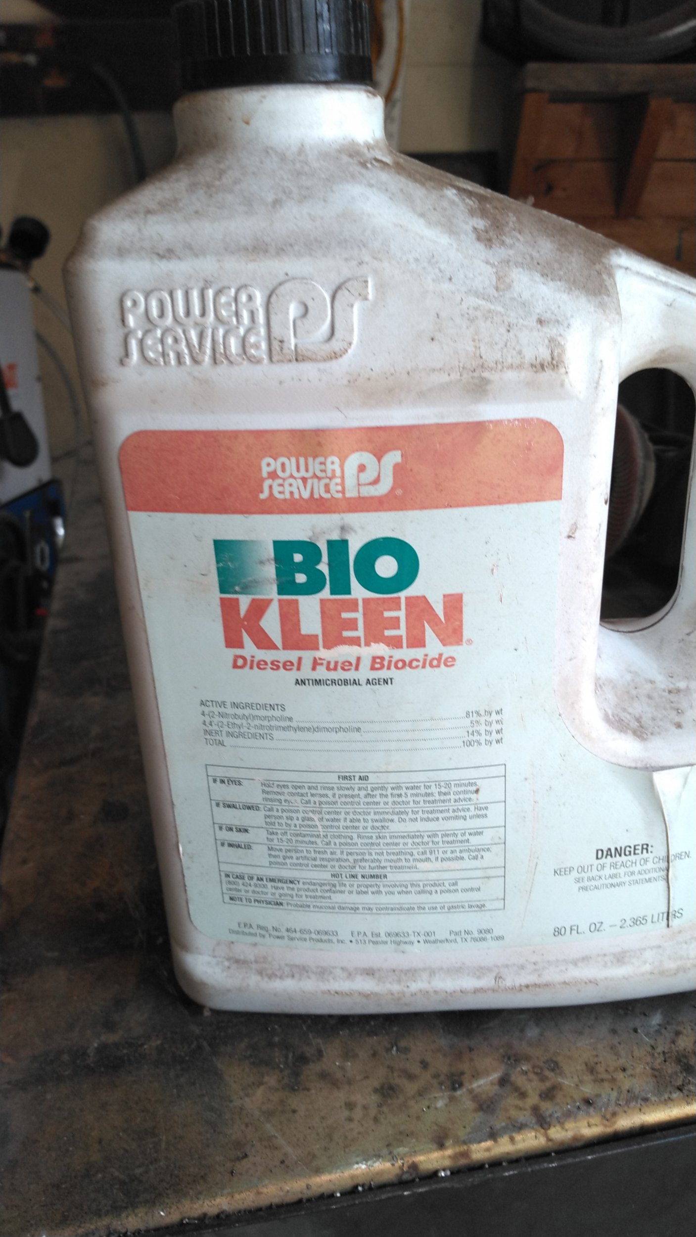

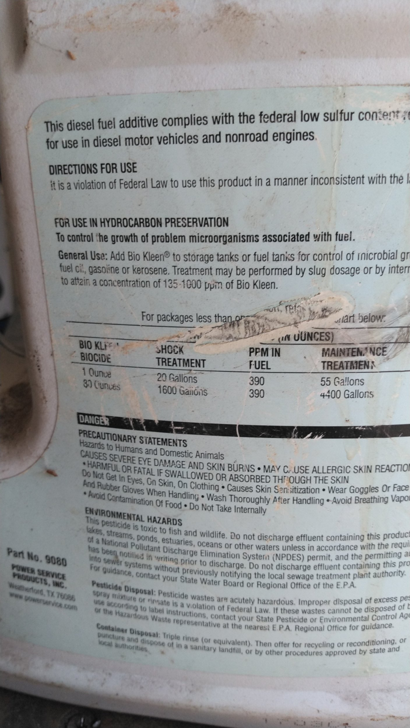

That is me and it ain't cheap either but, a little goes a long way.
My BIL is also a design engineer at Fords and he spent a lot of time at Fords SV operations downriver and he never recommends any elixirs to me.
One thing I did get was a very built '97 Ford Powerstroke from them. He 'borrowed' my truck for a month and they went through the motor and transmission (E4OD and replaced and upgraded everything plus the put a full Gale Banks engineering kit on it and I didn't pay a cent, other than I had to replace the rear tires when I got it back. must have seen some serious dyno time.
He's at Rawsonville at the transmission plant now.
Always thought Stanadyne was in the plumbing fixture business...lol
I use Bio-Kleen and Powerservice because the Freightliner dealer I retired from used it with excellent results and having dealt with the biodiesel algae issue personally, don't ever want to revisit that scenario, it's an expensive fix even if you 'do it yourself'.

Bought extra bottle of PS bio kleen at walmart $28/qt. If youlook at jjeff's photos, post 56, 1oz will treat 50 gal. Used animal syringe to measure out smaller amount for 5 gal cans. got tired of the bs and lifting cans to hood of tractor. Much happier with 50 gal (for me) "bulk tank"
