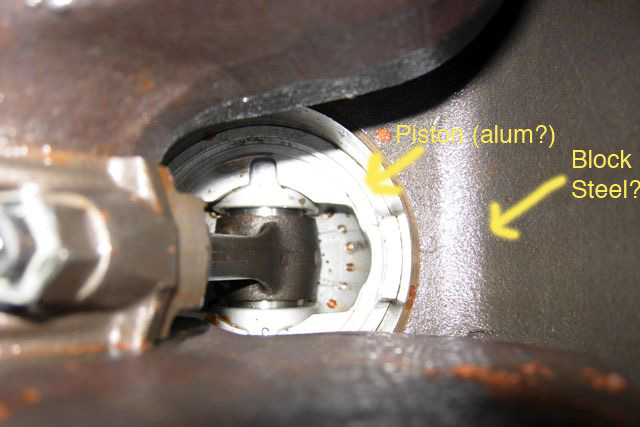

The cylinder walls would be cleaned up with a hone, and if there is not pitting, you could get by with that. I can't really tell from the photos, but to me it doesn't look all that bad.
Good luck!
Thanks. A hone is one of the tools on my list. I should have a much better idea about the condition of the cylinders once the pistons are out. Unfortunately, the "gudge" on the cylinder walls is making it nearly impossible to drive the pistons out through the top of the block. I think I might have to remove the crank shaft and then remove the pistons from underneath :( . Probably time to figure out how to remove the engine from this bad girl too :eek:.
   / What am I looking at? #32
You can estimate that by just looking at the pics? Impressive :cool:. Can I ask how you can tell? Anyway, according to the I&T shop manual the later hundred series tractors didn't have sleeves. Of course the good news is that if I was willing to have the cylinders rebored, I should be able to either find a set of oversize pistons or I could drop in a set of sleeves with matching pistons. Engine rebuild kits of this type seem pretty standard for the 172 Diesel engine.
Thanks by the way. This is definitely the kind of advice I'm going to need. At some point I have to decide whether it's worth it at this point to attempt an overhaul. Obviously, if this block has had it - then that's probably the end of the road for this tractor. . . . :(
Pete
Look closely at the #1 cylinder picture. I think water set in this cylinder for some time. See the dimpling in the reflection from the flash just above the piston? This should be nice and smooth, and this will be hard if not impossible to hone out. Also, there appears to be a rust pit just to the left of the shiny dimpled spot on the cylinder wall, as well as in that band about 1/2" wide about an inch above the piston where the piston rings had previously polished the wall. This looks like substantially more than surface rust to me. It's hard to tell, but it looks like the rust may be worse further to the right on the wall, but this isn't real clear.
Maybe you will get lucky and it mostly surface rust. However, as I stated, the wall looks dimpled from rust, instead of being nice and smooth.

I think I'm following you around TBN danno1. Good question about the block. I know that these blocks did not have "liners" per se and were directly bored, however there does appear to be two different metals (based on color) that comprise the "block" and the "cylinder" (see pic). My engine was clearly rebored larger by 0.02 (stamped on the pistons; green), but the bores seem to stay within the original cylinder, but rebore was not quite centered (red arrow), likely intentional.
If you look at the underneath pic I've highlighted in yellow the piston and block. To me the pistons look like bright shiny aluminum; block looks like steel.
I suppose this really doesn't matter for using heat to induce metal expansion, but it's an interesting thought exercise based on several assumptions (never a good mix). Nevertheless, unless I'm mistaken, if you were to heat the pistons directly, being aluminum they would swell up more so than the cylinders and it would be even harder to get them out.
