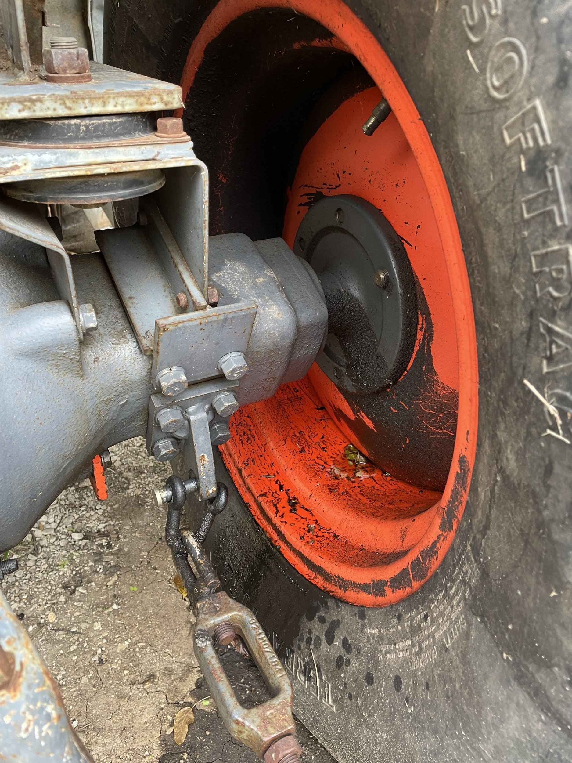

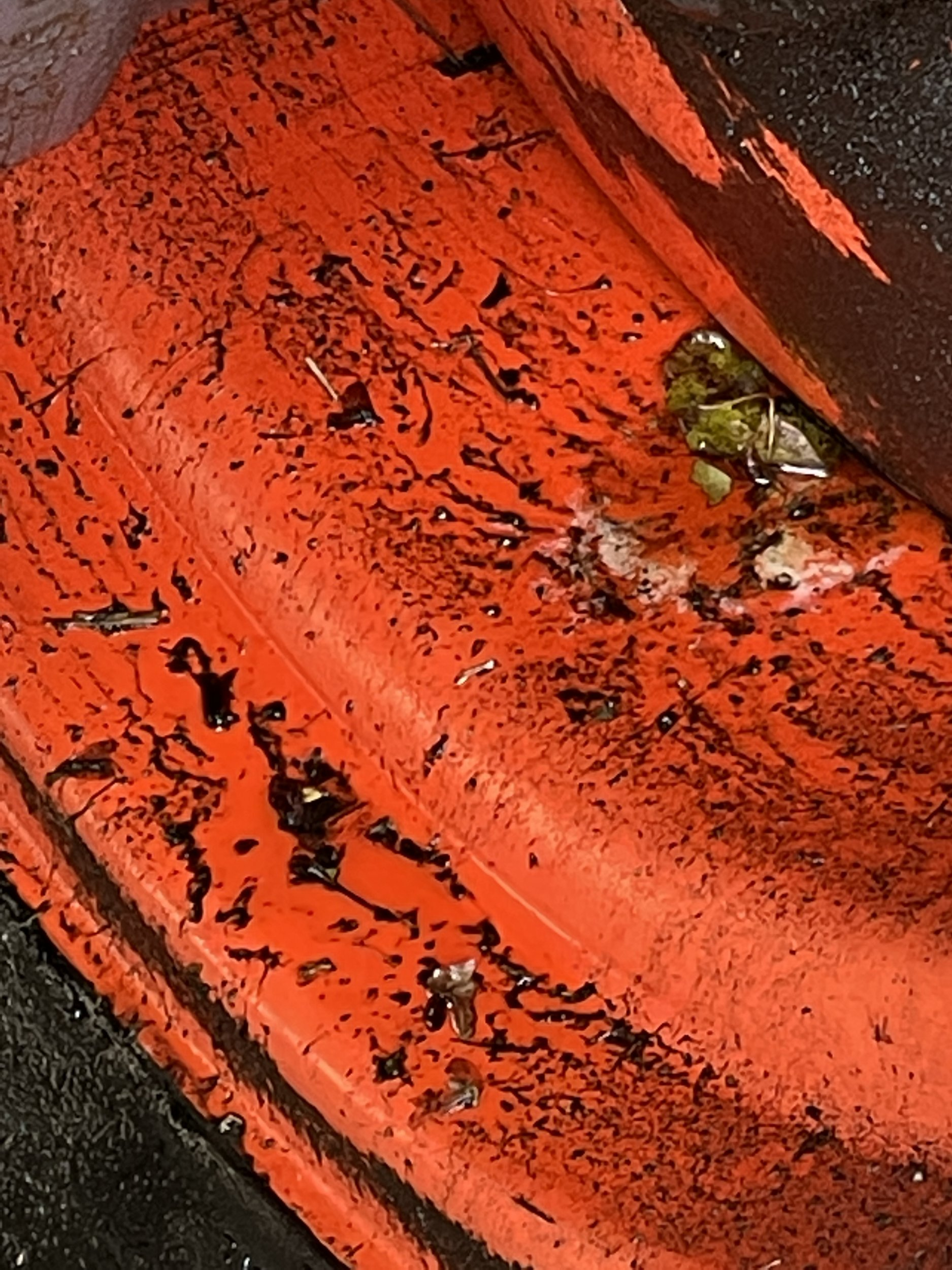

Kubota L4200
OK, looked on the inside of my right rear tire, (Kubota L4200, probably about 25 years old). Is this something I want to tackle myself? I'm reasonably adept with tools, but on the other hand never taken something like this apart before. Are specialized tools needed? Is it simply removing and replacing a seal / gasket? I have to say this has been a pretty good tractor for me, I've owned it for 20+ years and not many problems.
/ What am I looking at? #3
IS there a large nut holding flange to axle?.... If not it may require you to remove a large portion of differential housing and it may be a major project...
A manual with break down of assembly would be really revealing....
/ What am I looking at? #5
Short answer is it's a major job. You have to tear into the rear end to get the axle out
From the condition of the Clevis on rt side lift arm, I'd recommend taking it to a mechanic.
That clevis has nothing to do with it. The pin is just a little large for the hole and I really don't use the lifting arm for anything anyway. It is just in there to keep things from dropping and wearing on the ground. I'm concerned about the oil I see on the inside of the tire rim.
/ What am I looking at? #8
It needs an axle seal, usually the bearings are fine and the seal has been taken out by vegetation getting wrapped around the axle or a pressure washer cutting a seal.
Occasionally a wheel bearing goes bad, neither repair is that difficult on most tractors it can be involved but not real difficult.
If it is juist a seal the other option is to just top of the hydraulic fluid as necessary.

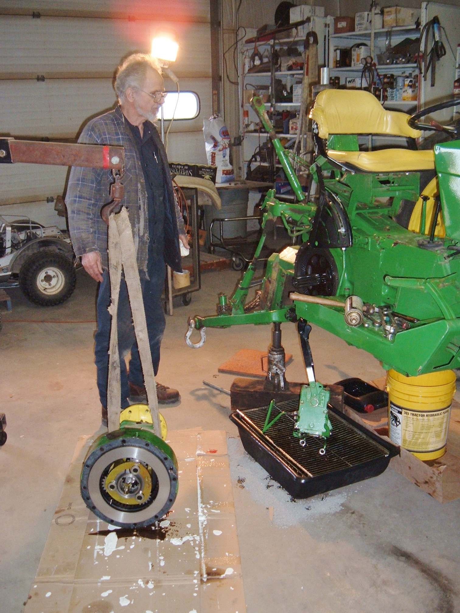

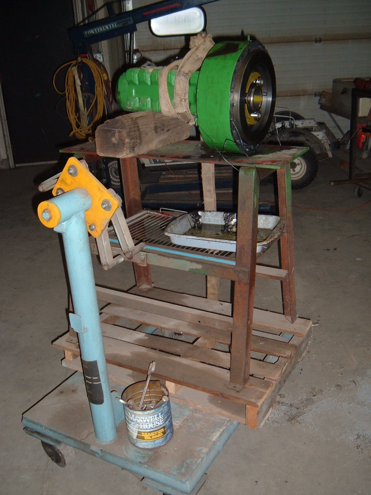

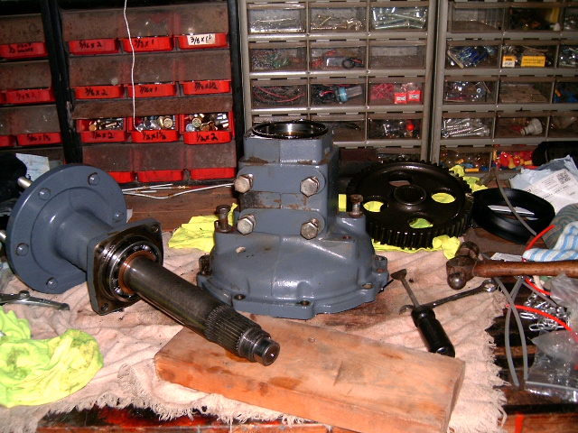

/ What am I looking at? #9
Its kind of routine.

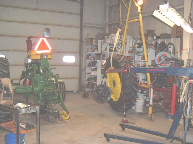

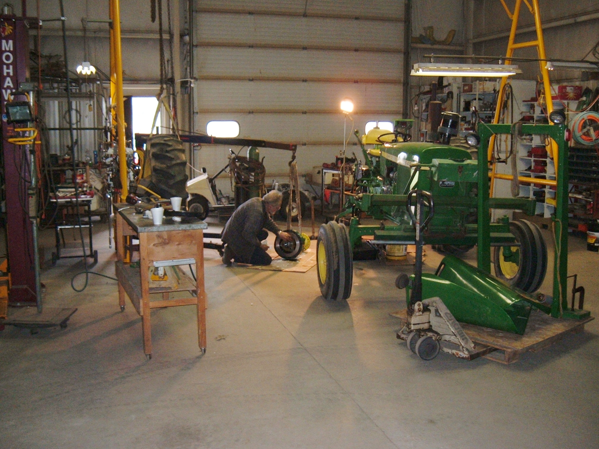

/ What am I looking at? #10
Washed up before repair.
/ What am I looking at? #11
Looks to be an axle seal replacement. Often the bearing is good. Sometimes seals just give up.
I'd start by looking in a parts book. You can usually use the exploded diagram to tell how to approach the seal. On most tractors that seal involves taking the rear end apart enough to loosen the axle so it can be withdrawn. The seal actually goes on from the inside.
A simple job, but a heavy one & with lots of bolts to deal with. Lots of grease and not a few gaskets.
Try to figure out where the axle sits relative to the fill line on the dipstick for your rear end fluid . It may well be that you can run it as is with an occasional topping off for years for chore work while you decide what to do.

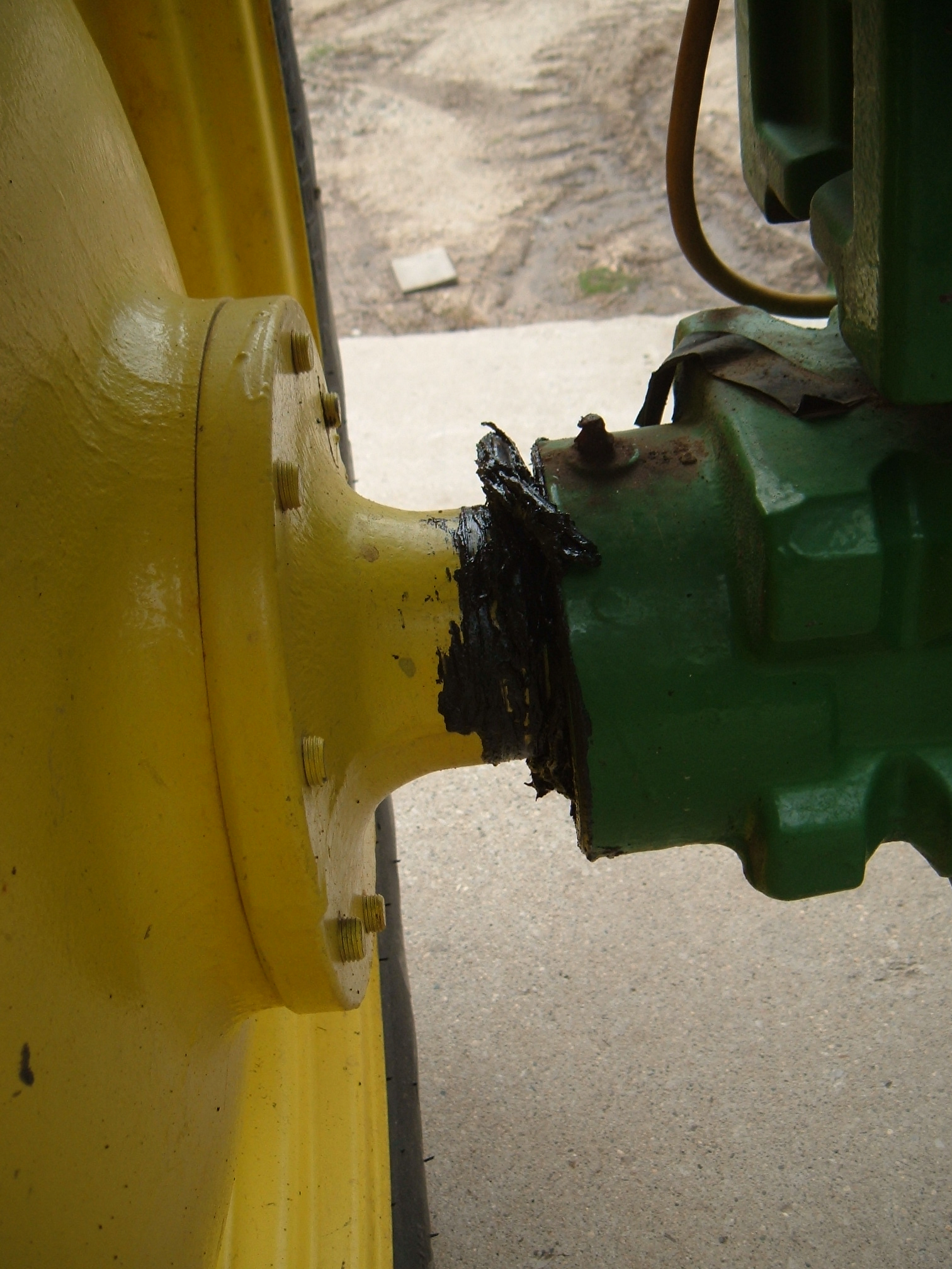

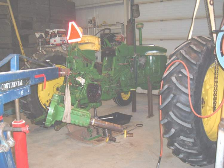

/ What am I looking at? #12
An axle seal isn't that bad of a job.
I did one a couple years ago on my machine.
Some parts are a little heavy is all (my rear tires are loaded, but it wasn't a problem)

/ What am I looking at? #13
Make sure you don't have a clogged vent first. A common cause for leaks is excess pressure.
