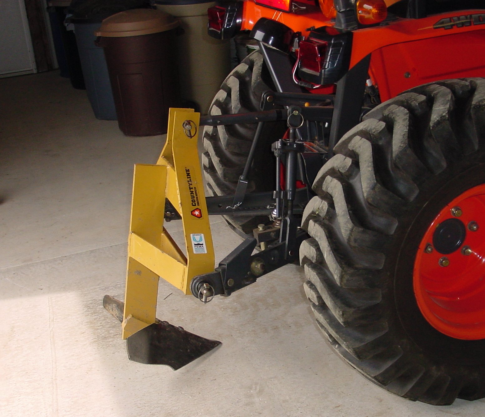

This is what you can do with the potato plow AKA Bottom Buster but it will not make for the great seed bed for garden as Bird mentioned above. You'll need to till to get a good seed bed started like on the second pic. For the price it is a great tool and can take the load off of your tiller plus a few other general uses around the farm.
JC,
By the way it take a lot of tractor to pull this beast deep in the ground. I do have issues with my turf type tires. I loose traction long before loose power. What size of tractor do you have? do you have ag tires?
Time tp resurrect this thread. ;) I purchased one of these this week, thinking it would be useful to begin working the old field I had reclaimed last fall; but all it does is ride across the top of the soil. Looking at JC's pic it seems like the bracket for my furrower was welded on at the wrong angle; mine is only about 10 degrees from perpendicular to the down piece, and the bottom of the furrower is parallel to the ground. The other one at TSC was the same way.
I tried to include a pic, but my phone isn't "TBN friendly" :(
Anyone else bought one of these recently and had similar results?? (I really need a plow and harrow, but those aren't in the budget until fall.)

Can you post a photo? Have you tried adjusting the top link?
Bruce
   / What are sub-soilers and middle busters used for? #20
It can be hard to get a bottom buster to bite in hard soil. You may have to fiddle with your top link to get the right angle. See if you can get a picture to us.
