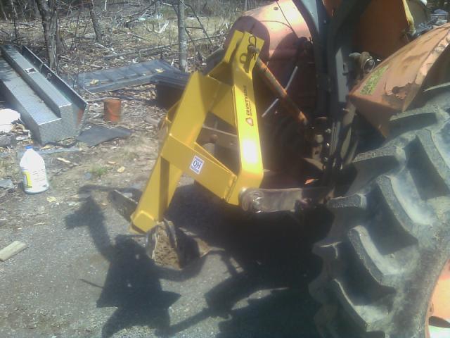

That's the best I can do. When I took it off and set it on the garage floor it set upright on it's own... the bolts and subframe are lower than the furrower.
I could be wrong, but it seems that the plow point should be lower than the rest of the implement?
In order to set the toplink any shorter I would need to adapt a lighter link to fit.
The ground I'm trying to work was just stumped with an escavator last fall... my backhoe loves it but it's a mighty slow process, working up 2 acres with it ;)
If I'm just asking too much for it that's my fault; if it's poor design than
I'm not afraid to return it.
I look at JC's picture then at mine; I think I see the problemwith mine. (plus the "Made in China" sticker on the bottom.:()
If you have a category 1 3pt, I have seen that a shorter top link is available.
I can't help but wonder if you have a sub-soiler shank with a middle buster blade on it. They should be different angles.
I have seen advertisements where they are selling both types of cutter, sub-soil and middle buster cutting blades to use interchangeably on the same shank. But I wasn't able to tell if the angle was different from either of the other two dedicated tools.
Maybe a shim under the top bolt to change the angle ?
Good luck

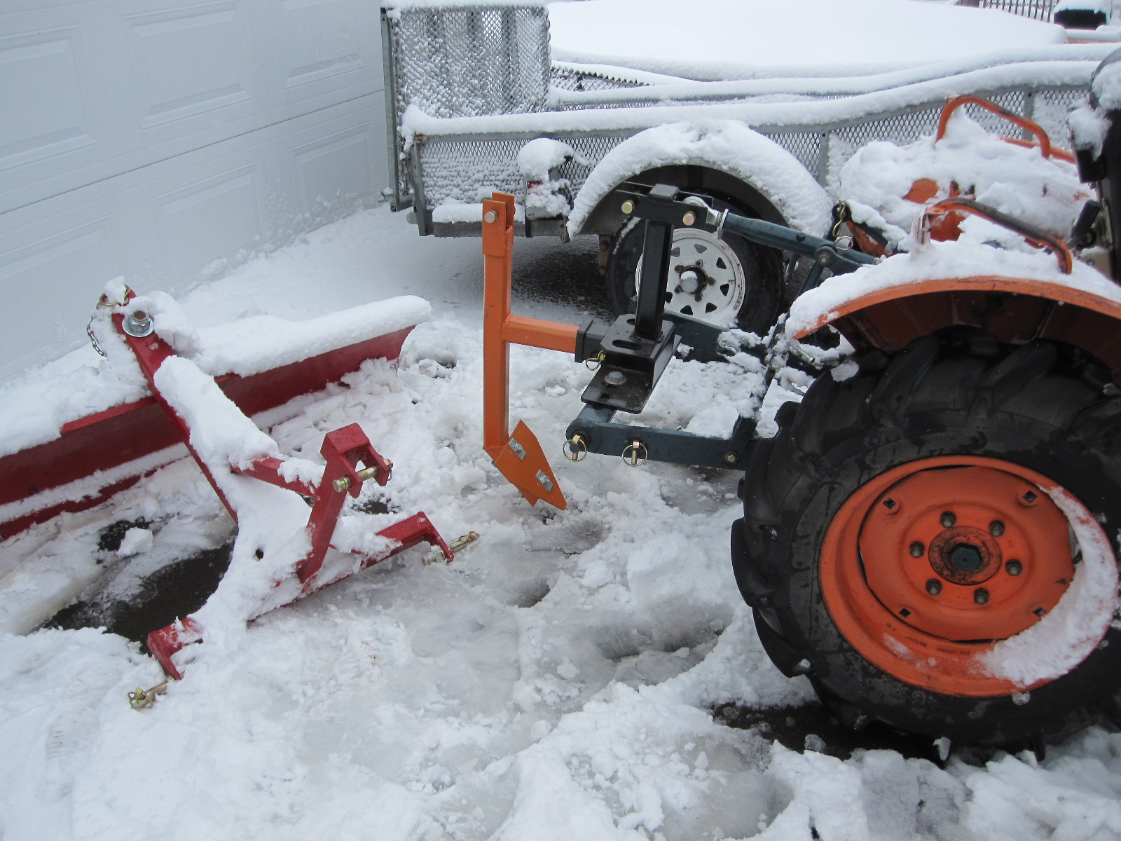

Major wrong angle on the 'middlebuster' photo you posted. It will never do what you need, with the way it is designed.
As you can see by this one: CountyLine Middle Buster - 2128228 | Tractor Supply Company
You are correct about the angle being much different than what you need. The implement is also called a 'potato plow'.
EDIT: and the post you quoted with the pic, that is still the wrong angle for the implement..........the long yellow bar on the back should be at a 90 degee angle to the ground( in other words....straight up and down).

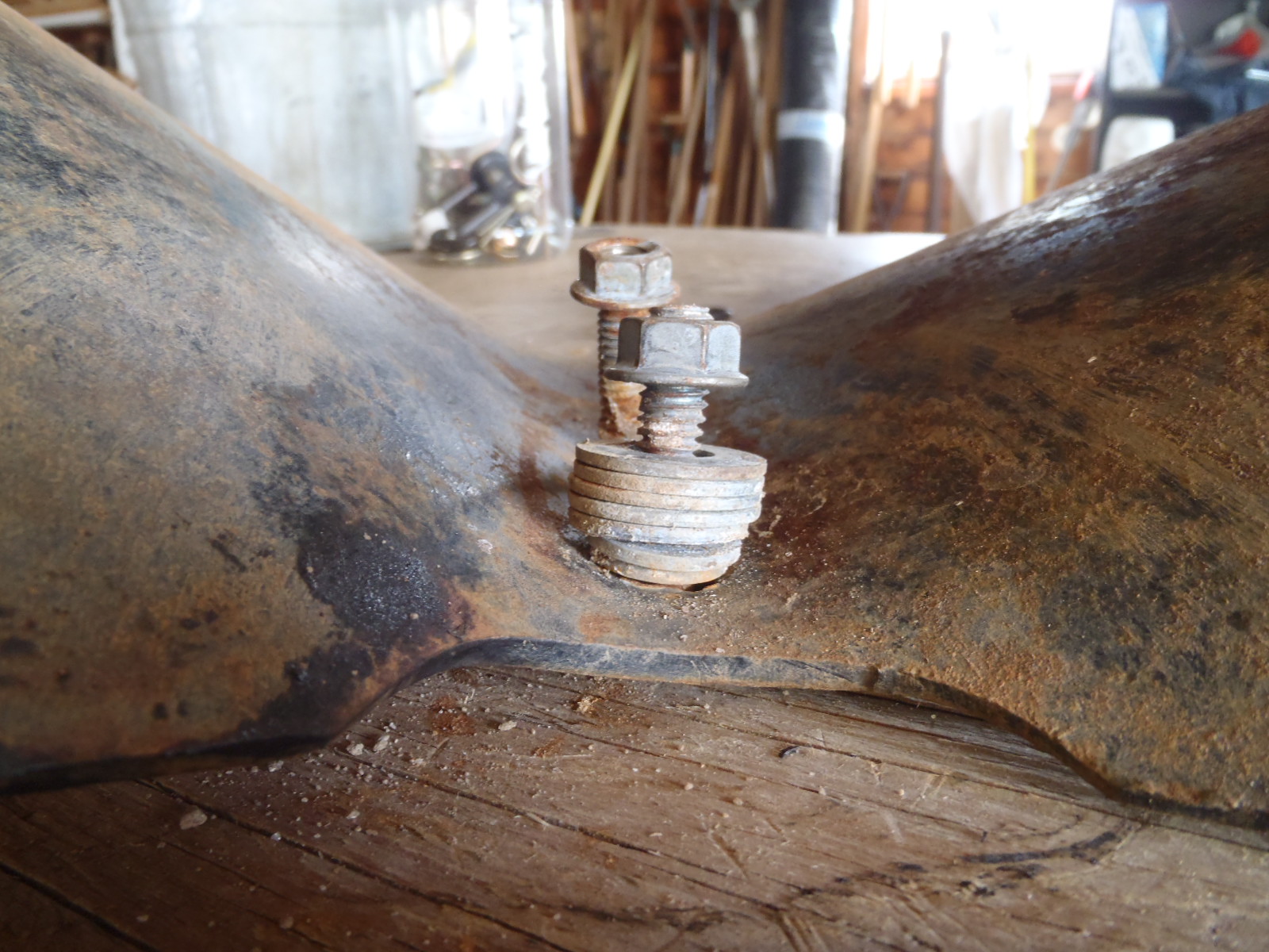

]Yup - to use the middlebuster (potato plow) on the subsoiler shank, you will need to shim it to get the bottom edge level with the ground. Here's how I do it:

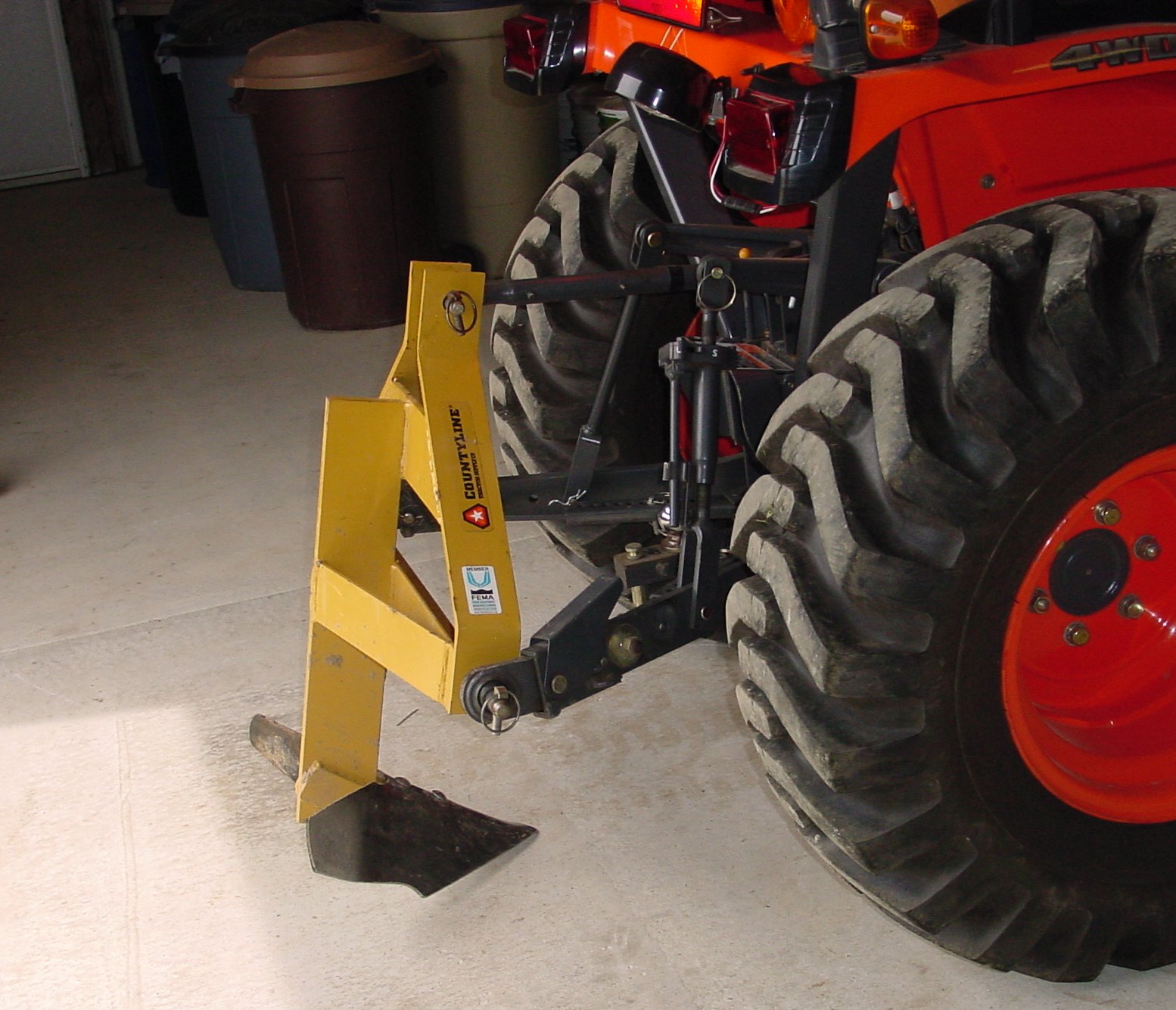

I think I have the same problem. On TSC's website I compared the pictures of the sub-soiler and the middle buster and there is a definite difference in the angle of the shank. I am pretty well convinced that Jstpssng (and myself) recieved a middle buster blade on a sub-soiler frame. Here's mine:
I have tried shimming the rear-most bolt with washers but that causes the bolt holes to get misaligned so that the carriage bolt on top of the blade does not mate with the squared off hole. I think a longer hex bolt instead of a carriage bolt would work but I have not tried that.
I am able to compensate for the too-shallow angle by shortening my top link to its absolute shortest length - about 17 3/4 inches between the pin holes. I would like to go shorter than that but I cannot find a Cat 1 top link that is shorter than the one I already have.
When I first broke the ground for a new garden with the MB, I had to apply weight to it at the start of each pass. On subsequent tills of the garden (6 months/12 months later) I had no such problem, just the first. I also keep the 3pt hitch drop speed knob plenty loose so that the blade reaches its lowest position as soon as possible.
Does anyone else think that TSC has things a little mixed up in their stores?
I went this route, and it works much better. I'm hust a little slow to alter any new purchase until I'm sure I'll be keeping it.
I have the same length top link as Von-Mil although I may eventually weld up something shorter, plus add a little weight as he suggested. Right now the shallow draft works well for my purpose, as it exposes buried roots without tearing them apart.

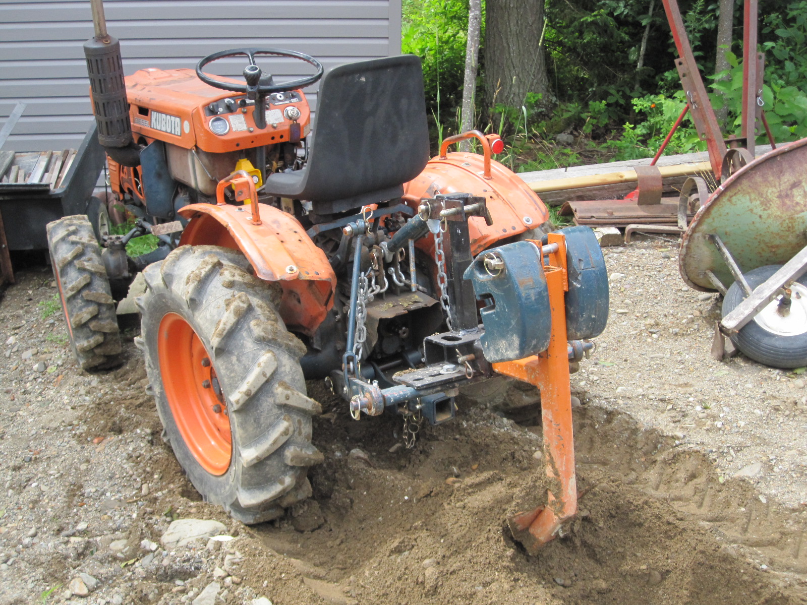

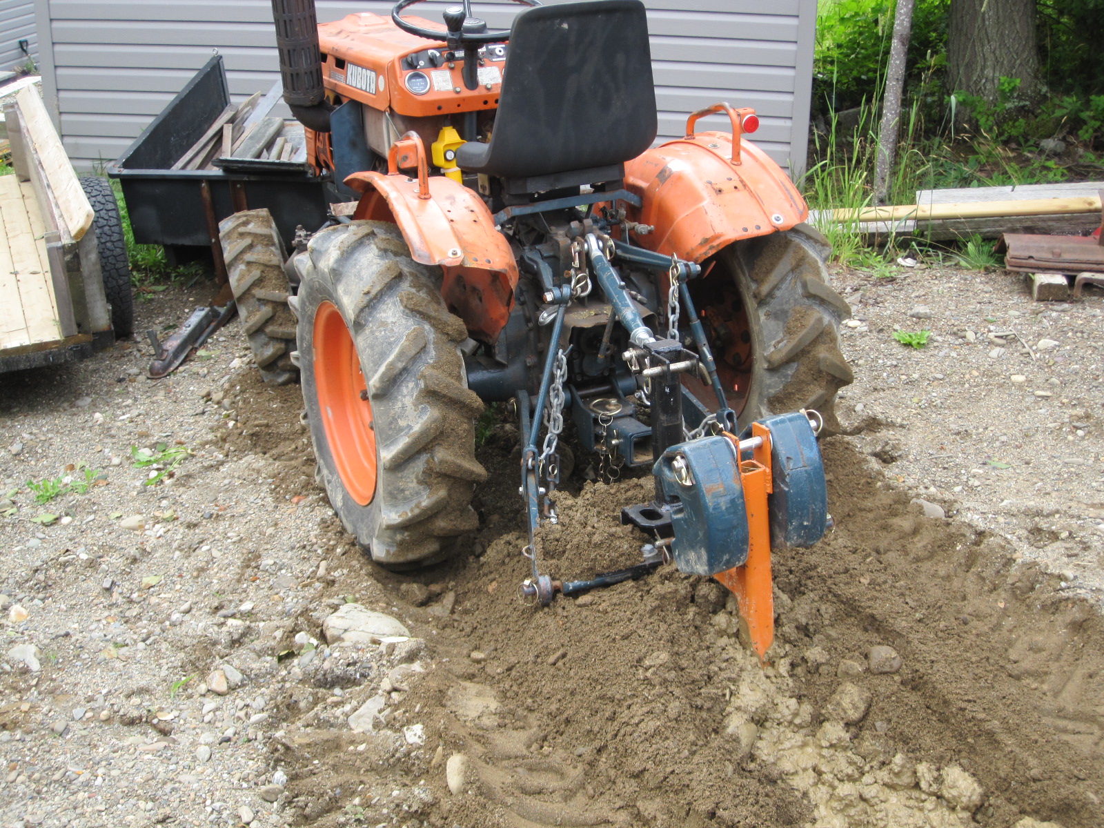

I made a middle buster/potatoe plow to use with my 1980 B7100. 1st blade was a triangular plate of 1/4" mild steel & it worked pretty good but required multiple passes on sod. I found it worked better with some weight (wife standing on draw bar as a test) so adapted my suitcase weights from the front bumper. I have since picked up a 30 yr. old Troy-Built tiller & it came with a furrowing attachment which is identical to a real Middle Buster blade. I mounted it on my hand-crafted contraption & it works good - my drawbar drags on the ground when using it in the garden. Haven't tried it on sod. Used it last weekend to turn over my garden at the cottage & bury rotted cow manure I spread on it last Fall - weather turned wet & couldn't do it then. My contraption really works well digging up the potatoes.
