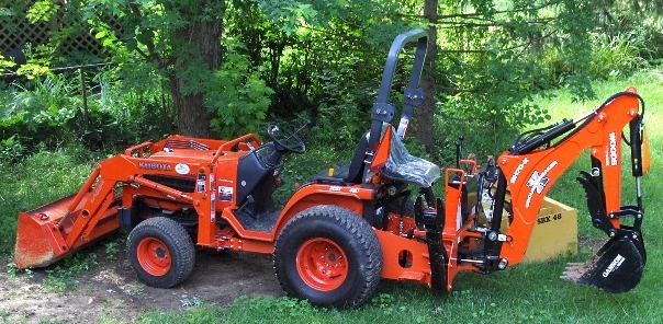

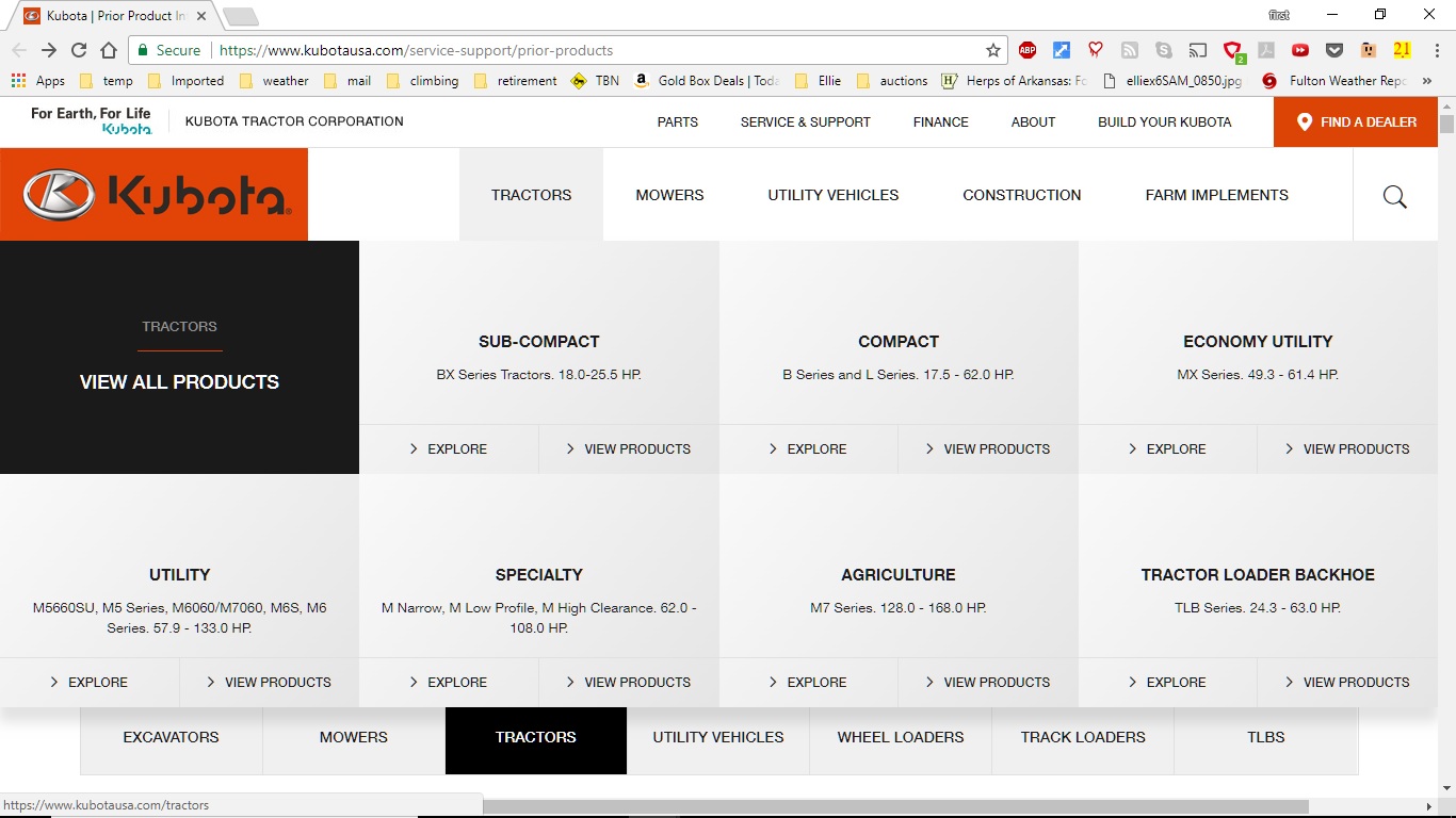

By Kubota's separation of classes Compact tractor covers everything from 17.5 to 62 HP, which entirely overlaps both their Sub-compact and their Economy Utility.

A subcompact tractor can be anything from 15 hp to 26 hp in today's standards.
It typically has up to a 6 or 7 inch undercarriage clearance
It typically is no wider than 54 inches at the rear wheels
It typically is a 3 cylinder diesel engine and a subcompact typically has a hydrostatic transmission and both a mid and rear PTO.
Because of its ground clearance - it has smaller tire/wheel combinations and its weight without fel or backhoe is typically under 1700 lbs
A Compact generally has 7 to 12 inch ground clearance, anywhere from 25 to 60 hp and is wider than 52 inches and heavier than th 1700 pounds without fel or back hoe.
A Compact may come in hydrostatic or gear transmissions.
Large compact and utility tractors (in my opinion) are typically 65 hp to 125 hp. They have large wheels and tires and clearance in the 13 to 18 inch area.
They are normally wider (60 inch or larger).
Ag tractors are everything else LOL - big and biggest.
Myself - I find a 25 hp scut to be all I need except if I were doing rough terrain activities - like brush hogging rough farm land or working in woods or lifting big weight (above 900 pounds with a fel) or dragging around farming equipment like big plows and cultivators and row cropping implements.
