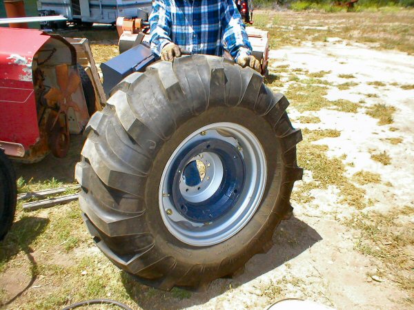

I was looking at the MX5200 and Grand L 5460 and 6060 as my very first tractor. Never operated one before. I decided to listen to these guys and go bigger, I ended up with an M7060 and glad I went with that. It's a little light for plowing or discing, only maybe because I have R4's, my tires spin. I would love to see how it works with R1's. I can't have cast centers with the R4 rims, they are different . I can only add the 103 lb bolt on wheel weights, 3 per side...Will 600 lbs make much more of a difference? I don't know, but to do that it'll cost me a grand. :( Should have got those when I ordered, they are cheaper.
Are your rear tires loaded with fluid? That really makes a huge difference.
   / What are the general rules of tractor sizes? #32

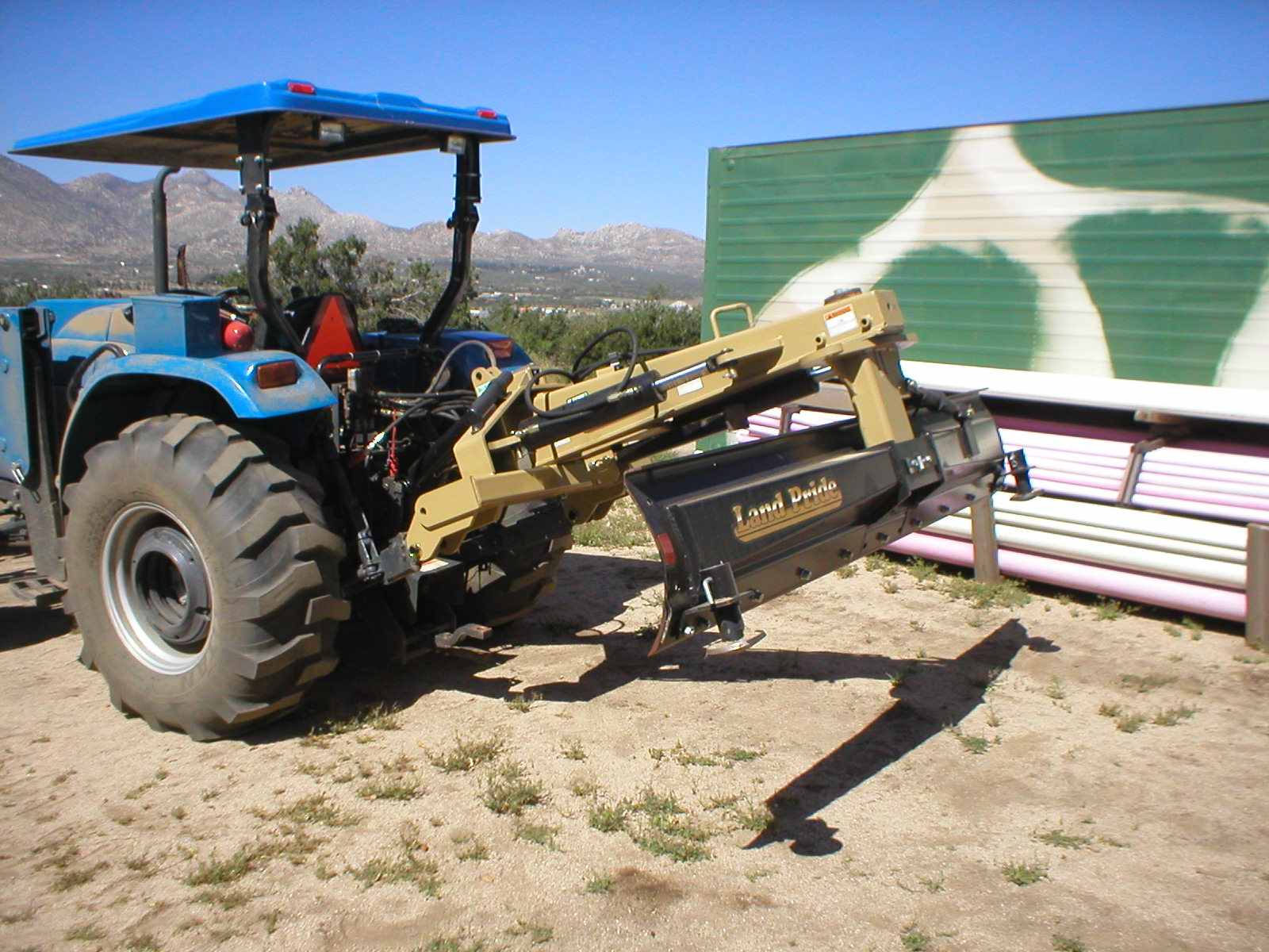

I went with cast iron to start with, then added more cast iron, then filled all 4 of my tires, then added more cast iron. Finally got the traction that I needed-wanted. :thumbsup: Ended up adding 2200-2600lbs, I forget now. :eek:
Not only is filling the tires now my first recommendation for added traction and stability, but in my opinion the ride is BY FAR BETTER than just having air in the tires.

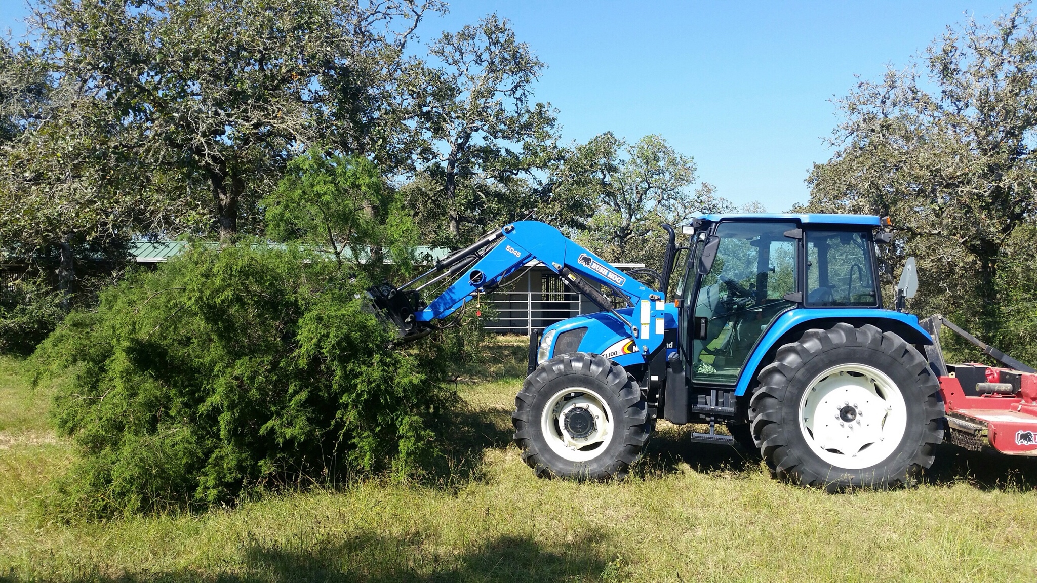

I added fluid to all four tires of my 32hp tractor, got the gross weight up to 5000lbs. Now instead of a cute little machine that struggled doing difficult dirt jobs, it actually works up to it's actual HP capabilities. :thumbsup:
My comments are based on what has worked well for me with what I have and work with.
Just my :2cents:

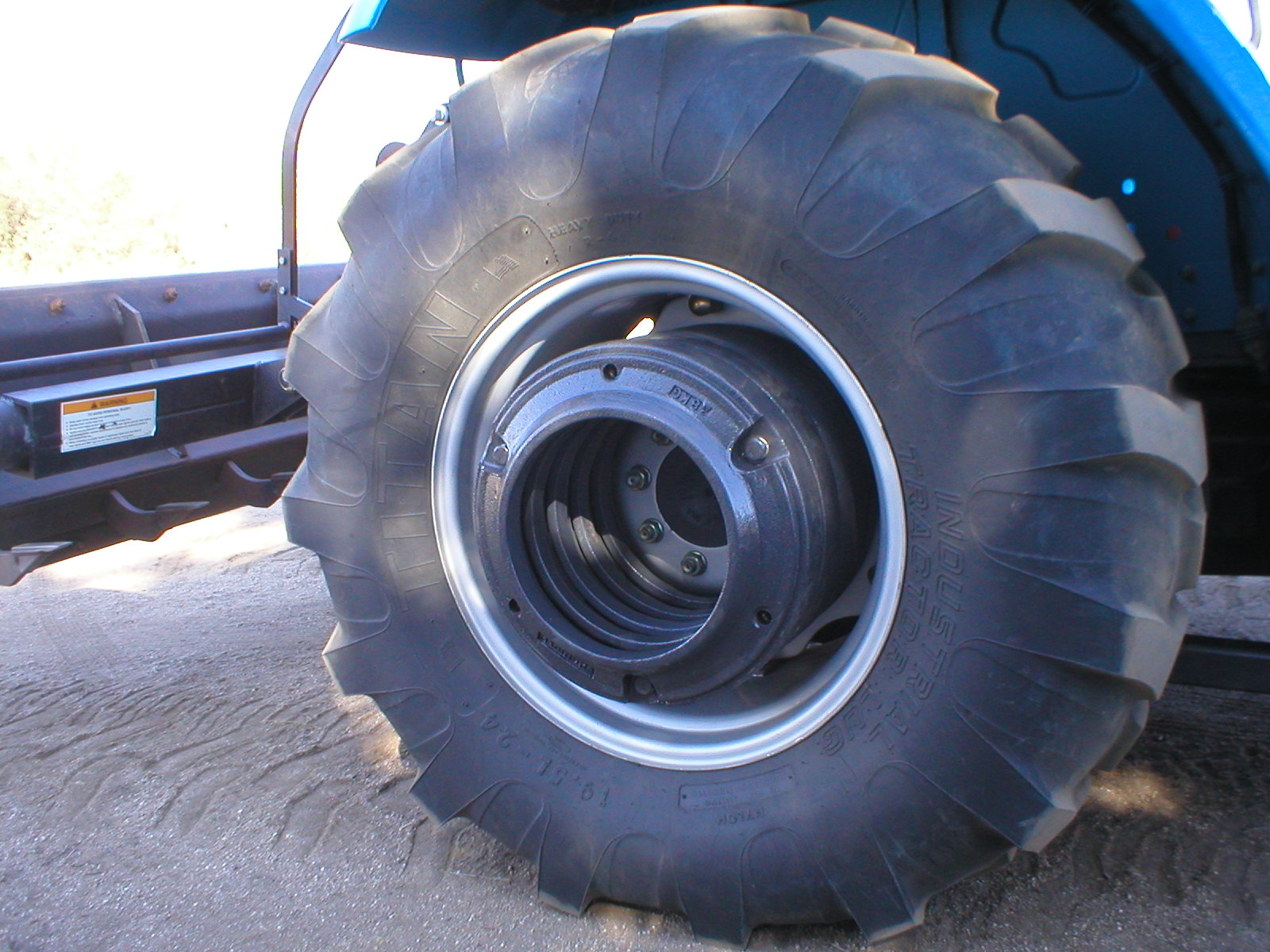

Brian, did you have to drill your wheels to add the first (inner) weights? My wheels only have holes for lugs.
I assume, once the inner weight are installed, the rest just bolt to inner weights? Mine rears are loaded with water and some RV Antifreeze.

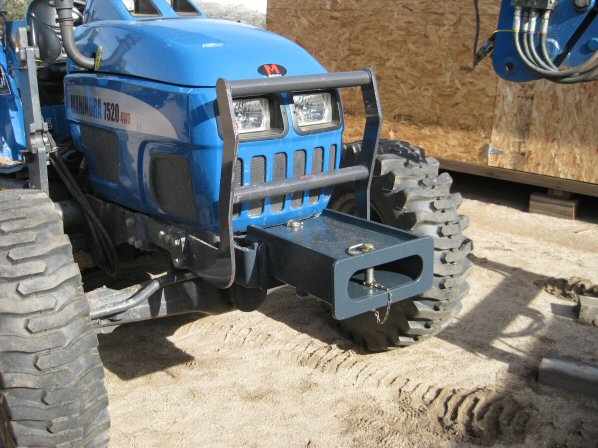

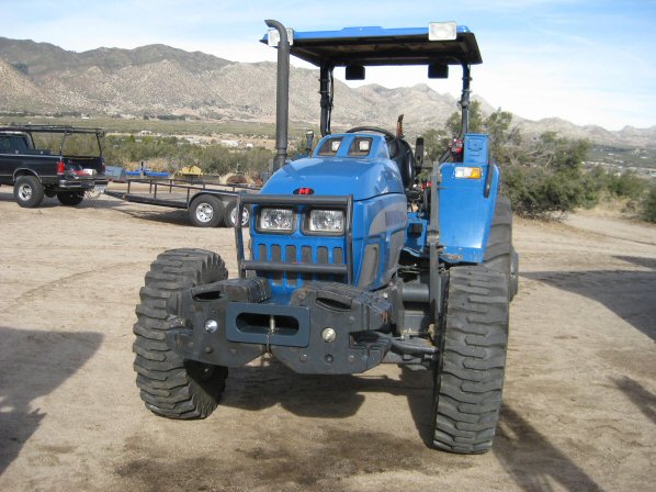

Rick, actually the inner weight and the first outer weight are bolted together sandwiching the rim using existing holes intended for this exact application. Then you just start stacking (bolting) one weight at a time.
The first year of this model came with 2 sets of wheel weights and a set of 8 front weights. I doubled up on the front weights and tripled the rear weights.
The pic that has to be clicked on shows the single set of front weights and the rears with 4 sets on at that time. More weight was needed so that I can get full capabilities from the machine.
