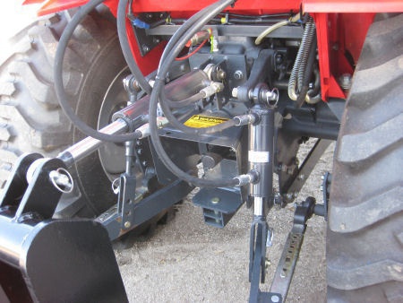

Brian I hope you don't mind a borrowed this picture.
Top and tilt looks like this
One hydraulic for top and one hydraulic for (side) tilt

telescoping lower links with pin type stabelizers vs turnbuckle
If I'm planning on putting after market quick connect on, do I need the above items?? Will I still want the 2 remotes for the top pin and the one side??
If your are going to get a quick hitch and have all quick hitch compatible equipment you don't need telescopic stabilizers or lift arms. I think the telescopic stabilizers are stronger than turnbuckles in most cases. A TnT with a quick hitch makes it very easy to hook up to an implement even on unlevel ground. A TnT is great for making adjustments to the implement on the fly.

Well it's done. They called and said I can pickup the tractor tomorrow. They have the SSQA FEL on. But I don't want to take it until I make a decision on the remotes.
I asked the salesman for cost to add 2 rear remotes and 1 for the loader. Here's his response: "2 rear remotes would run $1,575.00 Kubota does not have a 3rd Fuction Valve I need to do some research for the best way after market."
But another tractor owner pointed me at Fit Rite Hydraulics. And my tractor is listed for the top and tilt kit they can manufacture. For between $665 to $810 depending on the cylinder size you choose. But I don't know if that includes the top and side links. Would I be better off doing this myself?? Or pay almost twice as much.
I'm very mechanically inclined. In high school I rebuilt my '69 Z28 Camaro. Would I be able to install it myself??

Fit right hydraulics will build u a kit and install is a breeze. Kit includes the cylinders and hoses. I believe he can also hook you up for your front hydraulics with a diverter. This means you push a button and it diverts your loader valve to your front grapple. Let go of the button and your loader works as normal. Usually don me off your bucket curl valve. So push button and operate your loader joystick for curl and it will divert to your grapple. Let go of button and you curl your bucket like normal. This install is a little more involved but still fairly straight forward.
A diverter is different than a true 3rd function and that is more involved and a little more pricy. But it gives you true independent valve function with the lush of a button.
Now the remotes. That price sounds about right. You want the float function. You can save a ton by buying all the valves and hoses and piecing it together. Install is more involved as you have to tap into your hydraulic circuit correctly.
