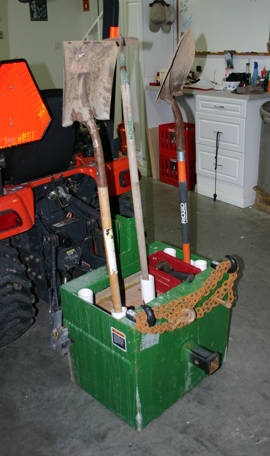

I used a JD ballast box and concrete put in 2" pvc as sleeves, very heavy

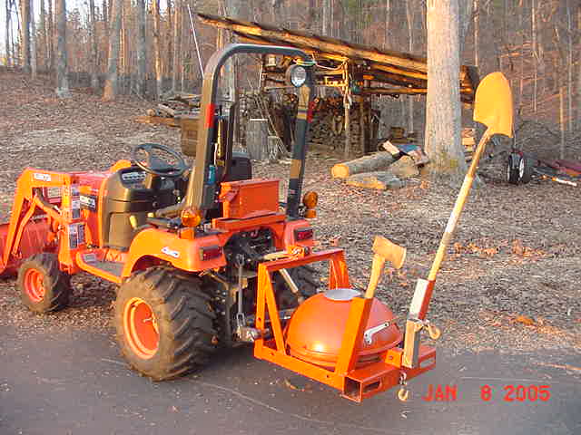

I made a carrier for two 150# tractor wheel weights. This allows me storage room on top for chains, tools, etc. To cover the top, I used an old grill cover.
Vertical tubes allow for carrying shovels, and long handled tools.
JD
