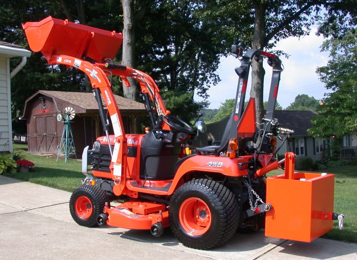

I built my weight box and empty it weights about 125 lbs, then I added 4 -60lb bags of cement. With the tubes added I still have about 8" open on top to use for hauling stuff or I can add sand if needed then remove the sand when not needed. So far I have not needed any extra weight. I made a small dolley with 4 wheels to set it on when not in use, this worked out good it is easy to move around and hook-up to the tractor.

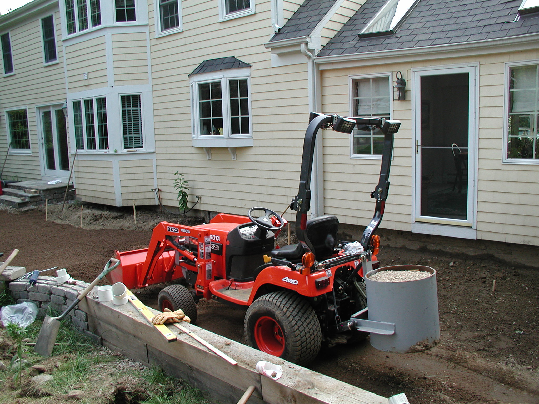

I used a 20 inch piece of pipe and had my buddy welded up some angle pieces to make it work with my 3 pt. Placed large chunks of concrete in it and filled the voids with processed stone / sand. Weight ~500lbs and yes it make a world of difference!
