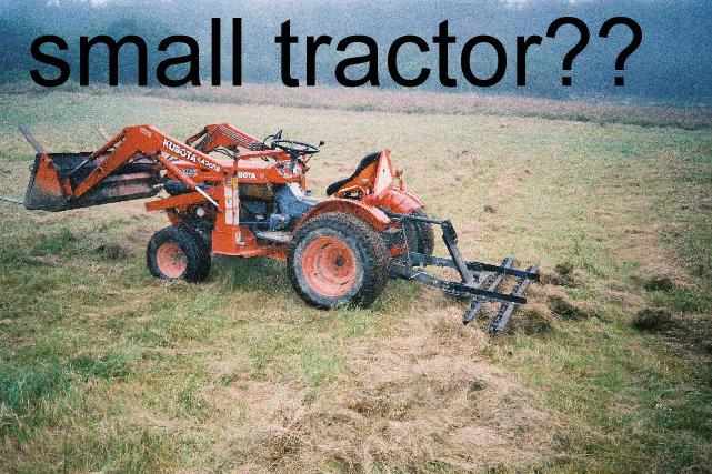

Make a rake for the three point hitch using pickup tines.
I made one up a few years ago and it works quite well. I can rake grass that has been cut with a finishing mower with it.:D
