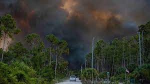

This question is best asked with some accompanying pictures. Are you clearing 2' diameter trees or blackberries?
Whatever the fires left behind..

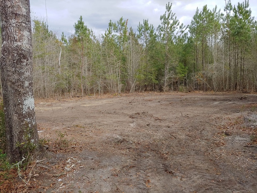

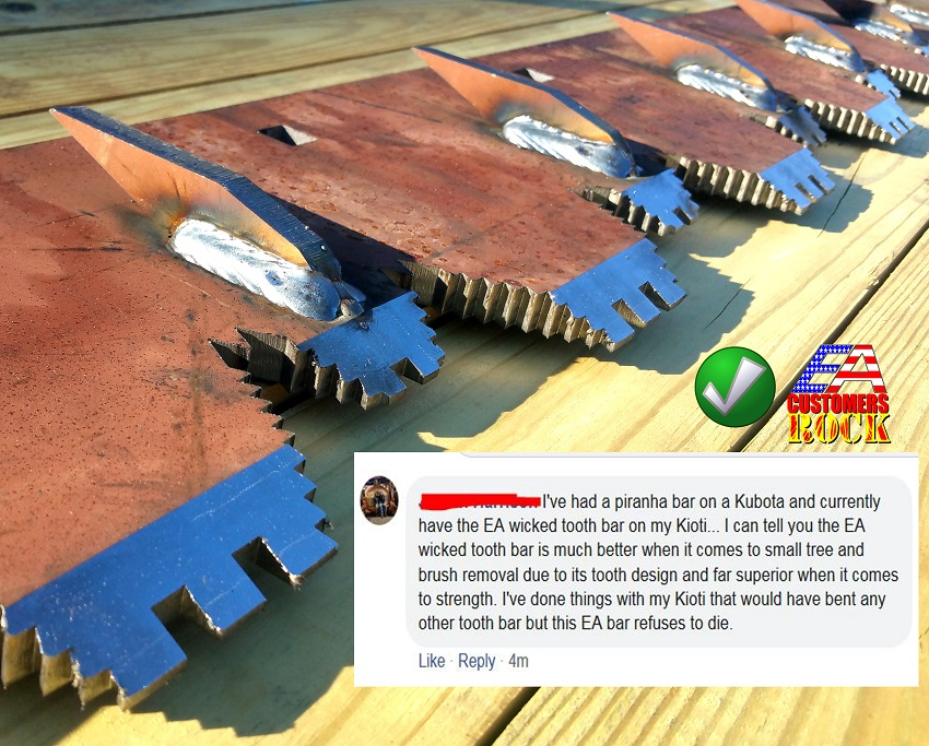

Wicked Toothbar is a very reasonable addition to greatly strengthen and increase your bucket's ability to push over and rip up rubbish. I'll provide some visual feedback from customers!
