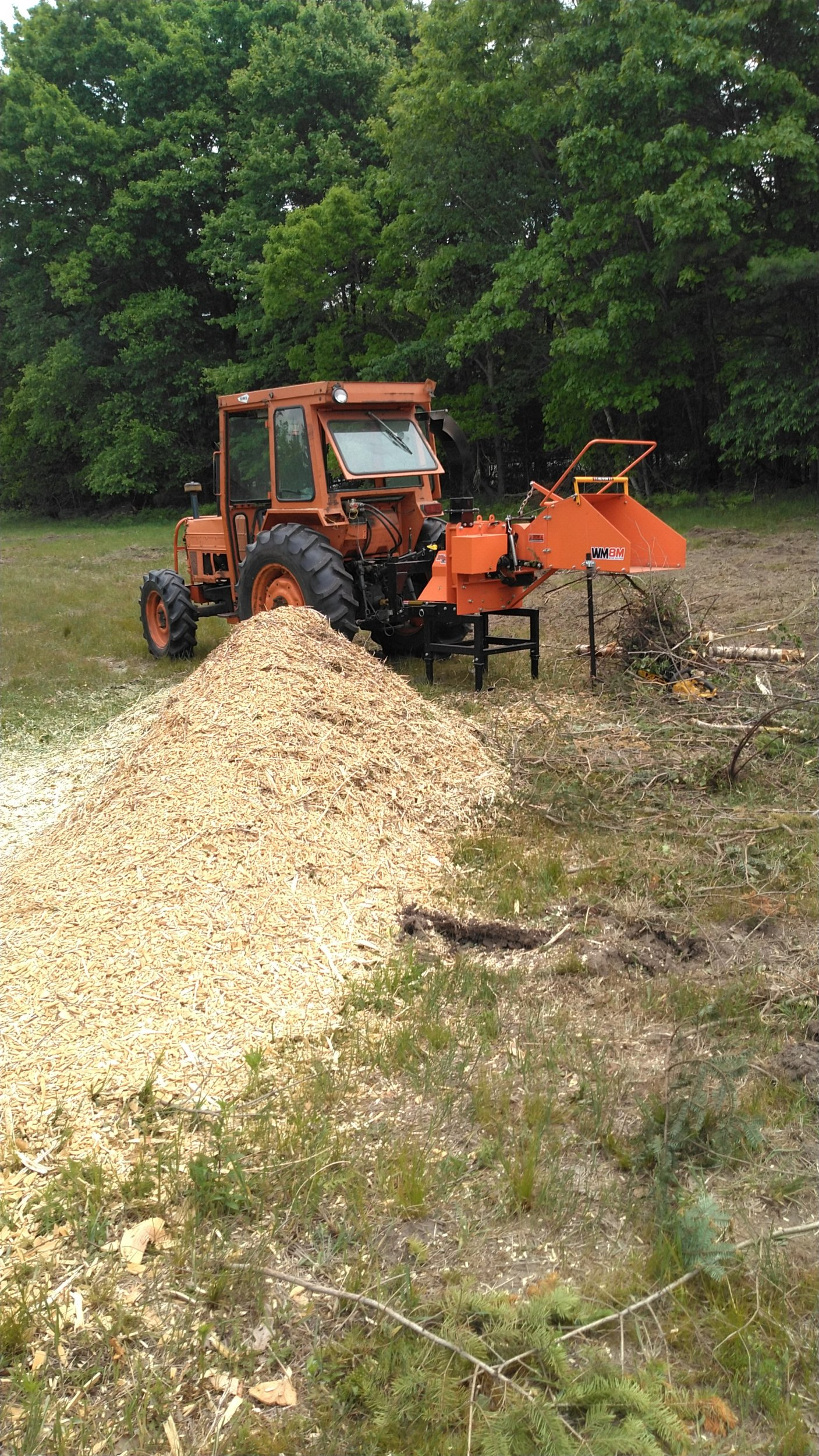

Sounds like a 3pt chipper might be handy imo you can spread the chips for ground cover to help mitigate erosion especially if you can't burn. It is a lot of hard work for a one man operation and I don't recommend running vines or stumps through it.
