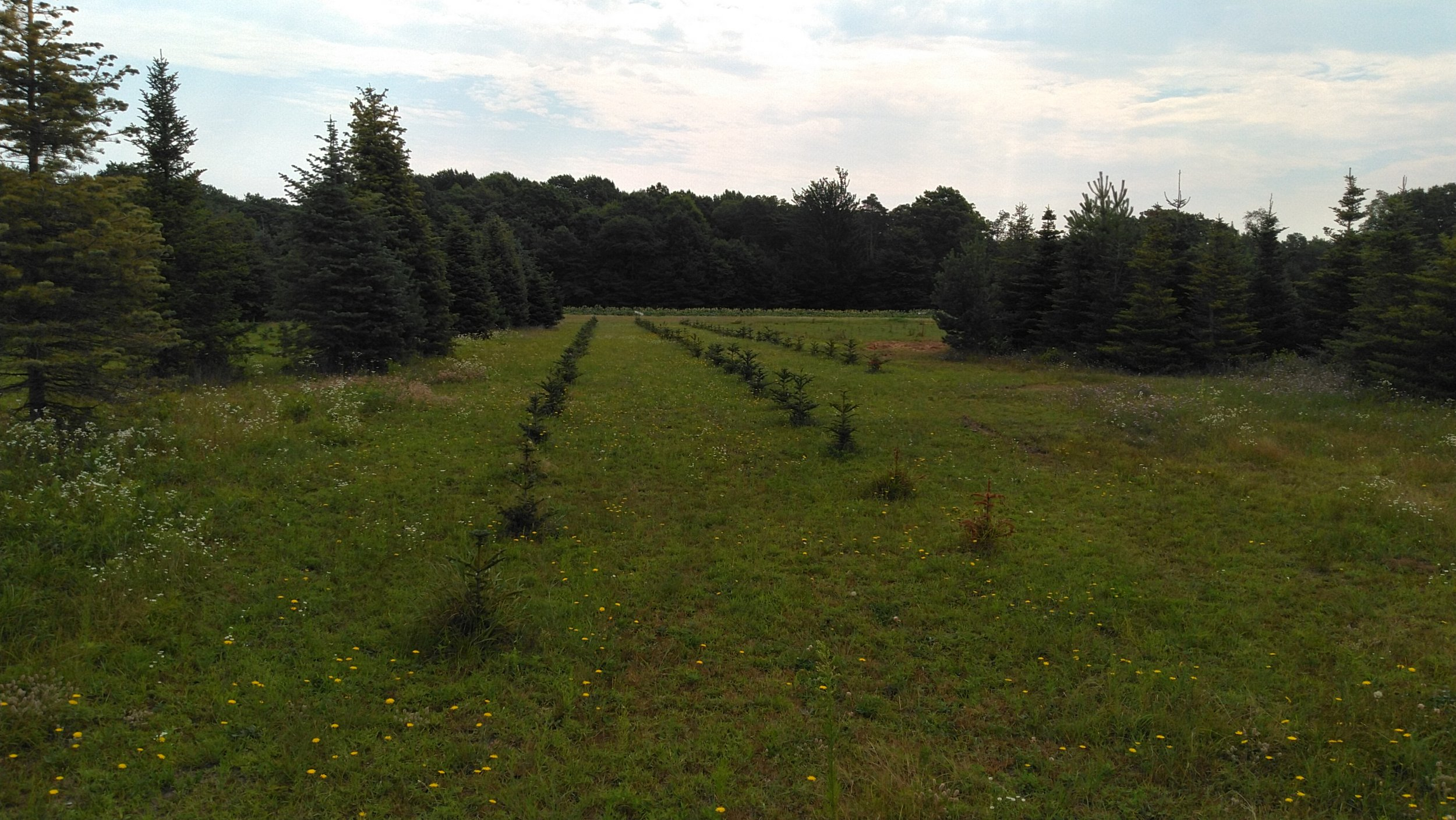

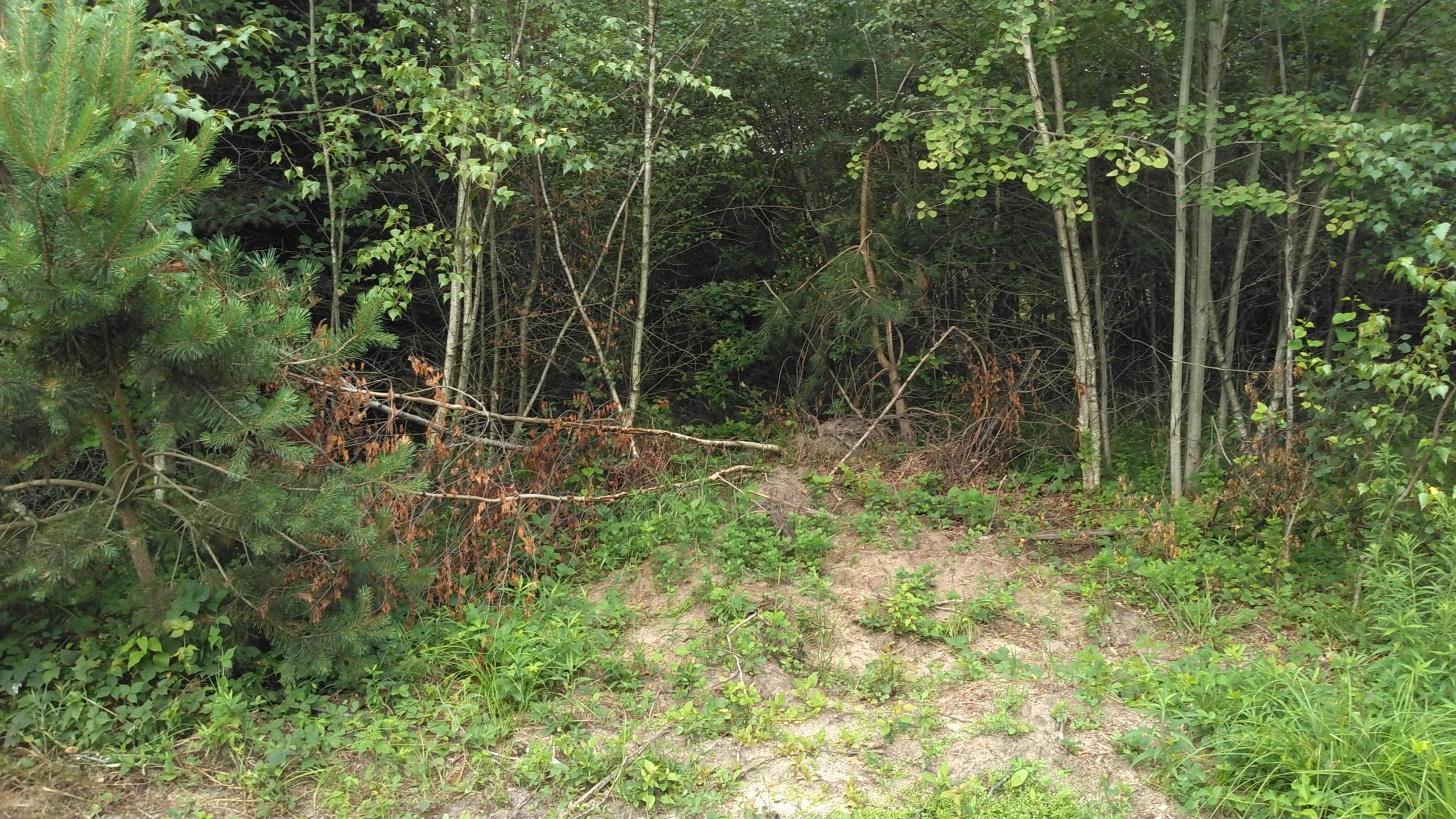

Personally I don't see how turning acres of 1st picture into acres of second picture and still being able to sell the skid steer at practically the price you purchased it for a waste of money?
OK, you get a kubota SLV75 for $65, 000 and with implements $79,000 OTD, and you use it for 90 days at most. Then you go to sell it, and you get $67,000. Anybody see a problem...?
   / What attachments should you use on a tractor to clear land. #100
Whoa, who said anything about a loaded ctl, mine was a low hr used open rops skid steer with minimal options for a fraction of a new ctl. I bought wheel spacers and tracks for it cause the sand was killing me. I bought a few U S manufactured attachments from a newer startup company for less of the cost what they will cost me now. If I lived in Florida I'd give you a hand if you wanted it, for a lot less than your quotes, or I'd sell you my entire setup, after a demo of course. Best of luck on your endeavors 👍
