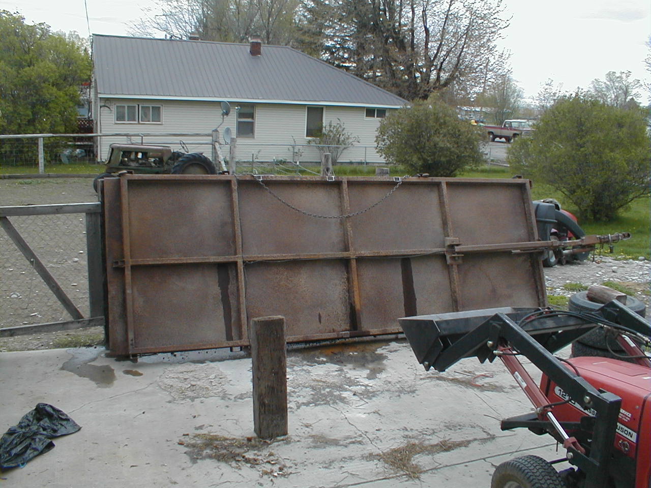

I stopped at the trailer place again to get fender backer plates, and I talked with the guy there about the axle placement. He convinced me to leave the axles where they are before I got Chris's reply. His logic makes sense... The tilt geometry is tricky, and if it was working before then don't change it. I also bought steel to make a new tongue.

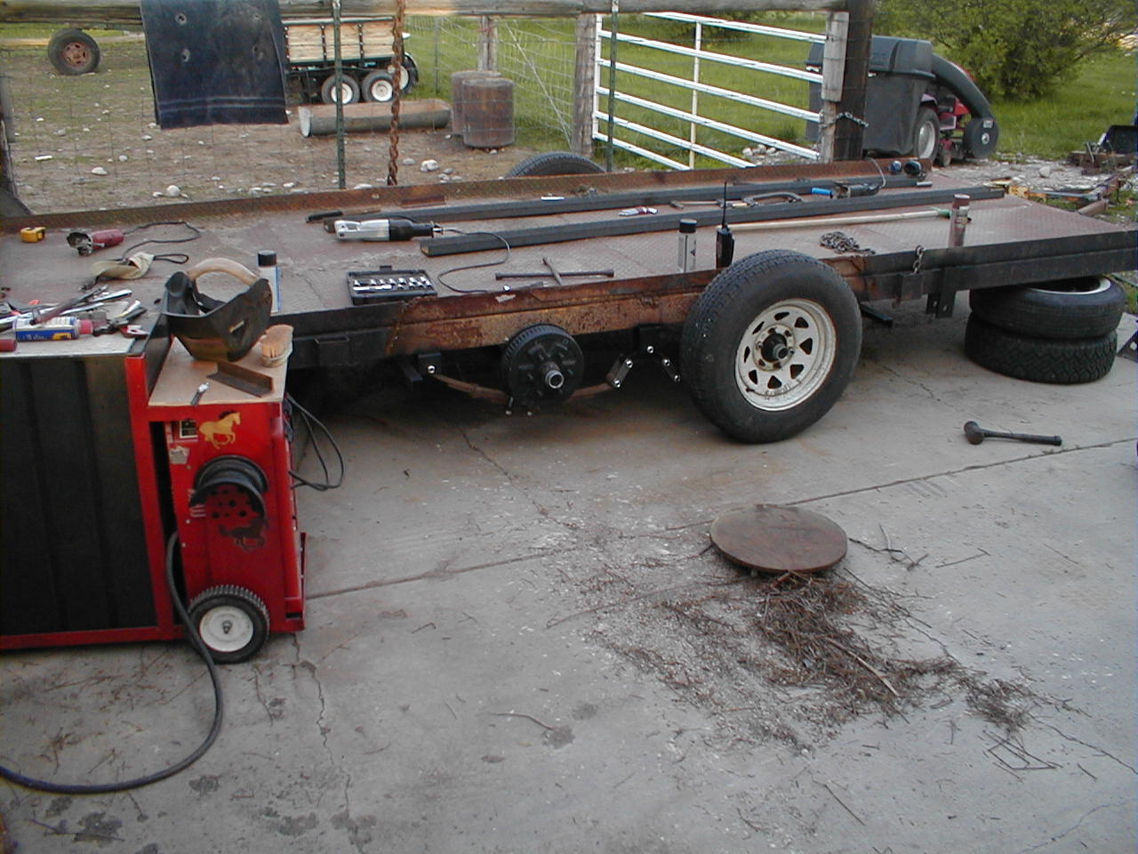

Here are a few pictures of today's work. I tipped the trailer on it's side to do the work. The second picture is about halfway through the day. Now I have the springs all hung, One set of fender mounts welded on, the fender backers tacked to the fenders, and the mounts for the new tongue installed.

I've been rained out all week until today. I envy those of you with nice shops to work in.
I have now accomplished what I originally set out to do at the beginning of this thread. I have added brakes to this trailer. Now I just have to put back together all the stuff I disassembled while I was at it... fenders, tongue, lights, etc.
Here are some notes of what I learned tonight.
Leave the U-bolts loose when hanging the springs. I originally tightened them up and I couldn't get the springs and hangers to line up. With the U-bolts loosened, everything went together fine.
The shackles that go from the springs to the equalizer need to be in the right orientation (up) when the axles are first hung. I let them hang down thinking they'd right themselves when weight was put on the tires, but that was not the case. The front ones popped into place, but I had to remove the rear ones and re-install them with them up.
My tilt angle is 10 degrees. My deck is 16 inches off the ground. That means the bottom of the trailer frame is 12 inches off the ground. That will be nice for loading and unloading, but I think I may have issues with clearance. I can get about another inch of clearance by using shorter shackles. I'm debating.
