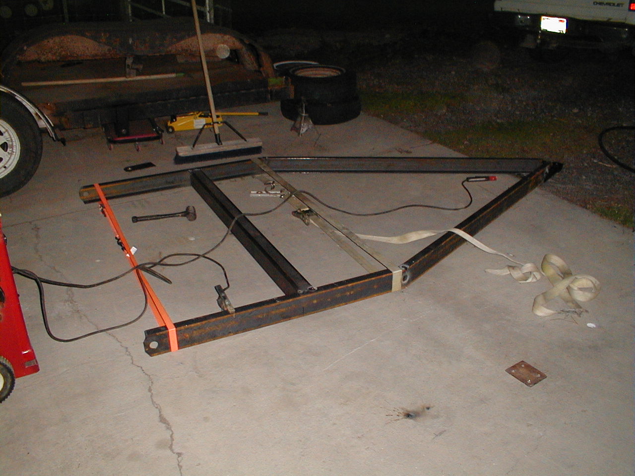

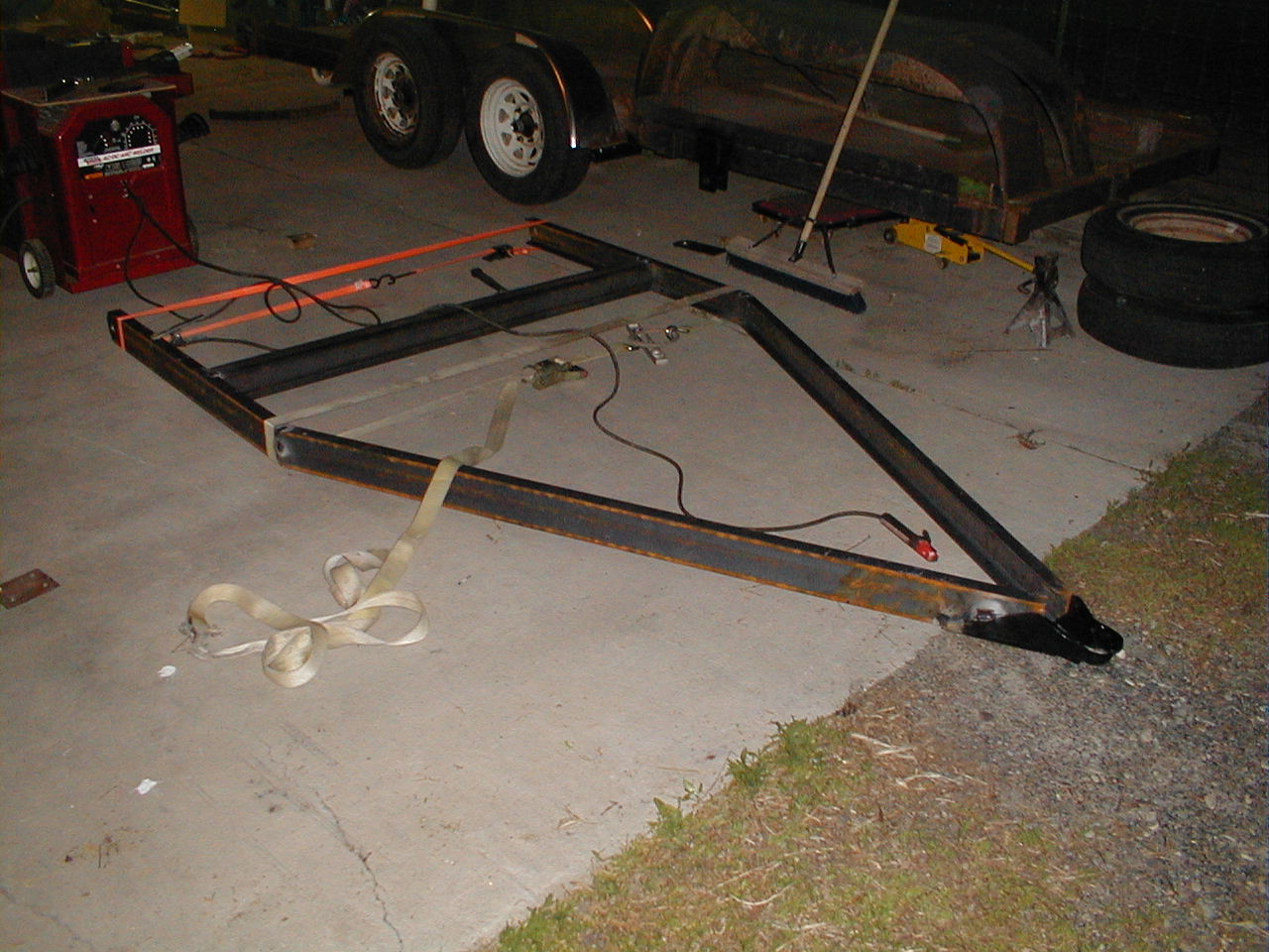

More progress.
This is the new tongue. It's just tack welded for now. I'm going to test fit it to the trailer, and then plate the seams and finish welding.
Sorry about the dark pictures. I was late last night.

No pics yet, but I test fitted the tongue to the trailer. All of the fretting and fussing to get the tongue square and even paid off. It fit up perfenctly! Now I get to take it back off and fish-plate the joints. I also need a latching machanism. I'm thinking about borrowing an idea from George2615...

#63
Another quick update. I got the seams in the tongue welded (everything was just tacked before). I also got the fish plates all cut out to plate the seams. I'm not going to rely on my amateur welding alone to hold this trailer together.
Next step... I need to grind the seam welds flush and then weld the fish plates in place. I also need to get some different steel to mount the fenders. With the extra drop in the axles and the new slightly larger tires, I'm going to have to mount the fenders a little higher. After that it's paint, wires, and I'm good to haul.

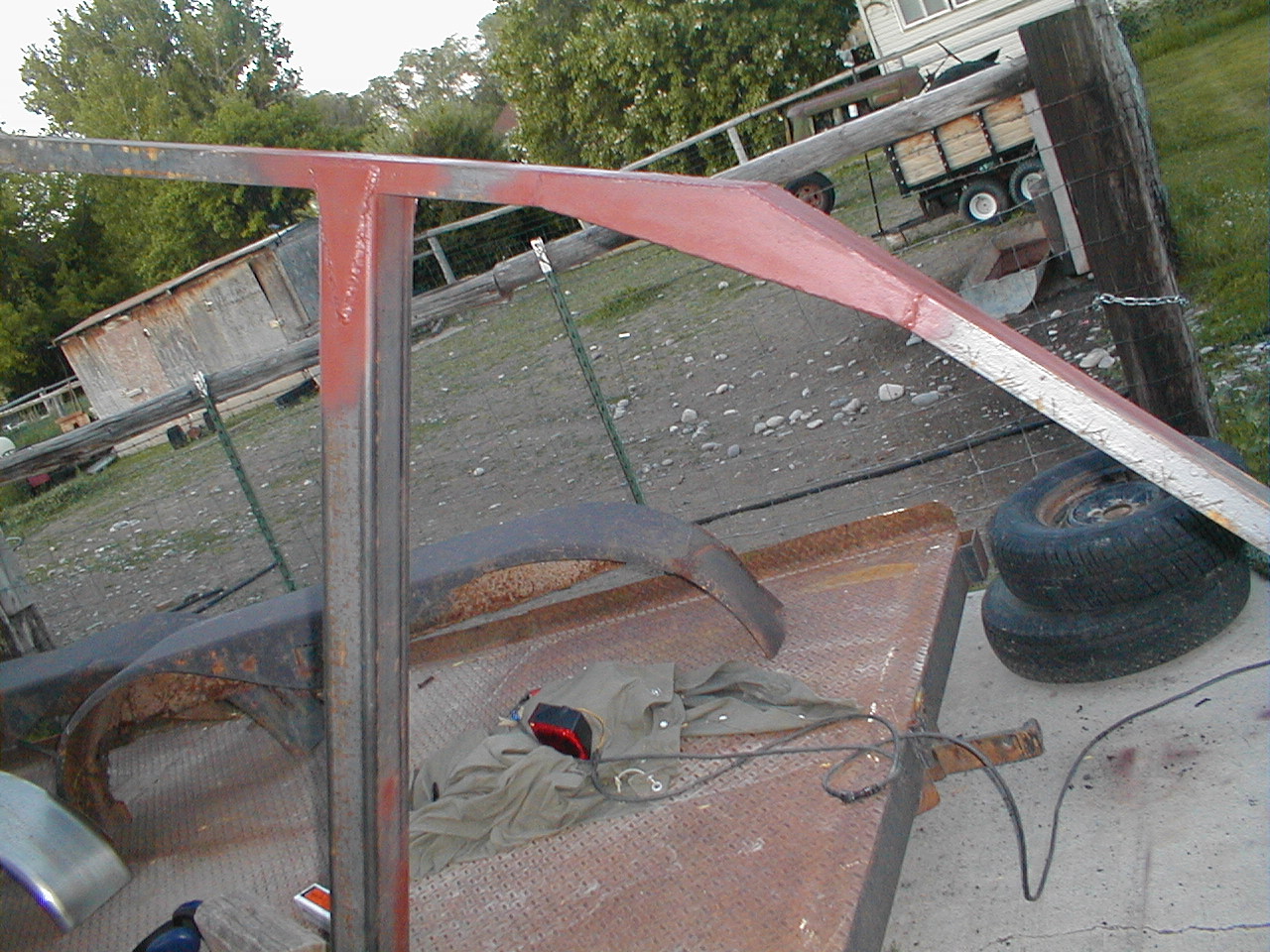

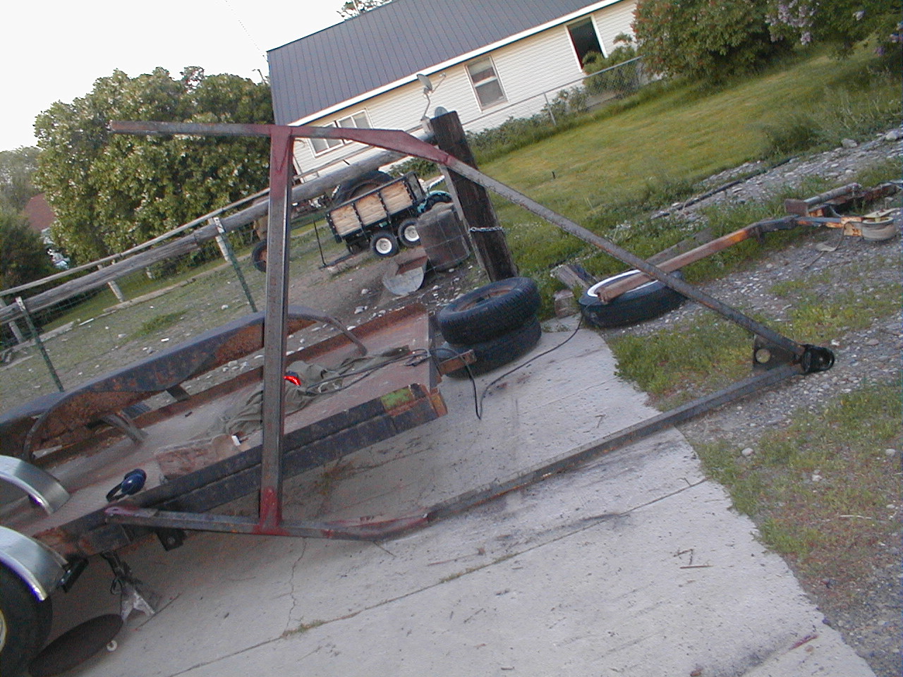

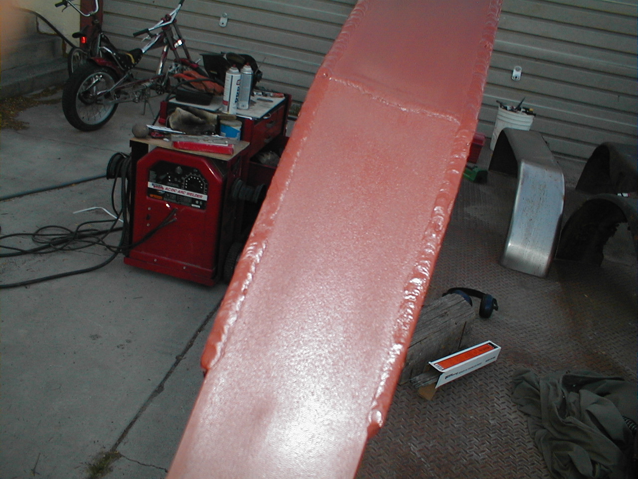

I stole a little time today and worked on the trailer some more.
I got the reinforcing plates all welded on. I think I did some of my best welds I've done in my life on these fish plates. I know, that's a sad comment about all of the other welds I've done.
I used 7014 rod and turned the welder up as far as it will go. You can see the welder in the background of the last picture. I'm including three pictures. One of the overall tongue, a close up of the fish plates, and an extreme closeup to show my welds that I am so happy with.
