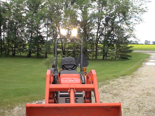

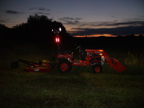

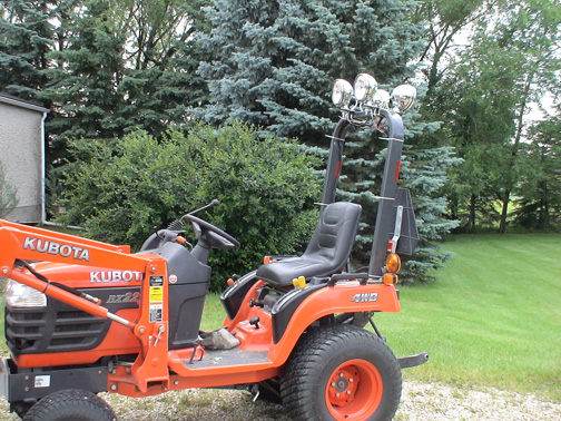

On my l3400 I have the foldable ROPS. There are two factory mounted nuts welded onto the lower portion of the ROPS. I checked the size and went to walleyworld and bought a set of BLazer 55 w halogen driving lights. using a standard switch i mounted them today and ran all of the wire in loom and it looks very professional. i also mounted another 55w light facing the rear on the fender. at night I dont plan on running the factory lights because they aint worth nothing with a fel. i can try and get pics later

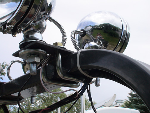

I have Peterson Manufacturing lights. I am going to use the Trapezoidal pointing forward and the floodlights to the rear. The link to these lights are Peterson Manufacturing Company
I have not had a chance to mount them yet. I bought some stake pockets from Tractor supply that will just nicely wrap around the ROPS. I had a couple of mild steel plated cut to go across the open end of the stake pocket and hold everything on. Here is a link to the stake pocket. Hopefully it will stop raining and I will get them mounted before winter. Tractor Supply Company - Truck Stake Pocket
Finally, I wanted a rugged waterproof switch to turn them on and off from the dashboard. I choose some Push-Pull switches from West Marine. West Marine: Switch - 2 Pos, Sealed Push-Pull Product Display
This style is almost impossible to break off like a toggle switch and easy to operate with gloves on. We used similar switches in the Arctic to turn on various lights and pumps.
