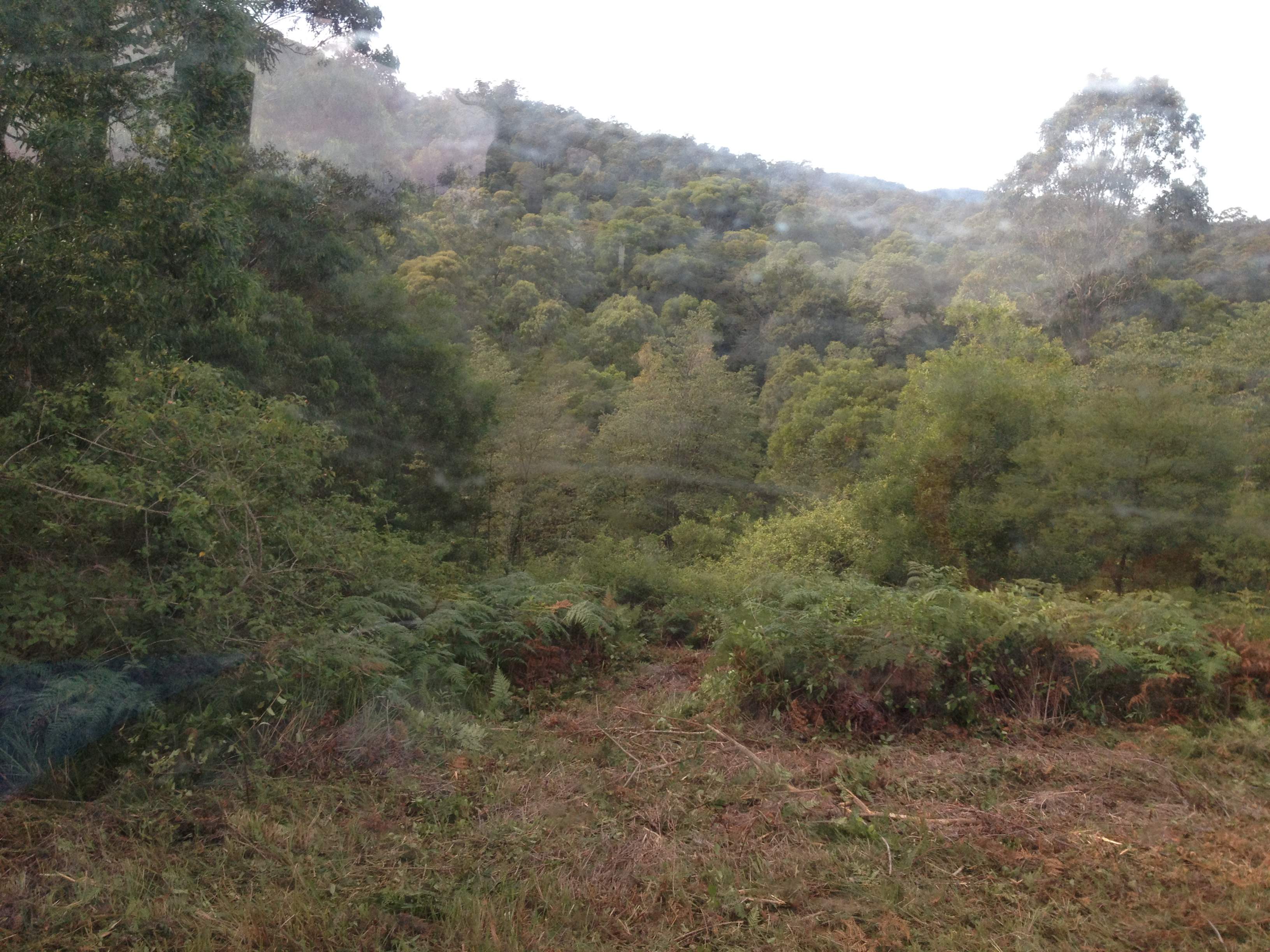

IMG_1071.jpgI have a TD 70 D and am trying to slash and clear ground that hasn't been touched in 15 years , so the bracken and Tobacco weed and all the other crap is taller than my tractor ! ( thank heavens for the enclosed cab! )
am I asking too much of the unit for this work ?? should I get someone with a dozer in to clear it all before I slash ?? ( its a pretty good slasher ! mind you )
I do scare myself when pushing through bush that totally coves the windscreen adn I have NO visibility forward.. but what the heck.. I Plow on anyway..

Naturally, this just my opinion, but as long as you don't exceed the cutting limits of your mower, and you keep the grill cleared off sufficiently (to avoid overheating), and you don't mind the tractor paint getting scratched up, then I think you are ok, providing you go slow. No visibility can raise the pucker factor some, but if it gets too bad, then you could always try mowing in reverse and let the mower knock everything down first. That would give you a little extra visibility. Normally you would like to walk the property first to check for hidden metal objects, hidden ditches/holes/stumps/etc, but it doesn't look possible in your case. That's some tall, thick brush you are dealing with!! Another picture with the tractor in place against the brush you are mowing would help give the audience a better perspective of just how tall it is. Good luck.

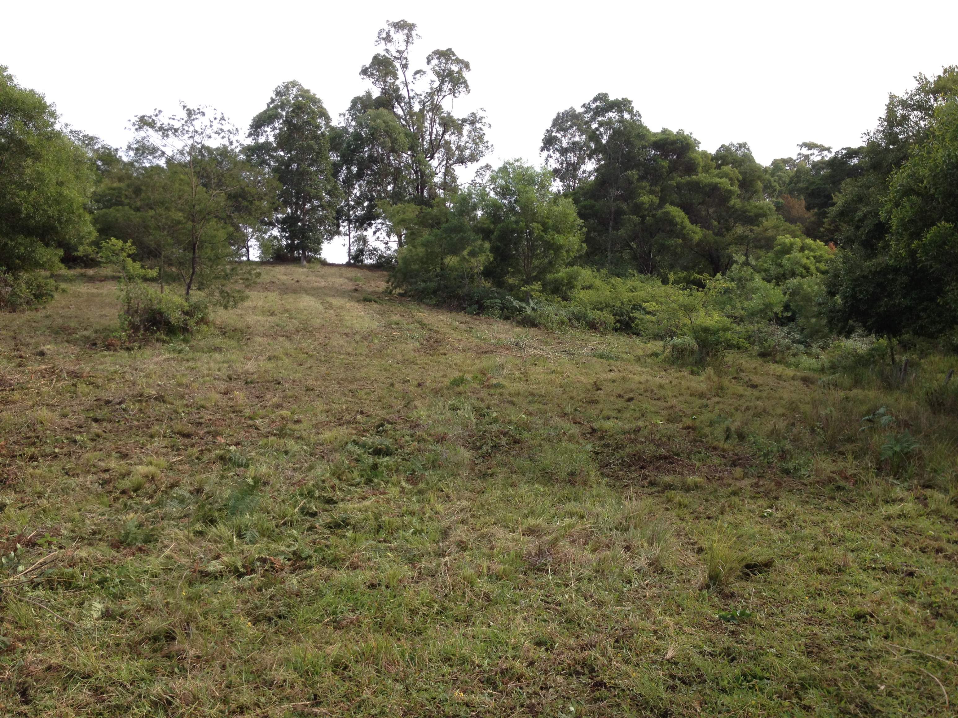

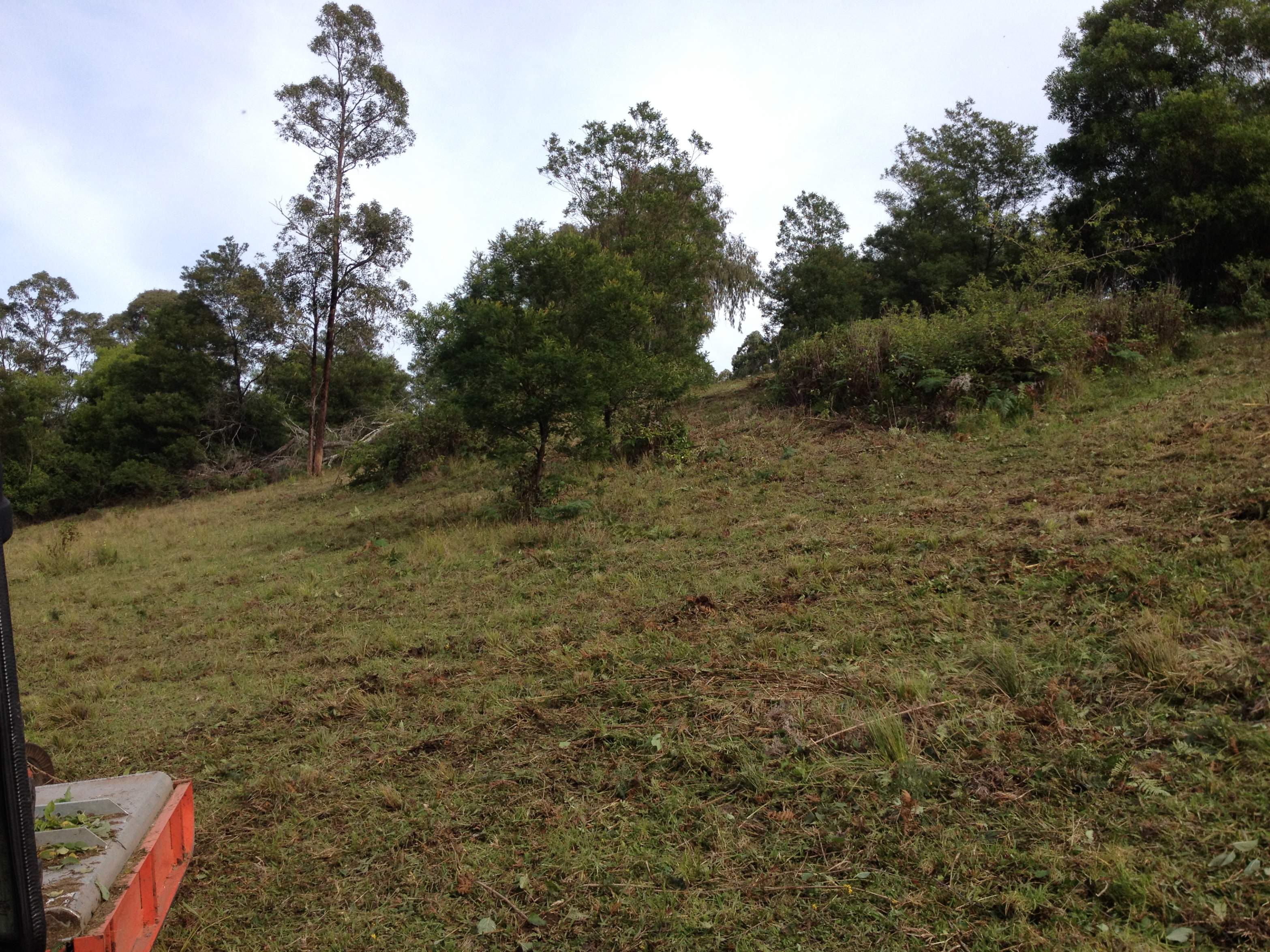

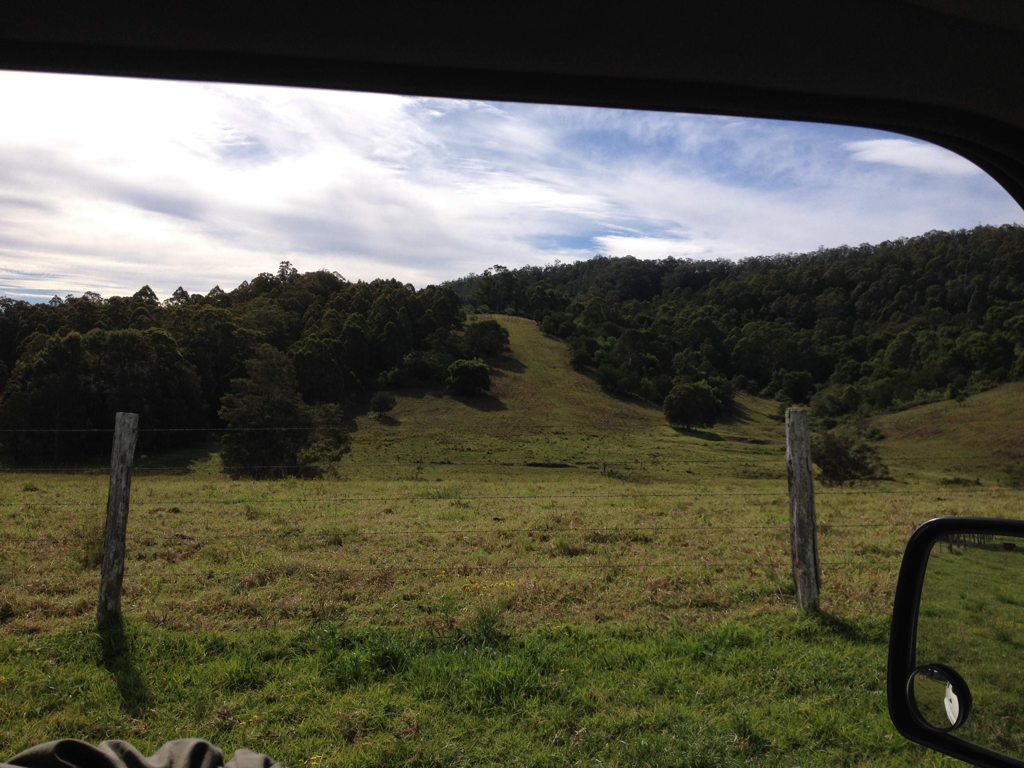

The shots I have added are the before and after shots of where I have been crashing through the brush..
I am going very slowly and trying very hard to IMG_1078.jpgavoid the nasty drops and big rocks!

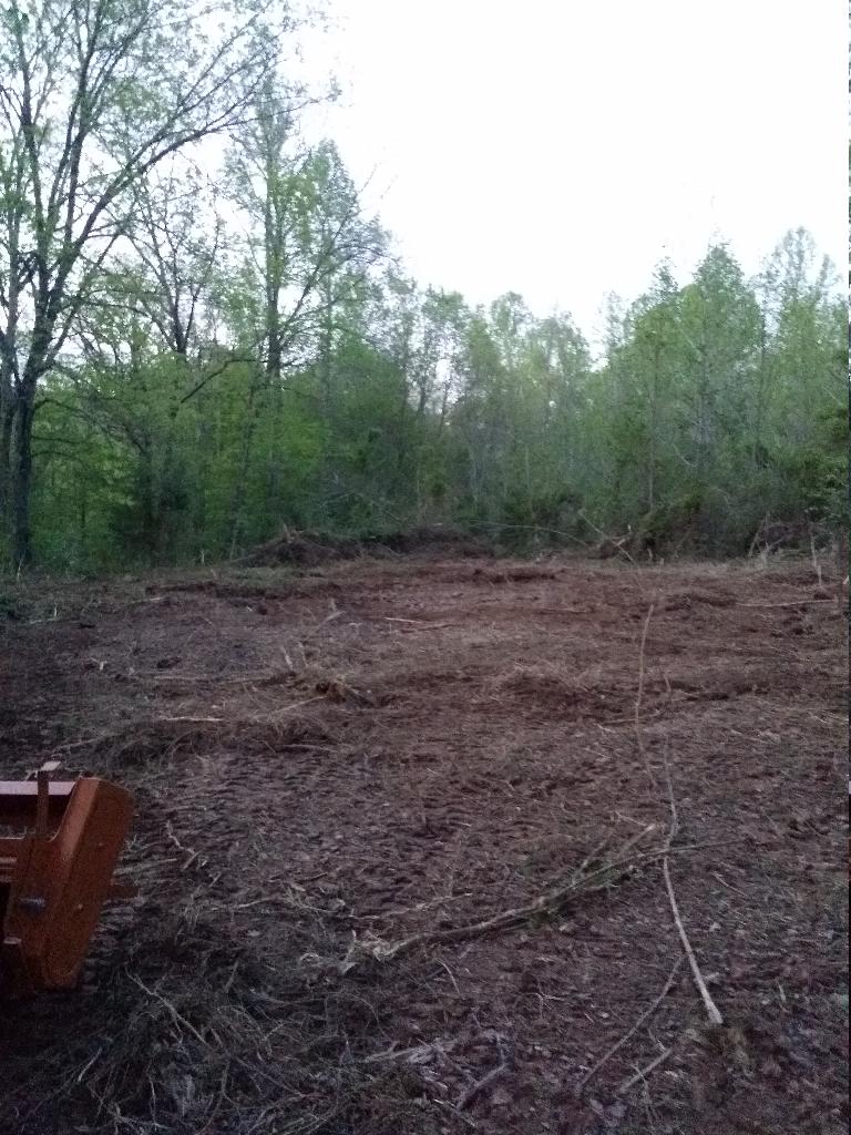

I have to park my XR3037 in front of what I'm tackling..... you have a pasture compared to this. Many of the pasture, field reclaiming pictures i've seen here are tame compared to mine. Maybe I'm taking too big a bite at mine and should get some heavy equipment. I'll get some picks in the morning. Here is the only one I have and it doesn't really display the scale. This goes back another 5 acres or so.... lol

Ours was pretty much like that and decided to save our equipment by renting the skid loader. We still used the tractors in some of the areas. We had thirty acres or more and some of it is going to need chainsaws.

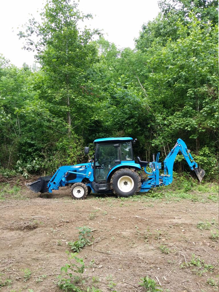

This should bring it into scale, I don't have extended periods to continuously work on it so renting isn't really an option. I have thought about hiring one of those mulcher crews that have the brush and tree chewing attachments for a bobcat. Then I would have to wade through it all and mark what I want to keep, I'm kind of deciding as I go...

I would take out all or nearly all of those sweet gum trees and any left, keep an eye out for sprouts. They are really invasive what with the sweet gum balls everywhere and the roots sprouting up runners everywhere. That thicket reminds me of my place when I got it. Sweetgum saplings so thick around my creek that you really couldn't walk in it what with them and the saw briars. I thinned them with bush hog and later got into the thicket with my TLB and opened it up so I could run my 7 foot BH between the trees. I only left a few of the larger ones and then only if they had sufficient distance between them to drive my LS P7010C.
Thorn trees are a pain also and if you don't get every root, they will continue to sent up sprouts for years to come.
