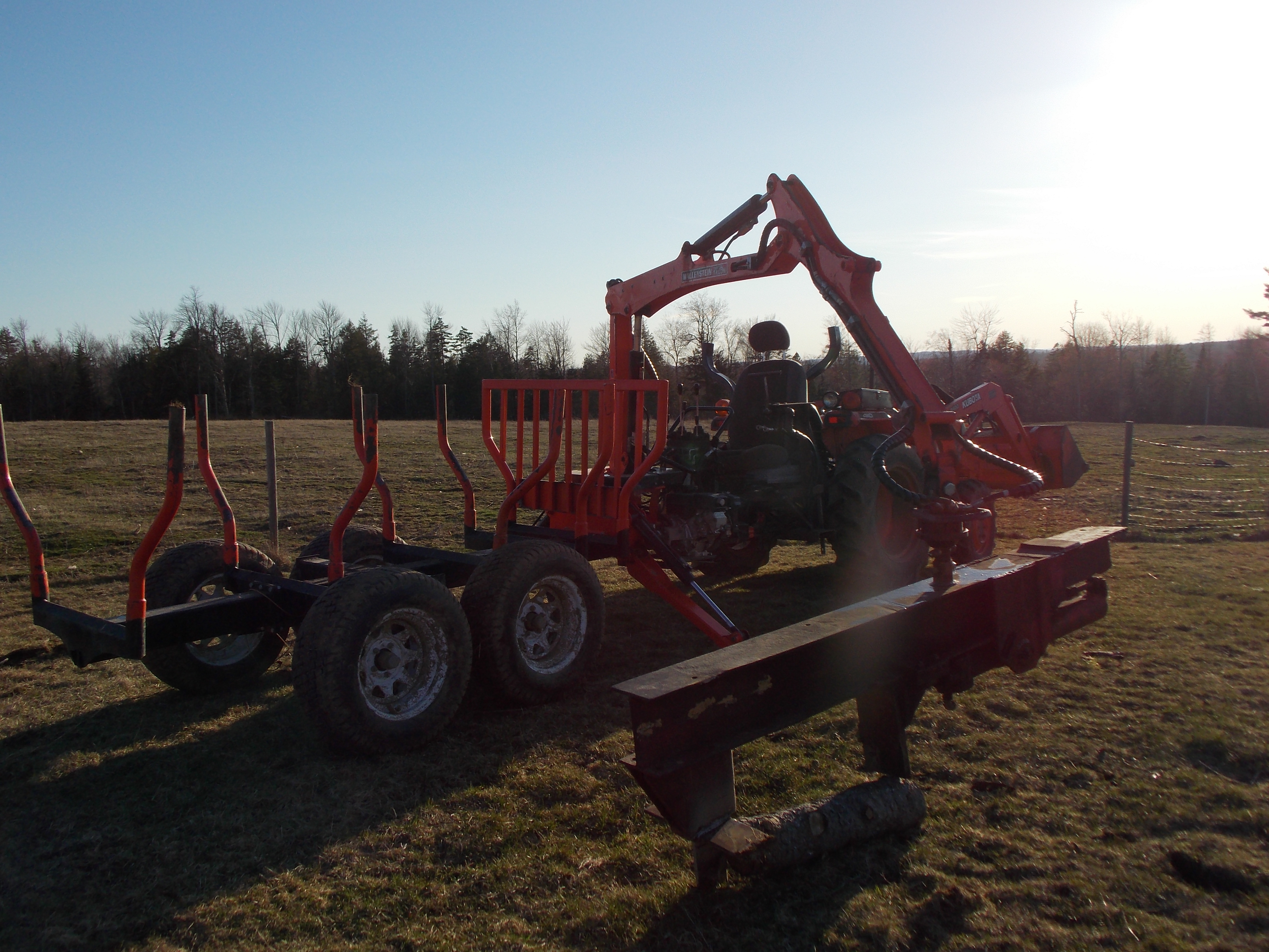

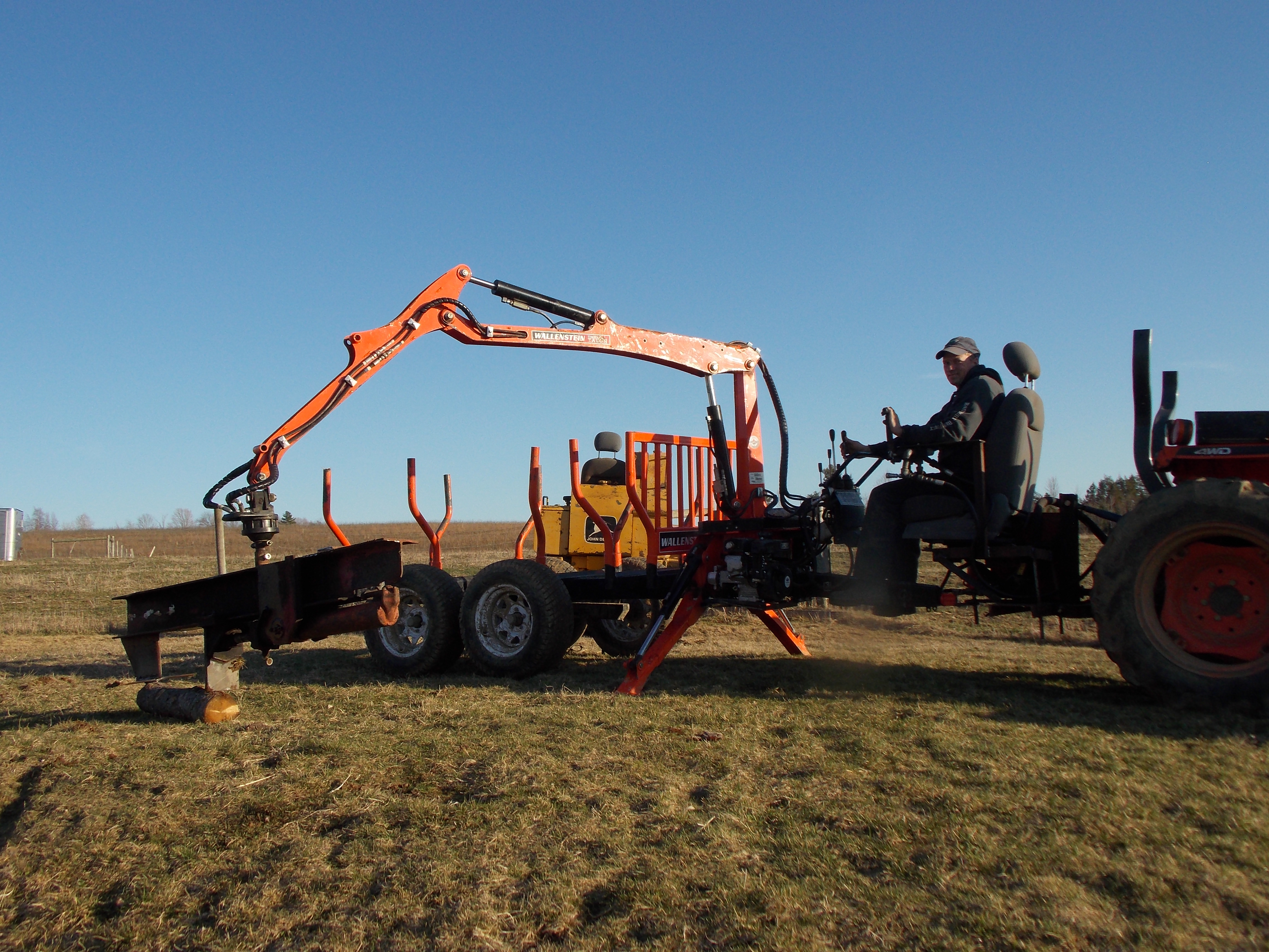

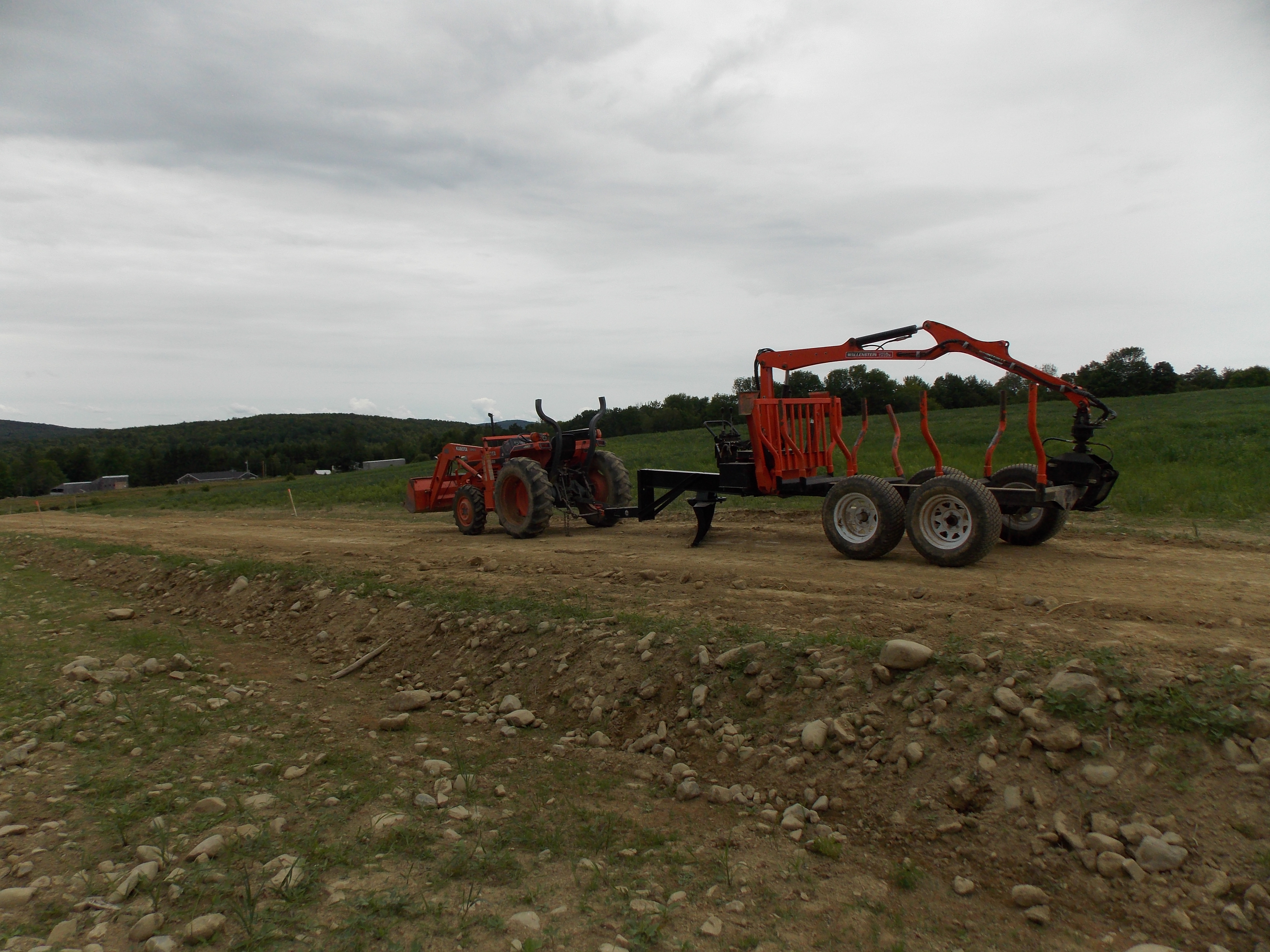

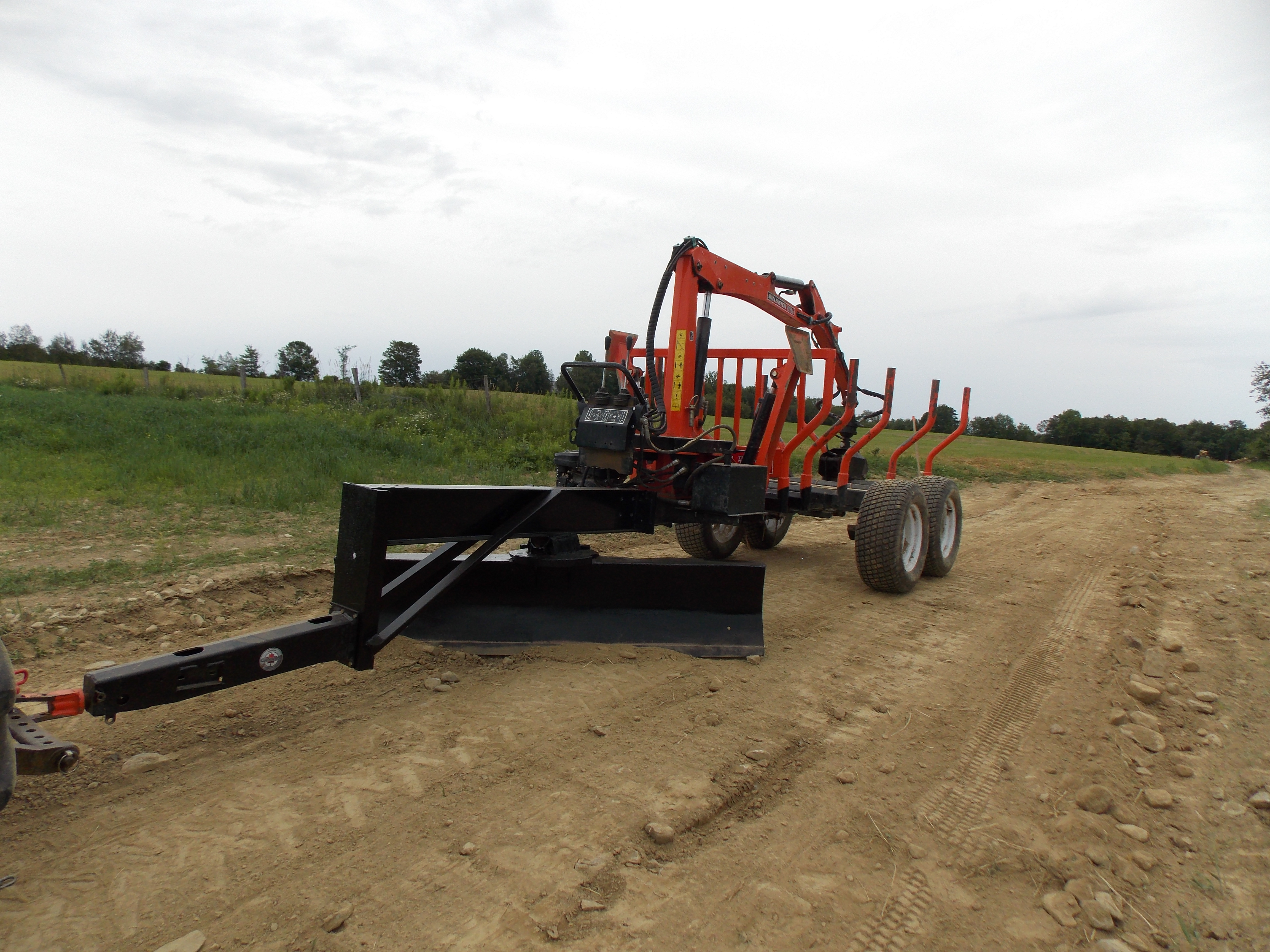

By the way, I have put far more on my log trailer then this. I added an upside down woodsplitter so I don't have to handle any firewood by hand, and added a grader blade. I am currently working on fabricating a feller-buncher head for it. They are pretty versatile.
Last year we got a grant to build a road across our property and needed 350 cubic yards to do it. We have a gravel pit, but a contractor wanted $7000 to move the dirt a half mile. Our trailer can only move 1 cubic yard at a time, but we deduced if we did 10 trips per day, in 35 days we could have the road done, and we did. That one job paid for the trailer.
I honestly cannot think of one thing a 2 wheel tractor cannot do towing this trailer. I just do not know why more people do not buy them???????????
Here are some photos of different homemade uses...

So I am confused.
I do not see any two wheeled tractors in those photos.
   / What can't two wheel tractors do? #15
So I am confused.
No, mine is too big for a two wheel tractor as it is sized for a farm tractor. But they do make them a size smaller and that would be ideal for a 2 wheel tractor with tracks. My point was how practical a log trailer could be behind one; albeit a size smaller.
I love 2 wheel tractors though and just bought my father one.
What I see is many people buying way too much tractor for their property. If a person only had 30 acres or so, they would end up with a really nice woodlot using a 2 wheel tractor with tracks, and an atv sized log trailer. Not only would they spend about the same money as buying a 4 wheel tractor, they would have a lot more capable machine from doing so. Having the ability to lift and load almost anything makes it far more versatile then a front end loader. But the greatest thing is, they would have nothing but walking paths through his forest in getting out their firewood, and doing other jobs around the homestead. This is the work-around regarding their inability to lift.

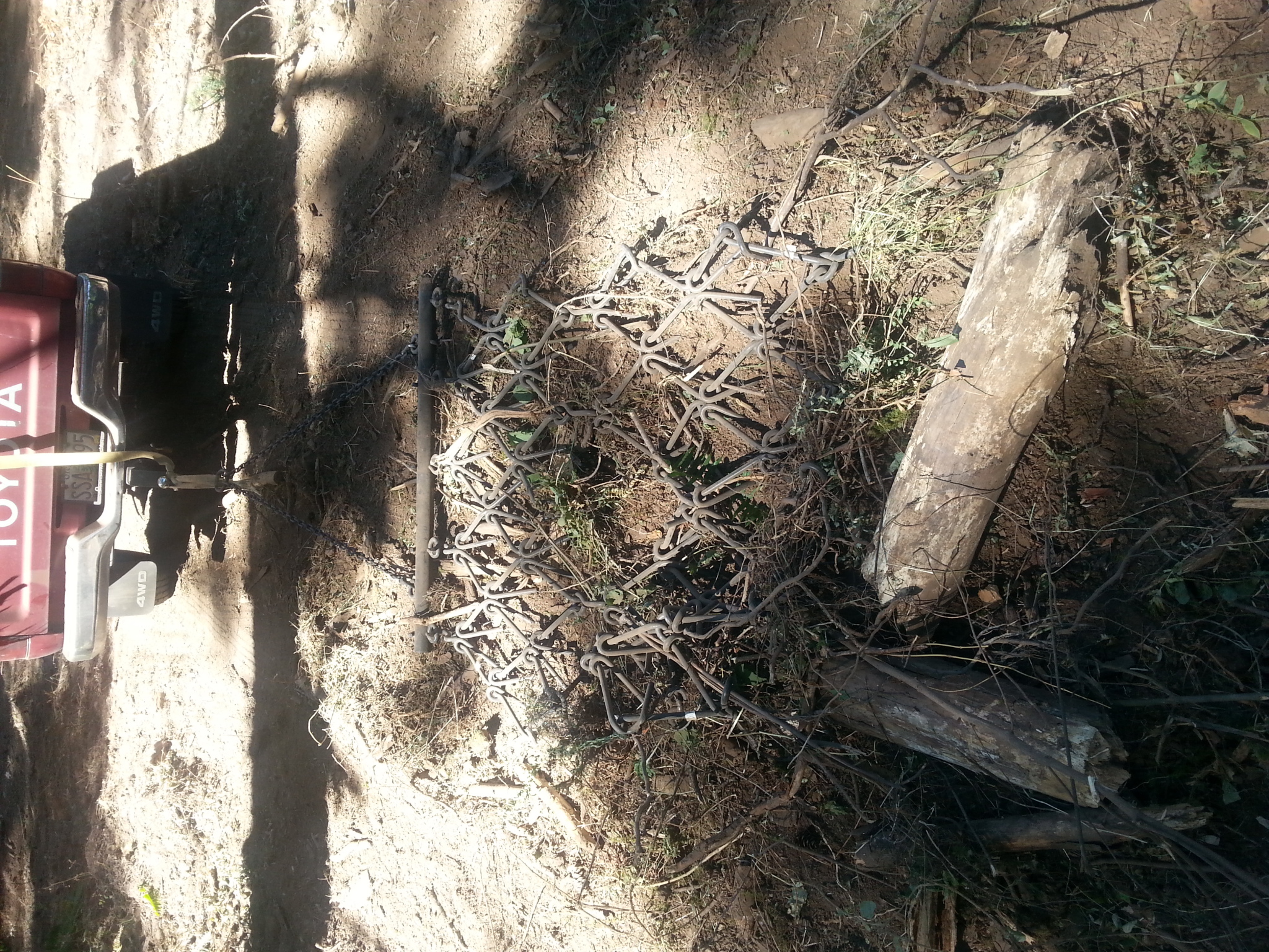

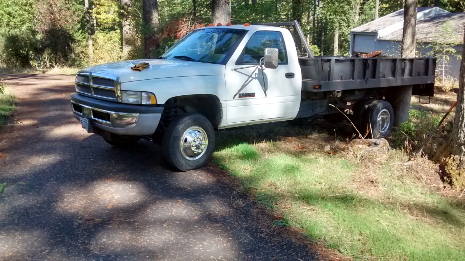

I have a little under 20 acres of forest.
If I need to haul wood or logs, I use one of my 4x4 trucks (small Toyota and large Dodge with 8x12 flatbed).
I use my Grillo for mowing and brush cutting. It will not pull anything of any significant weight, including logs - I use the trucks for that (usually the big truck as the small truck will just sit there and spin it tires on large logs or logs in a pile). I had to use the small truck to pull a drag harrow to smooth out some ground because the Grillo would not pull it - just spin its tires.
This is why I say a 2 wheel tractor will have problems with pulling weight - probably even with a trailer - there just isn't enough traction there. Even my small truck has problems with some logs (granted, skidding them instead pulling a trailer).
