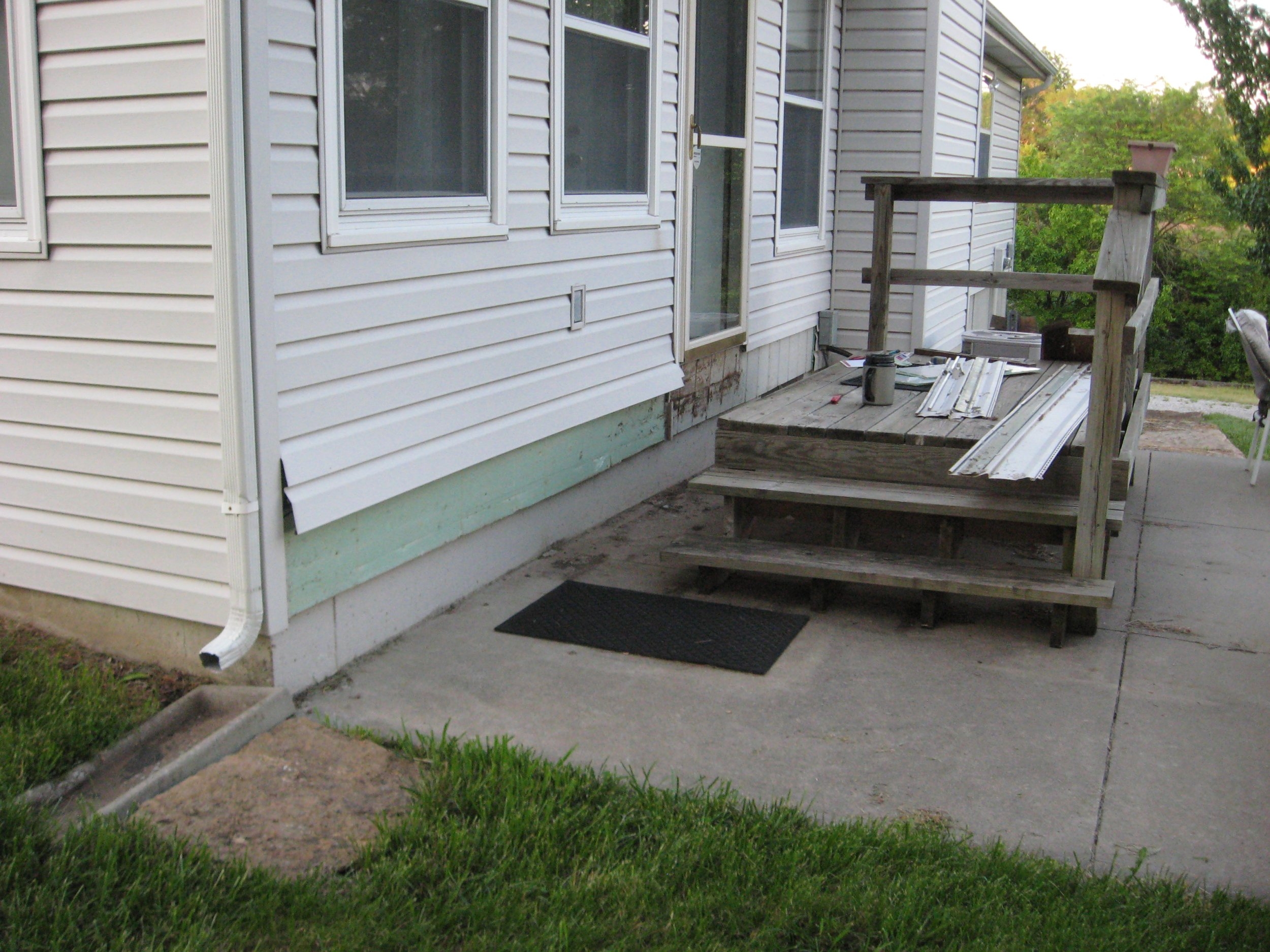

I am re-using one of the old stairs at the back door until I have a chance to build the new landing/stairway.
   / What Caused This Wood Deck Failure? #42
Not sure of your budget, but have you considered raising that to the door level to eliminate the steps? Block wall, or maybe a poured foundation wall, then fine crushed stone to fill it to level. Then your pavers/patio stones on top. Slight slope away from the house for drainage.
But if I'm seeing an exposed stud wall, that may not work.
I like the way you are thinking, but honestly, it's just not worth it to me. It's not like we want to do a lot of entertaining out there. However, nextdoor neighbors house was built very much as you describe, except the raised rear patio is actually a concrete slab supported by foundation walls atached to the house. If I were building this type of house new, that is what I would do.
#46
Cover your ledger board with white trim metal. Jon
Good thought. My intention is to cut and remove the ledger everywhere but where needed for the new stairway, then fix the siding. I have some spare pieces of siding, but haven't looked at the stash yet to see if there is enough to do the job.
Just in case, I have been investigating and found that the original siding was made by a company called Alside, which is apparently still in buisness and still sells the same pattern and color. Problem is, I can't find a distributor. The siding is identified in their literature as "Odyssey Plus Premium Vinyl Siding - Double 5" Dutch Lap in Platinum Gray".
I only need to install 4 pieces to do the fix, but have to be able to buy it first. Would hate to have to hire a siding company just to do this.

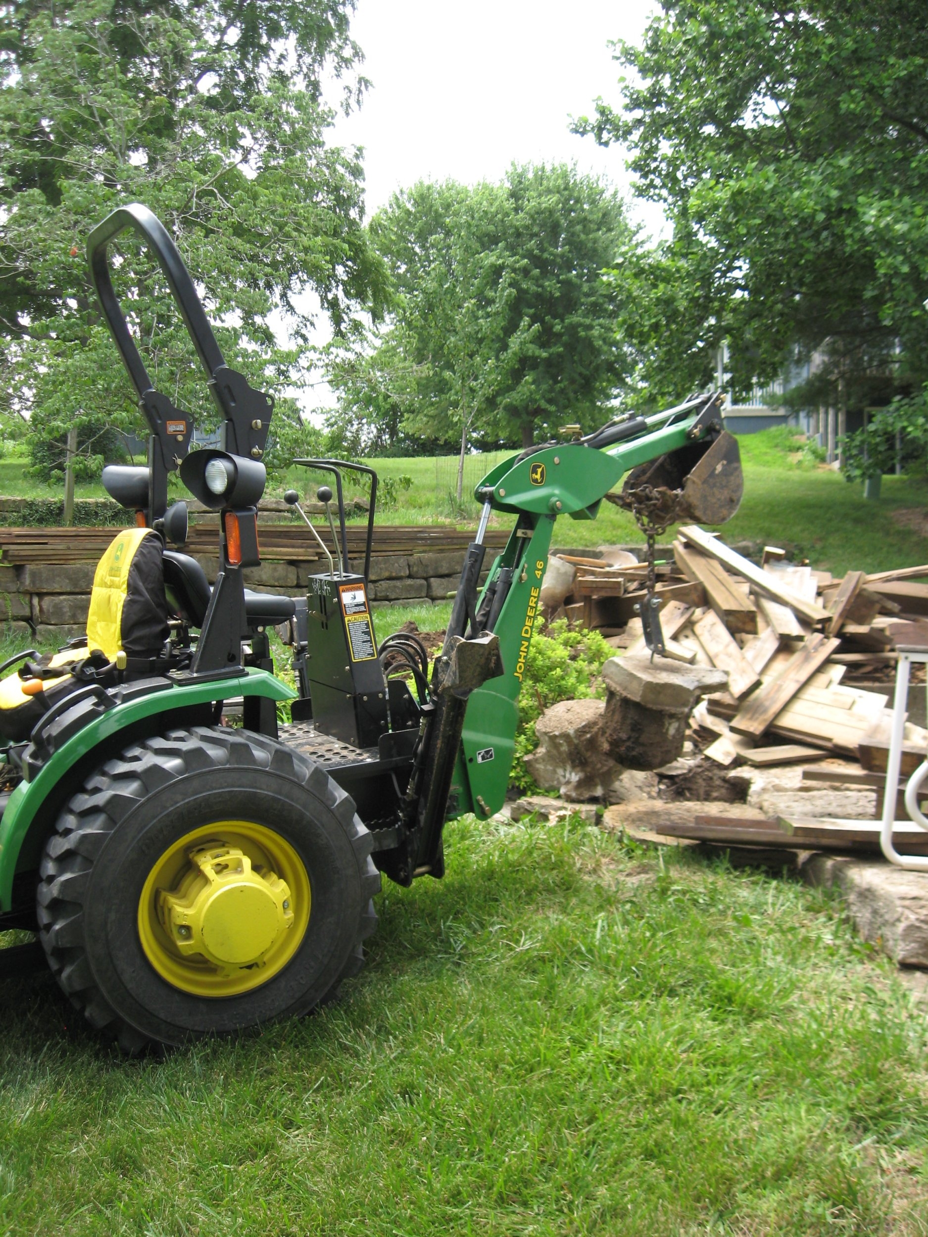

Broke out the 2520 with backhoe yesterday and removed the main beam and 4 concrete piers, plus the two chunks of concrete installed to anchor the bigger stair.
This completes the demolition process (except for removing the ledger board). Now need to get a dumpster out here. Sticking point for me is dumpster companies don't allow concrete in anything bigger than a 20 yard dumpster, so I'm going to try to make it all fit in one of those.
Can't wait to get this garbage out of here...
